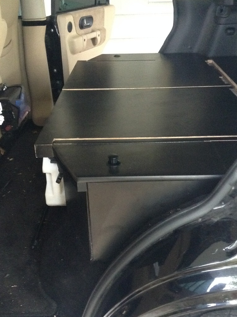

The front section of the platform is just about finished. I still need to add another section to the very front to extend about another 14" forward. I'm considering making two fold out sections to act as headrest, and to make the platform 74" in total length.
Looking from the rear forward. The back section has two large drawers that'll house all of our cooking supplies, and other things.
Side shot of the front section. I'm thinking of adding some black edge trim to the exposed plywood. Just not sure if I want to be able to see the unfinished wood or not, But maybe I'm just being OCD since it's never going to be seen once the custom bed is in there.
There are two small side compartments that are going to be used to store personal items, and things that we'll need to have close by. Even have a his, and her side. Which, will most likely end up as her, and her sides.
