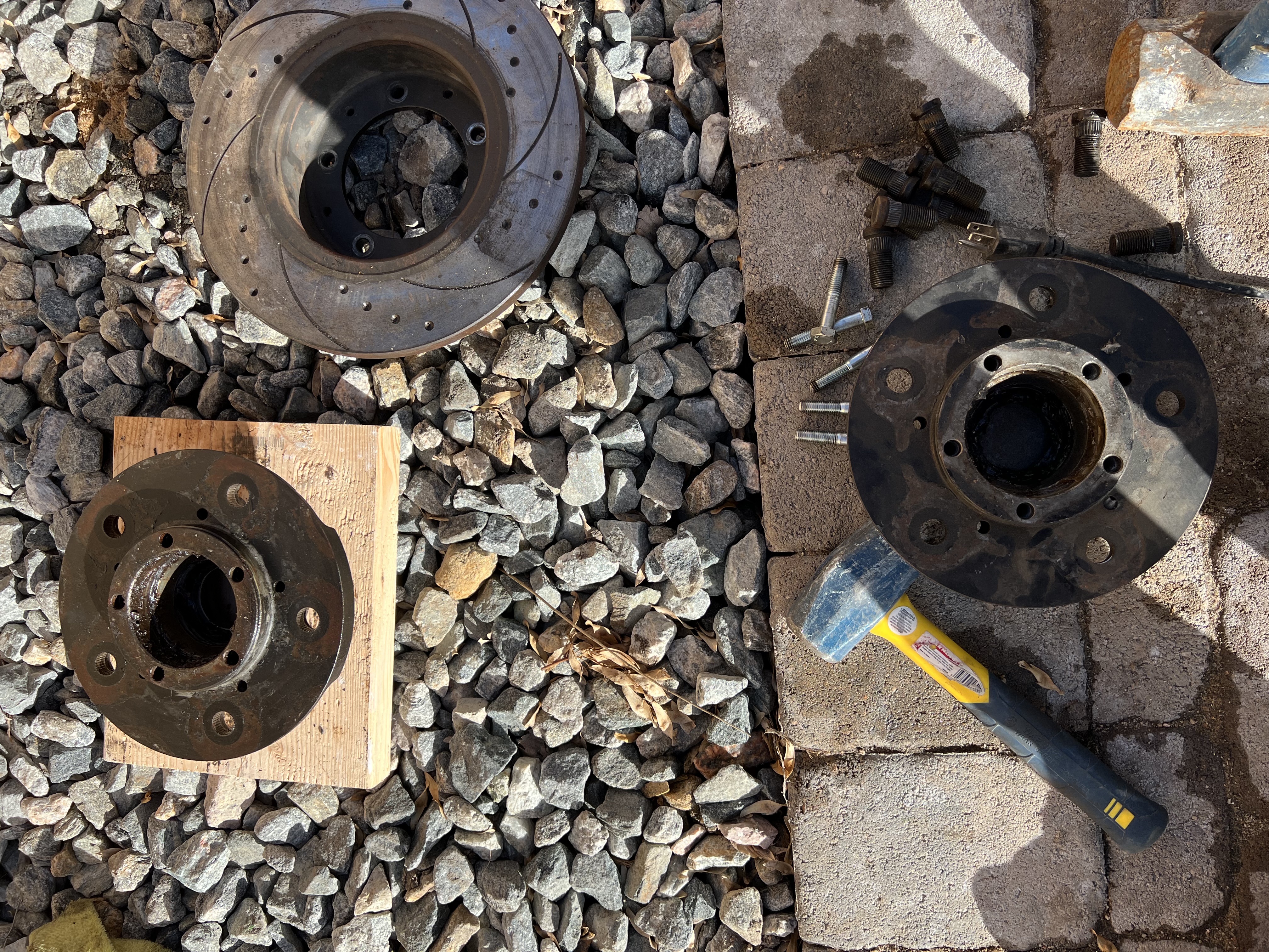

The methods are going to look right at home. Will need extended studs to mount them however. Very frustrating that the extended 60mm studs that are “required” for wolf or military wheels are not available on ready to buy hubs. So if anyone has any hubs with extended studs available to sell I’m very interested for the sake of saving time vs swapping out 20 wheel studs…

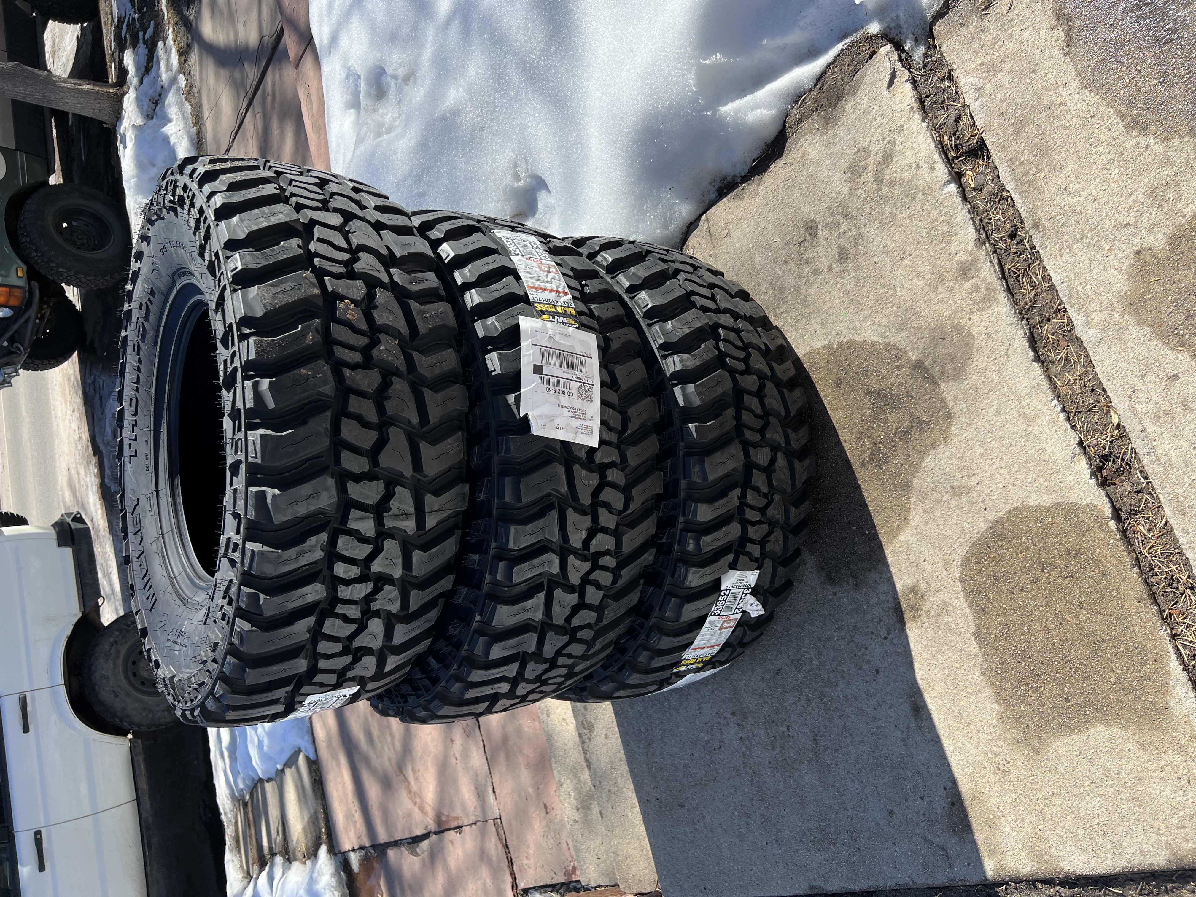

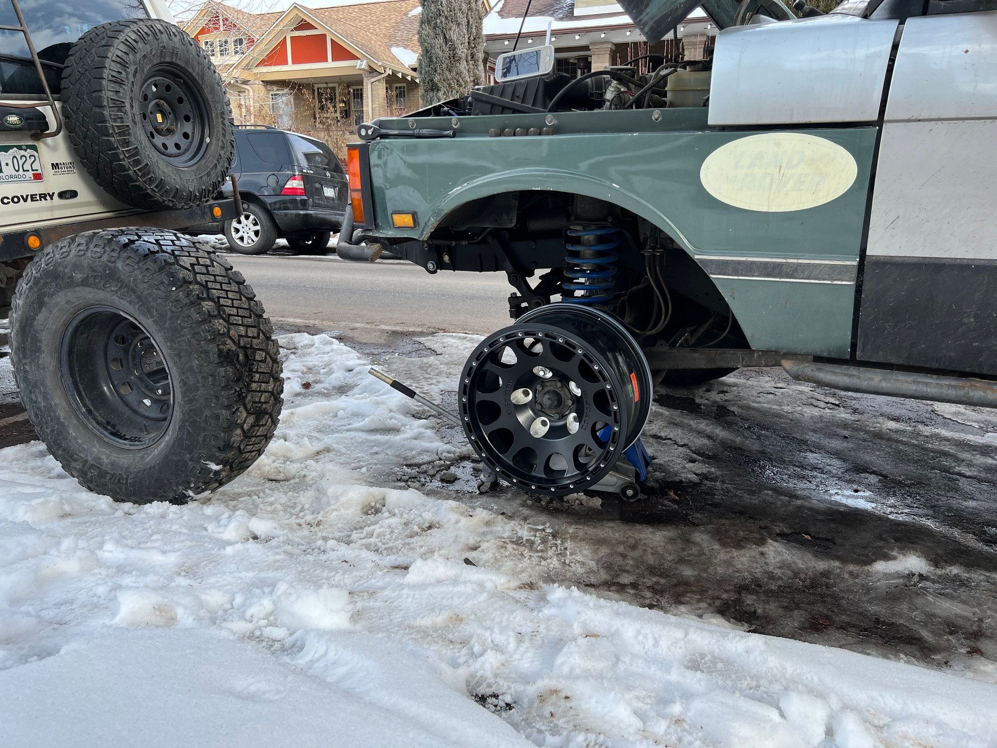

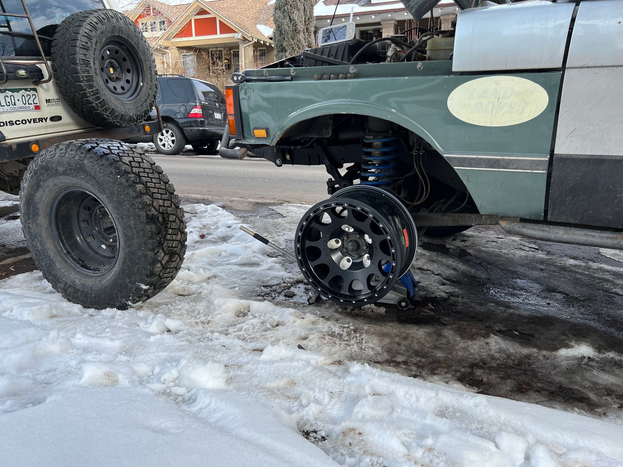

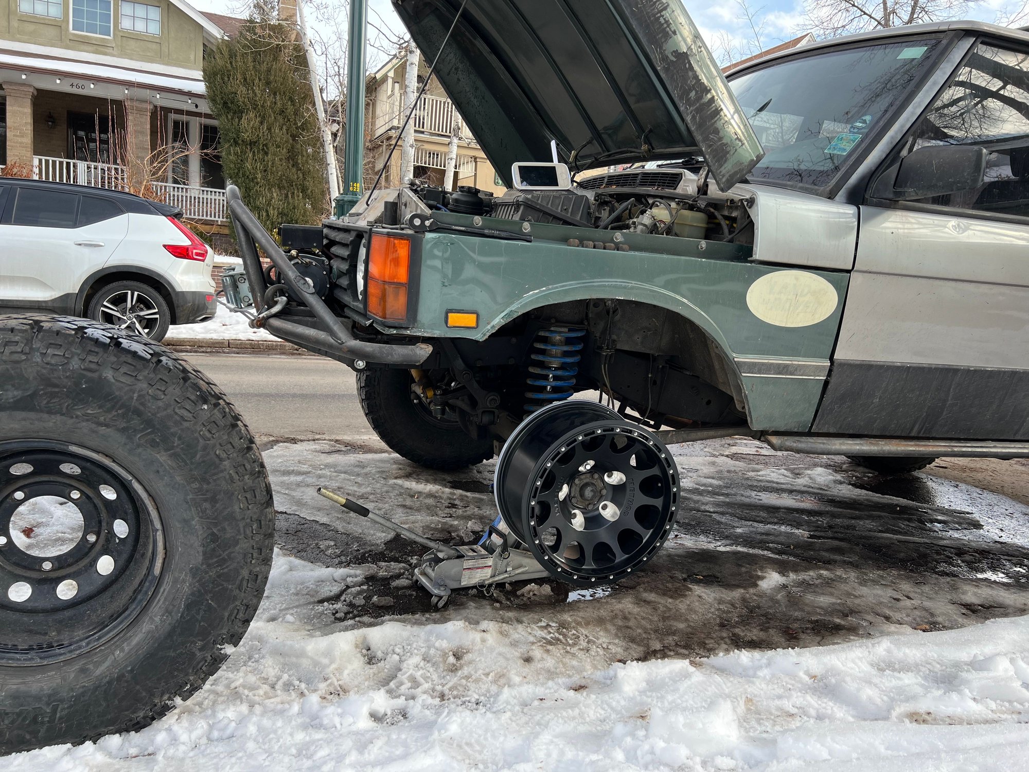

Made some major progress today. 3 of the 4 tires showed up. No clue what happened to the 4th but it has its own UPS label so hoping it turns up sooner than later lol. Finished re-wiring the O2 sensor connectors that were destroyed when the cats were stolen. Got one tire mounted up!! Knocked out the stock wheel studs on the hubs and will fit extended studs tomorrow! Rolling along with a deadline of the 15th quickly approaching.
