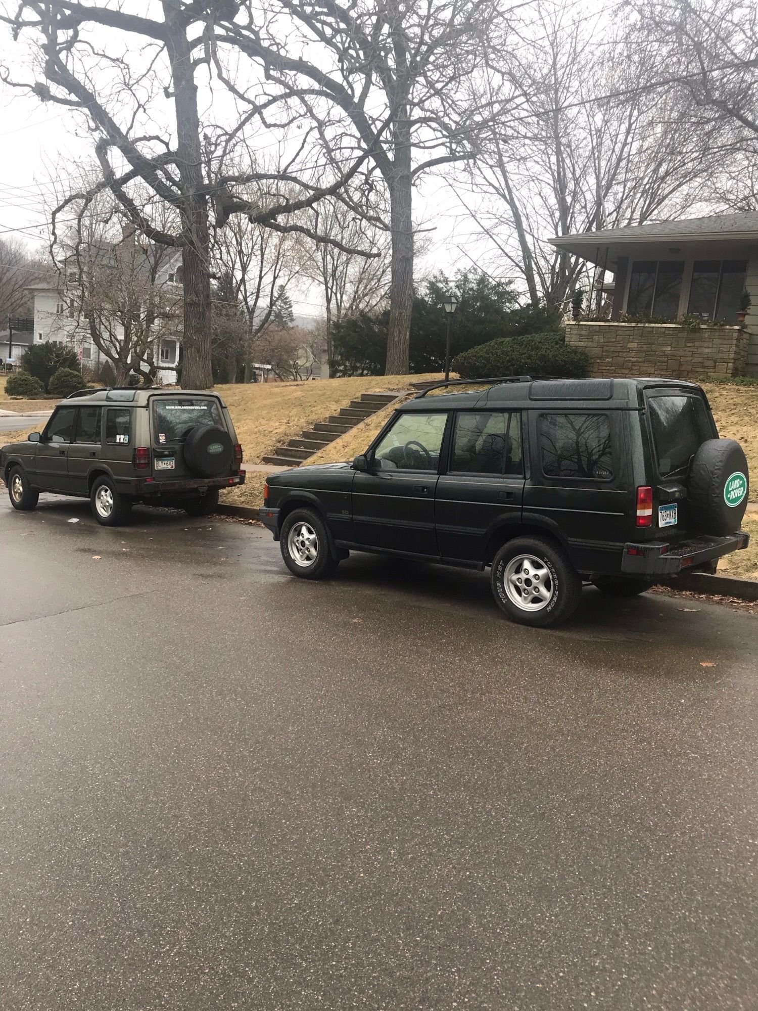

The fleet
Time to take it for a road trip test
As promised, a few pics of the new toy. Going to give it some road miles today and see how it does (and yes, it just started raining)
First pic shows my 97 in front, and the 99 behind it. 97 has just shy of 200K and lots of rust underneath. Hard to justify more work with all that rust adding problems.
