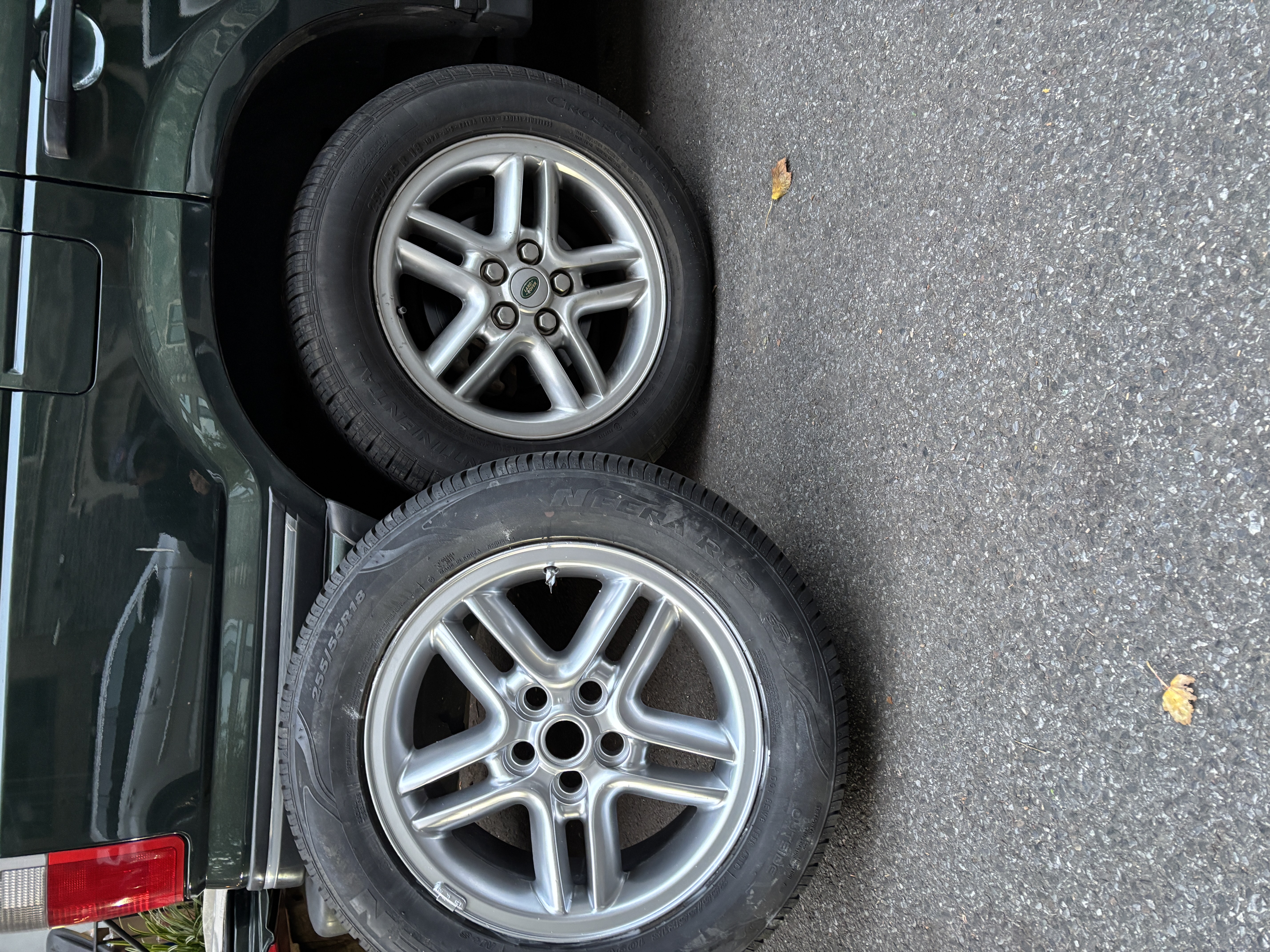

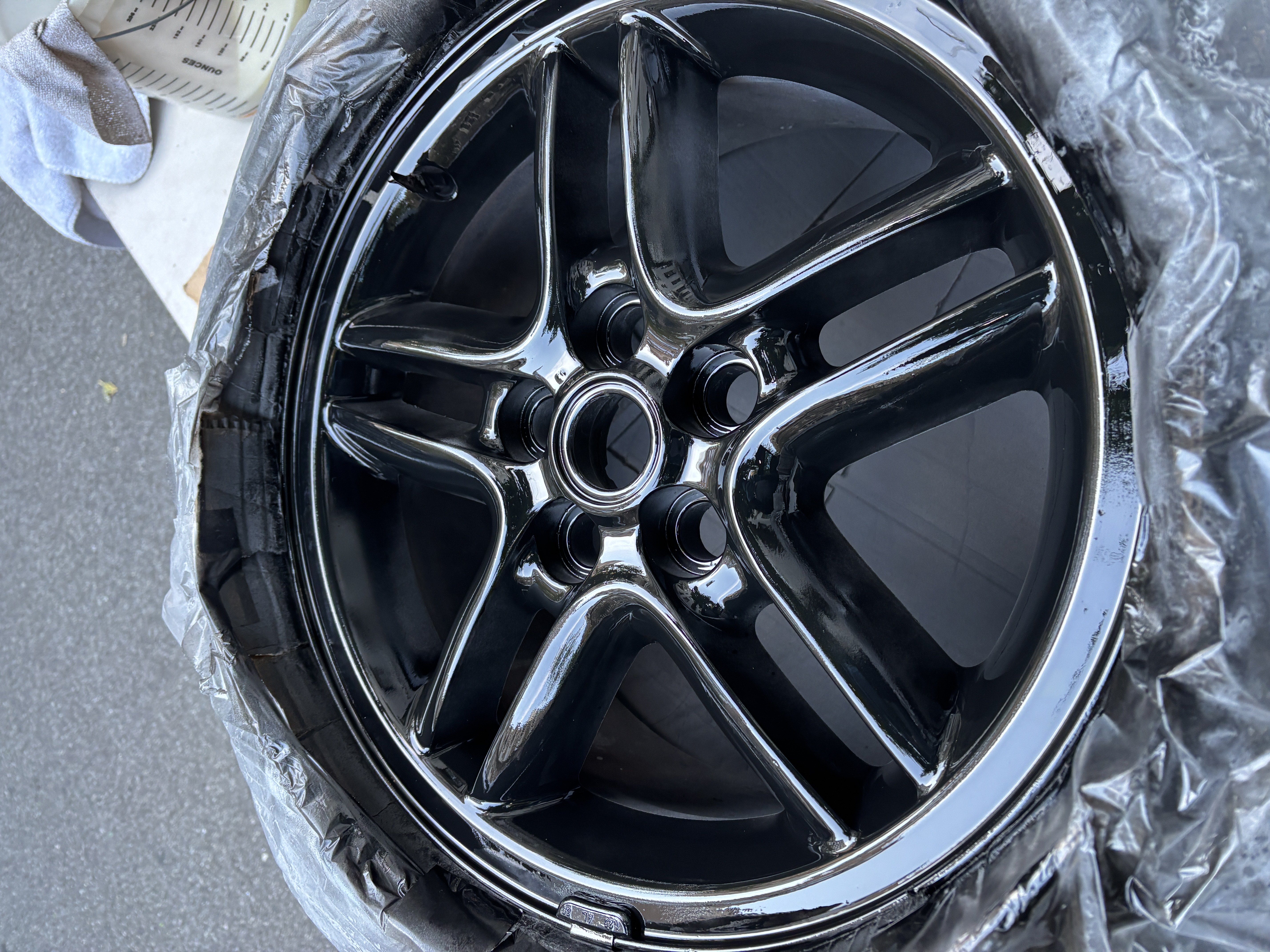

Hurricane wheel renovation. I have noticed a difference between the hurricanes on a DII vs a P38. The finish on my P38 appears to be "sparkle silver" as opposed to the other variety "bright silver."
A little research suggested other names for the technique/style are "Shadow Chrome" and "Hyper Silver", found on BMWs of similar age.

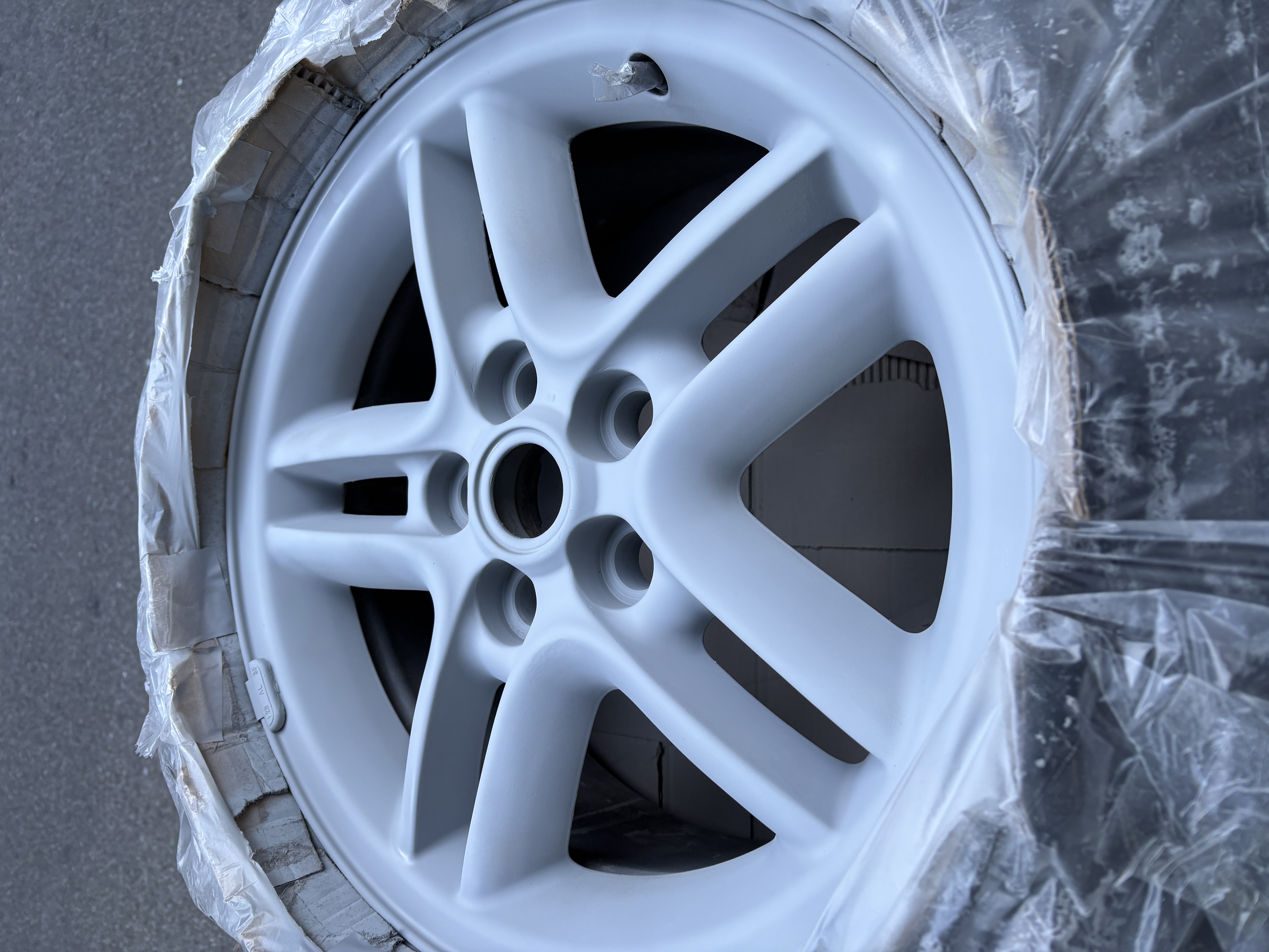

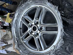

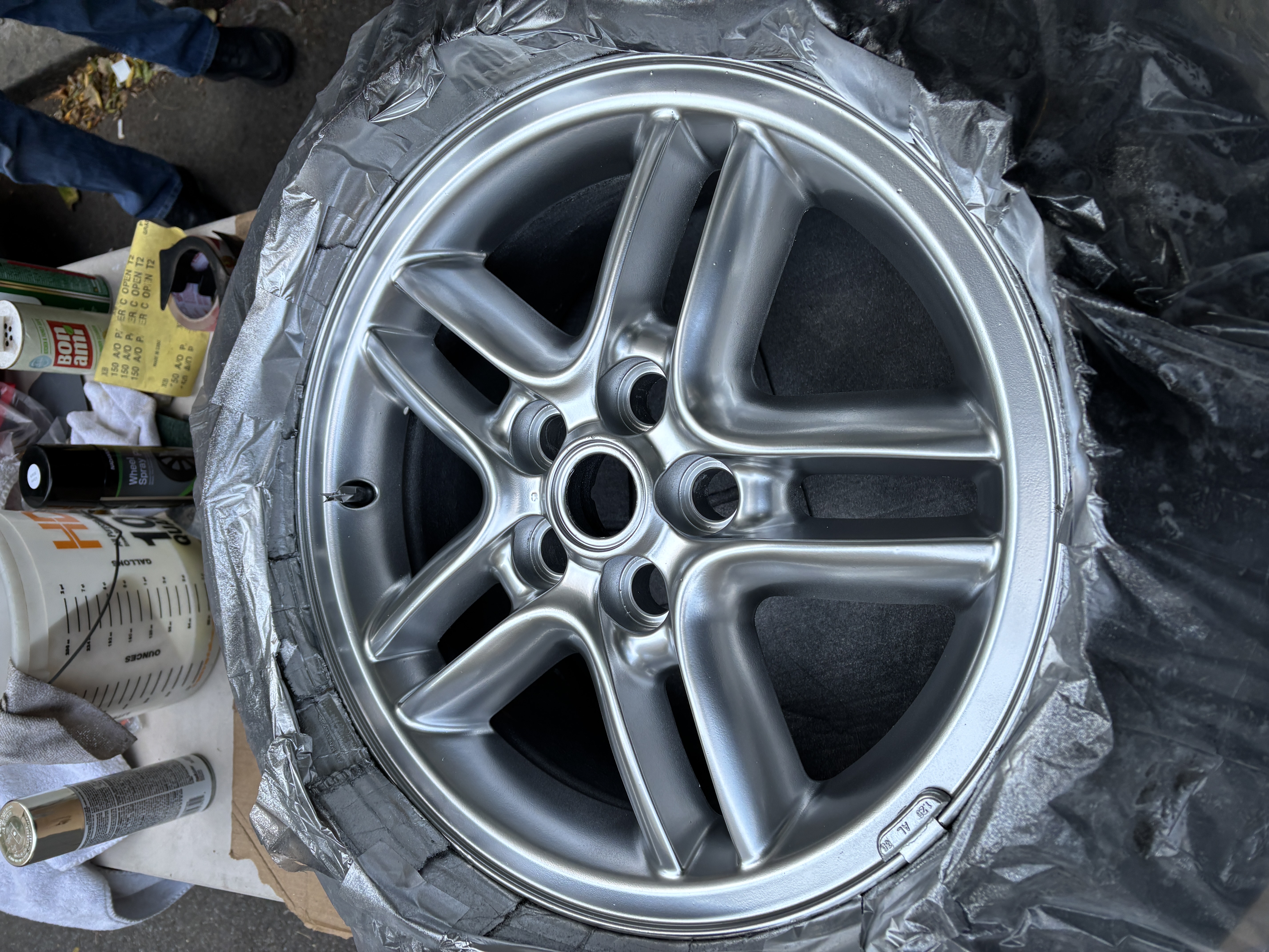

With that in mind I used my spare tire as a test bed. The process is pretty straightforward...
1) sand to a smooth finish being sure to remove all baked on brake dust and dirt. I wasn't seeking perfection so yes, there are a few flaws.
2) clean with brake cleaner
3) grey primer
4) two coats of gloss black. first is light. second is heavier.
5) one coat of chrome
6) two coats of satin clear coat (the wheel in the photos had not been clear coated yet)
They are a bit shiny, but are much nicer than the chipped and dirty state of the wheel prior to the work.

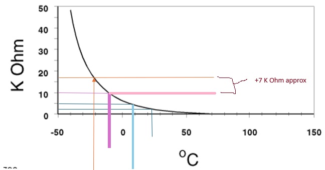

P0126 This code has been a constant source of trouble since I renovated the cooling system.
Upon startup, the Engine ECM compares the temp at the manifold to the temp at the bottom of the radiator. Theoretically the temp in the manifold should be much higher until the thermostat opens. If the difference between the two temp sensors is not sufficiently wide the P0126 code is generated.
If you use a 180 thermostat there is a chance that it opens early and allows heated coolant into the radiator faster than the ECM expects. The ECM interprets this as a faulty thermostat (stuck open) and throws the code.
A 5 kOhm resistor spliced into Light Green & Black (LGB) wire from the radiator temp sensor changes the resistance the ECM senses and this is interpreted as a lower coolant temp. This effectively widens the difference in temp between the two sensors and evades the code.
The orange lines are -33 deg C. That is the line where a different error code will be generated. We don’t want to raise resistance such that it would put us beyond this point.
The purple lines are generally about the coldest temps you will encounter. -10 dec C = 14 deg F
Therefore, we can add between 5 and 7 KOhms to the sensor circuit.

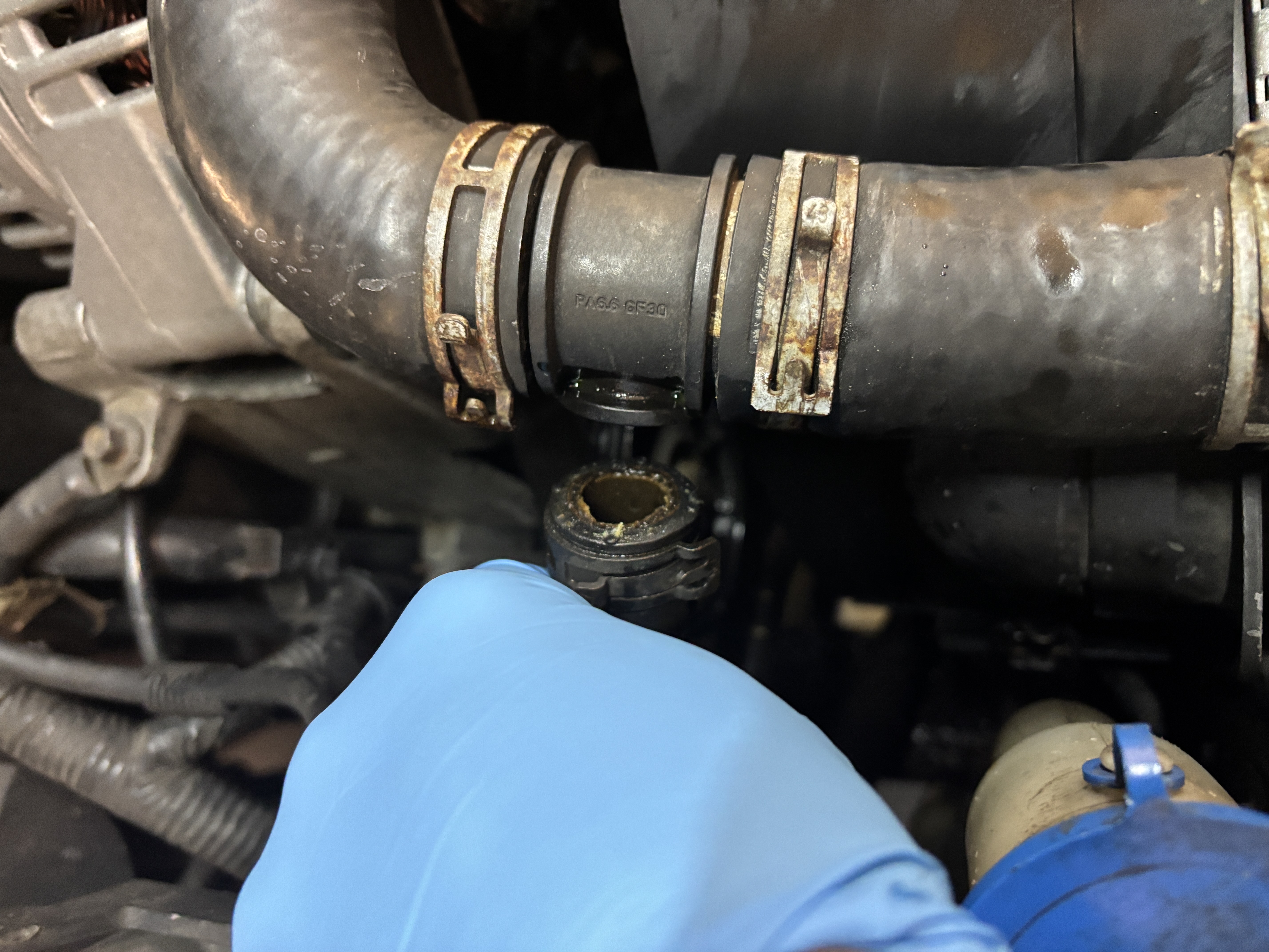

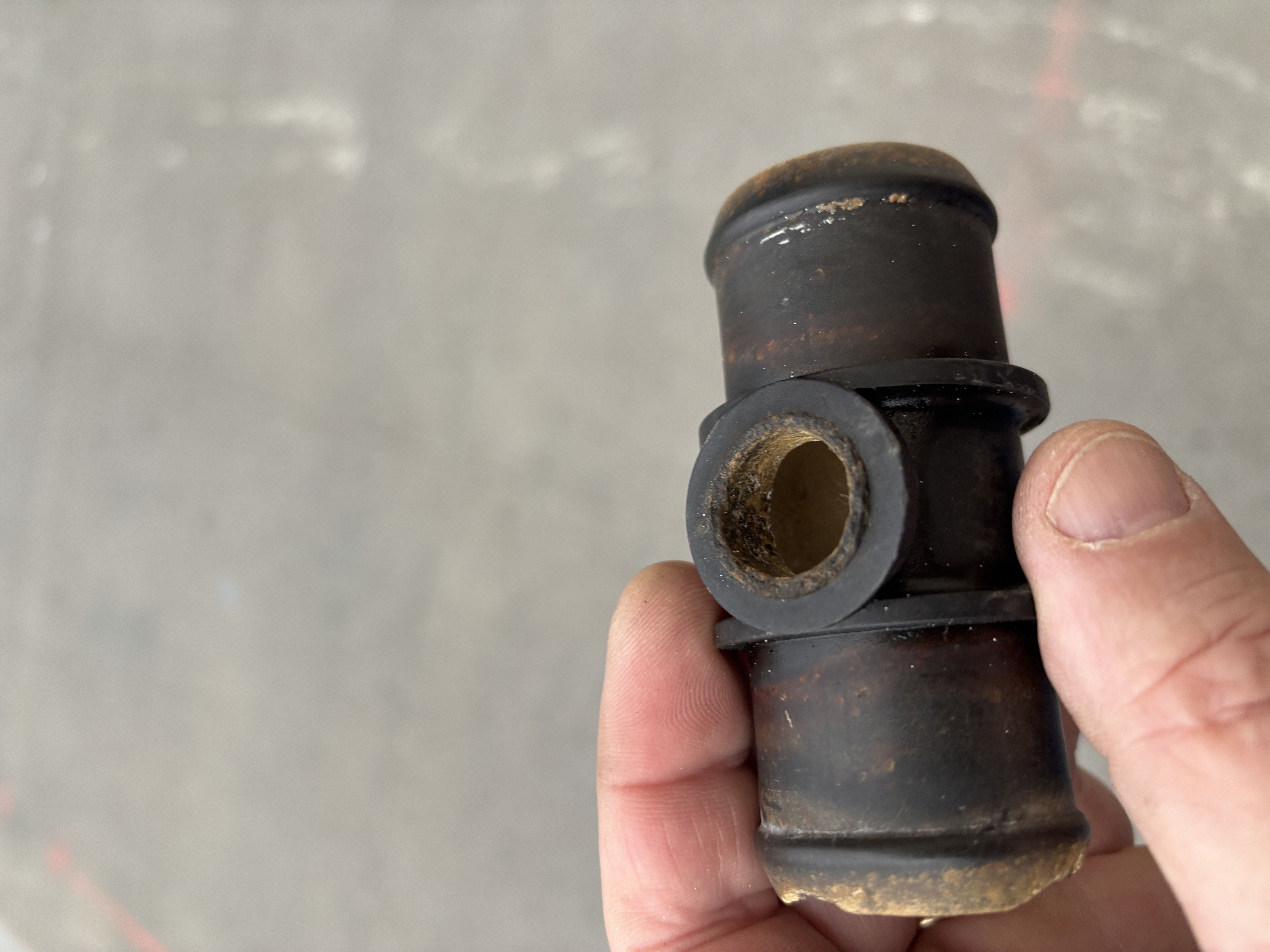

I had a bit of seepage from the water pump gasket and a t-stat that seemed to be stuck open so parts were assembled and work began.
While reaching to release the clip for the fan shroud my arm lightly touched the T connector of the upper radiator hose. Oh ****! I guess it is better to have happened in a garage than on the road, but where am I going to get a T connector?!?!

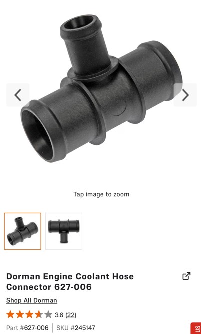

After mentally thrashing about for a couple of hours and some intense googling, the Dorman 627-006 seemed to be close enough to try. It worked well enough but I think it is a touch smaller than the stock connector. I'll measure the difference in the next couple of weeks. As it is winter, a slightly smaller inside diameter is not going to be an issue.
Land Rover used one part number for all three hoses and the connector as a unit (PCH000900) and did not sell the connector separately. The parts houses only offer the three-hose unit.

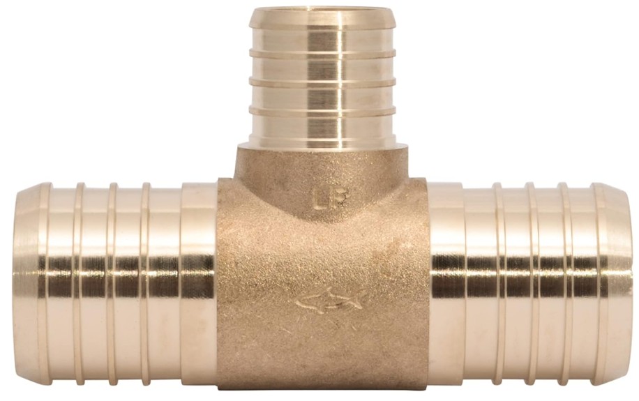

Next thing to investigate is a brass fitting.

coolant T update.... aluminum T available on Ebay....same inside dimensions as the stock T (you could go with a 38mm X 25mm for increased flow).... https://www.ebay.com/itm/157258629615
