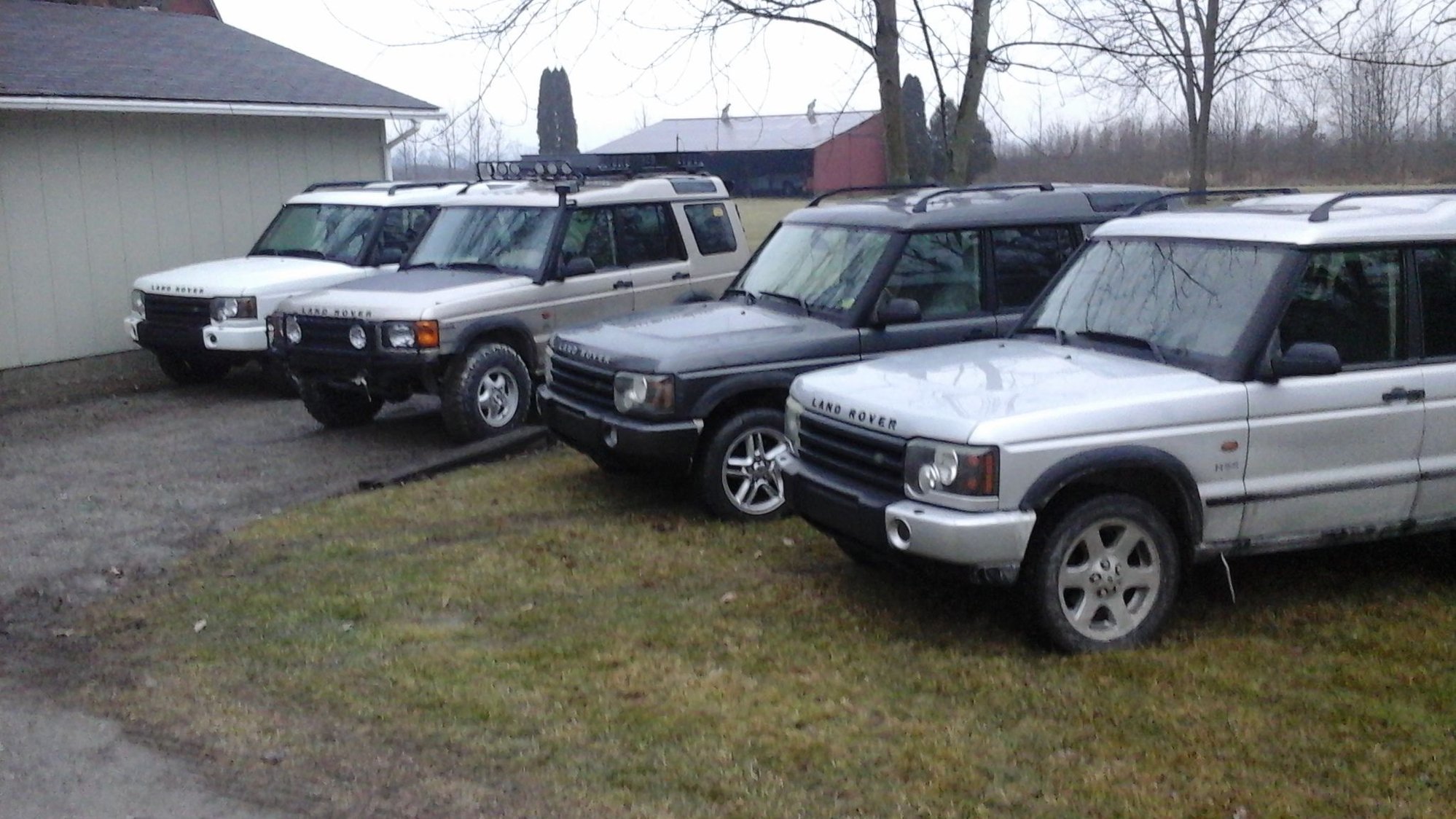

Thought l'd start a new build/swap thread about the 03. Granted, most of the build will be swapping parts...but several changes are planned along the way. And who knows...maybe l'll finally finish my front bumper while it's off. I've never added the fender ends, which would be nice for jacking proposes.
Anyhow, this rover will replace my 01. Not going to lie....part of me will be sad to see the old girl get disassembled...being my first true land rover love. But, she is not worth selling and actually worth more in parts (since we have the others). I'll keep entire drive train and other little do-dads.
The 03 came to me as a non-runner. After changing crank sensor without any success, found the ignition relay loose and pushed it in...and she runs great now. First plans are to do all fluid changes and swap out non-CDL transfer case. Have an 04, with factory shifter, under the work bench. I'll probably drive it for a few weeks, before any of the swapping of parts happen. Plus, hit a deer with the Silverado...so that's going in for repairs...this makes the 03 a daily driver until l can take her off the road long enough for transfer case swap.
Anyhow...here is my new trail rig...and her new family.
Again, l'm going to hate seeing the old 01 go...her and l shared some fine times together...plus, drove her for 38K over the last two years...not bad for a five hundred dollar initial investment and another $700 for trans, drive shaft and y-pipe...but it was time for a bit nicer rig.
