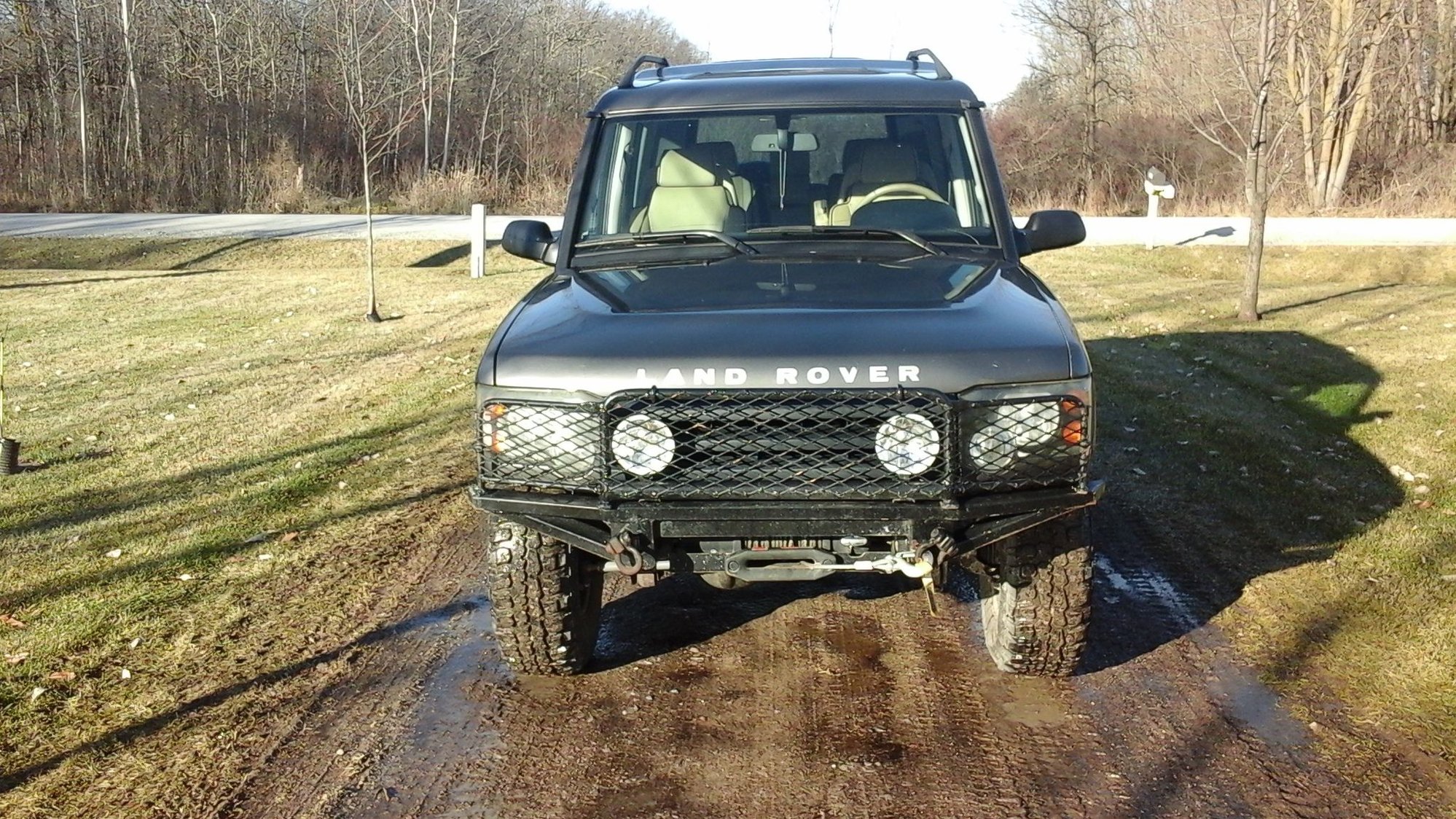

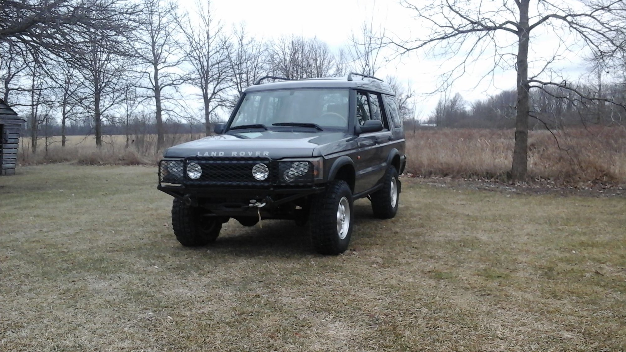

Did some of the change over. TF 2 lift and 1" spacers, front bumper/brushguard/winch, tires, pads/rotors/calipers installed.

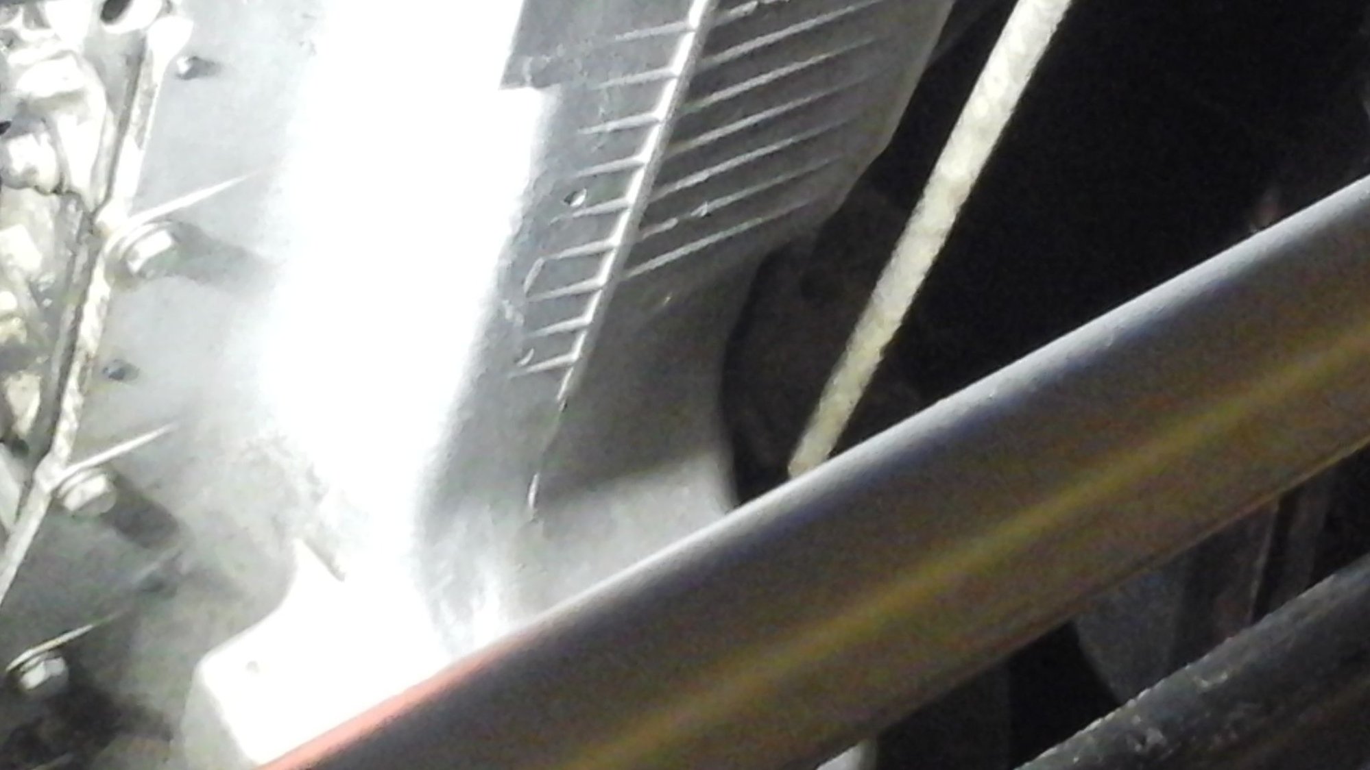

Replaced front crank seal. Leak made the Exon Valdez spill look lIke a minor incident.

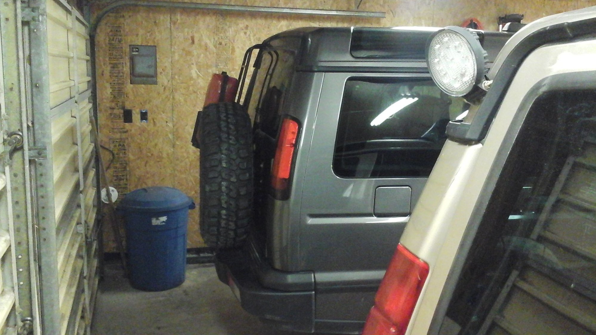

Swapped a few more things over, passenger mirror assembly, idler/tensioner and belt, couple better looking hoses, rear ladder, tire carrier and a few other odds and ends. Took to car wash for degreasing and wash job.

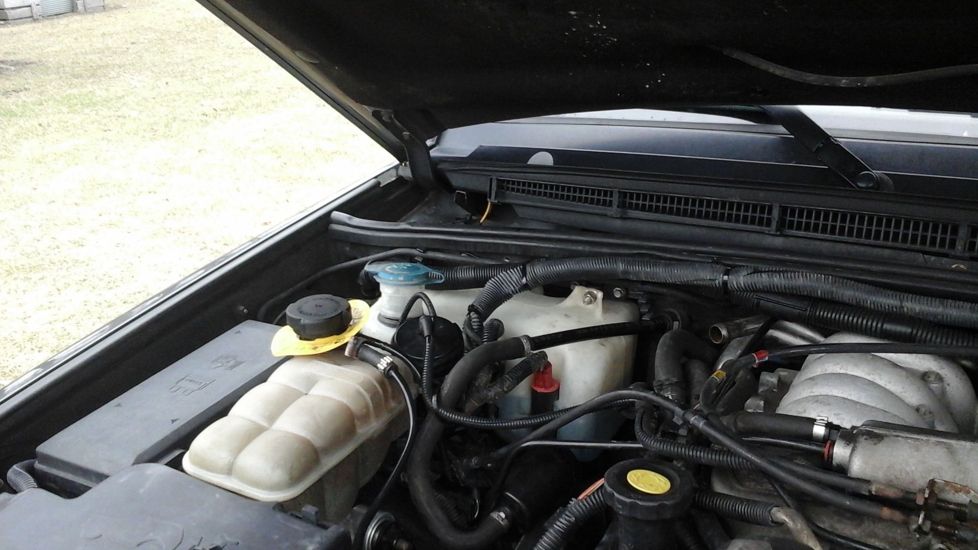

1) Relocated the washer bottle and replumbed/rewired.
2) Ran interior winch control wiring harness through firewall (must be done before relocating washer bottle...grommet is just below bottle).
3) Removed front sway bar and installed skid plate.
4) Wired up winch and mounted solenoid pack in factory jack location (temporarily, since l need to change battery terminal ends for larger 01 battery set-up).

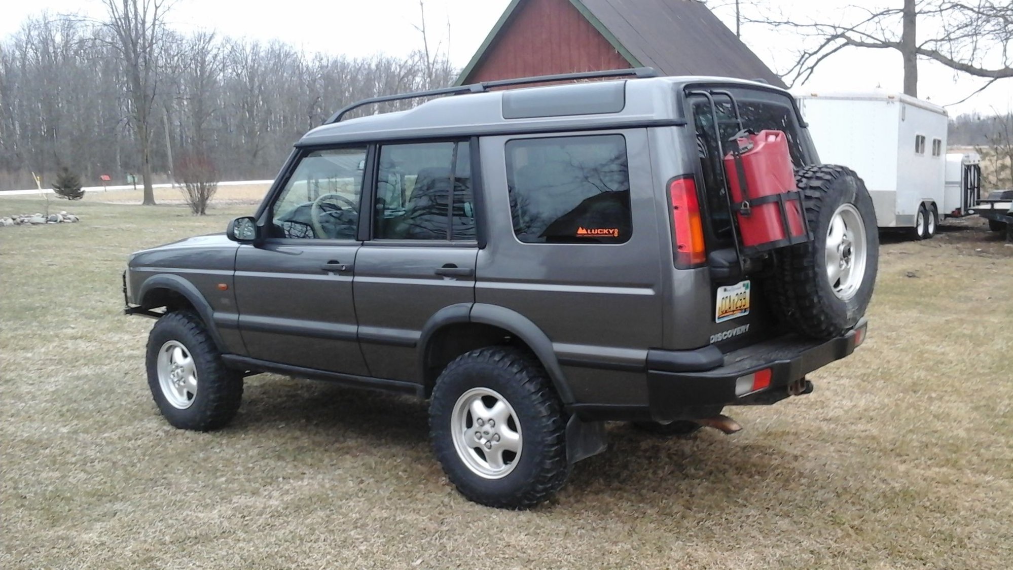

Since everything is pretty much a repeat of the 01 build, no sense going into great detail about swapped items. The only change that was somewhat new, was the adding of the rear roof rail extensions. Pretty straight forward, remove rear plastic piece above rear door (just pulls off), then remove both right and left rear window interior surrounds (a couple screws, piece behind seat belt mount and about six/seven push pins). This allows access to the rear bolting area. Drilled a small pilot hole from inside, centering in exsiting hole, then went up top and used a holesaw to cut away outside sheet metal. You only go through the first layer, stop as soon as it cuts through. They have plugs in the rear mount of the front roof rails, where the rear extension mates, just drilled out the rubber plugs...there is no pulling them out...they're about an inch long. Add some adhesive around mounting hole in rear and slid front pin into mounting hole in forward position and slide the large washer that goes beneath rail extension in new hole and then guide rear bolt of extension through new hole. Install nut/washer inside and tighten. Reinstall interior pieces.
