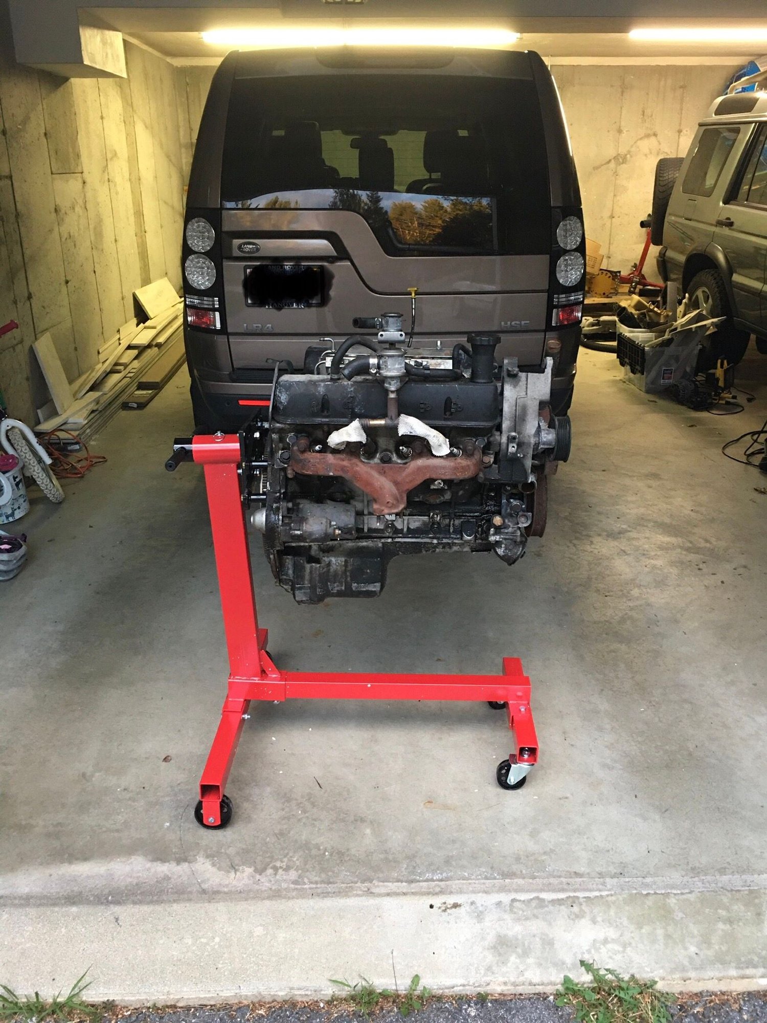

Been pretty busy lately but finally got around to pulling the engine from the parts truck. I took me about 10-12 hours or work overall but that was spread over weeks of spare time on the weekends and evenings. It went pretty smooth expect for the occasional stubborn bolt. I could not get one of the rubber engine mounts out but was able to remove the bracket as a work around. It was a little tough seperating from the transmission. For a minute I thought I missed a bolt. Some wiggling back and forth and it came free. I’ll be tearing down this engine over the next week to see the reason for coolant in the oil. Hopefully the block is good.
Next up transmission and transfer case.

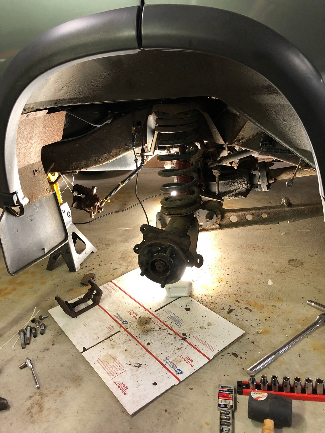

Suspension work has started. The rear hubs appear to be original or at least they used LR branded replacements at some point. They seem right but will be replacing while I am in here. I got the OME heavy duty spring and shock kit. This should work nicely with the steel bumpers and sliders I will be ordering shortly. The steel brake lines are looking very crusty so will be replacing them as well. I snapped off all three 8mm bolts holding dust shield even after some heat and PB blaster so will be drilling and retapping...

I'd be scared to death...to put a jack stand under the frame in that location...on any Dll that has lived in Michigan. Most are ready to crumble away and wouldn't support the weight of the vehicle in any way shape or form.
I hear that. You should see the frame on the parts truck I have. The jack stand in the picture is actually not holding anything. There is one to the right just out of frame along with the tire removed for safety. The frame in the rear is actually is in really good shape surprisingly as this truck has been through a lot of New England winters. I just needle-scaled the rear and will be applying a rust converter and top coat plus I might try that Eastwood interior frame coating. I don’t like getting under a vehicle even on jack stands.
