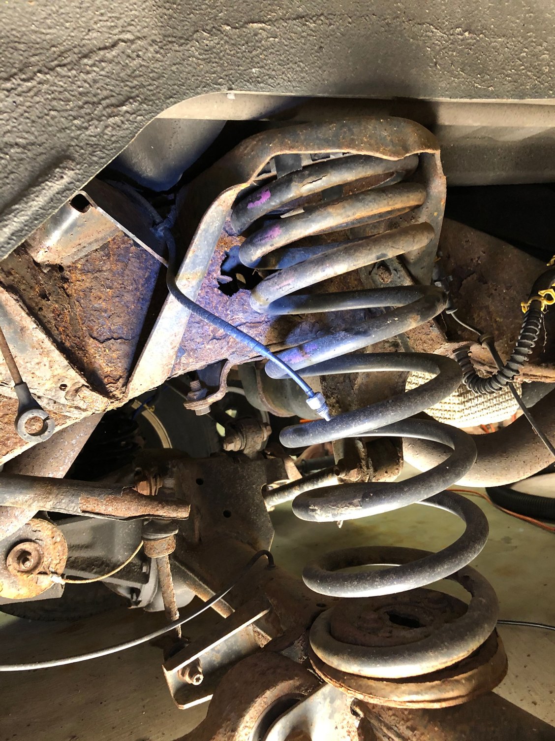

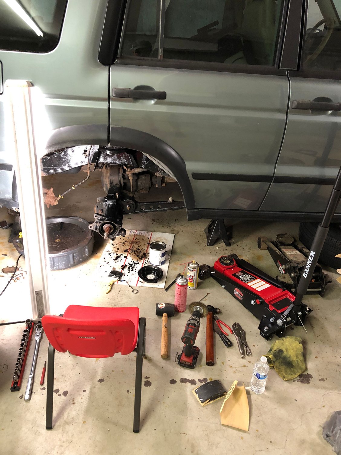

Rear suspension work proceeding slowly as I wait for more tools and parts to show up. Trying out the Eastwood rust encapsulator paint and top coat. Time will tell how well it holds up. I needle scaled and then sanded the areas and clean up with brake cleaner to prep the surface. Some bolts broke during tear down which is always fun.

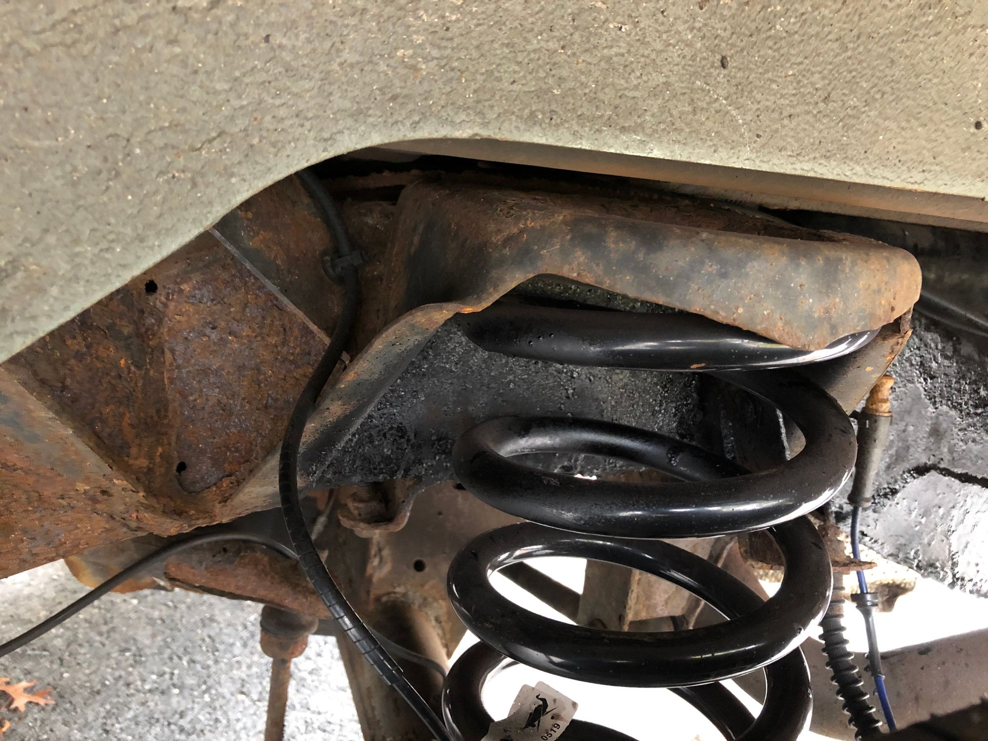

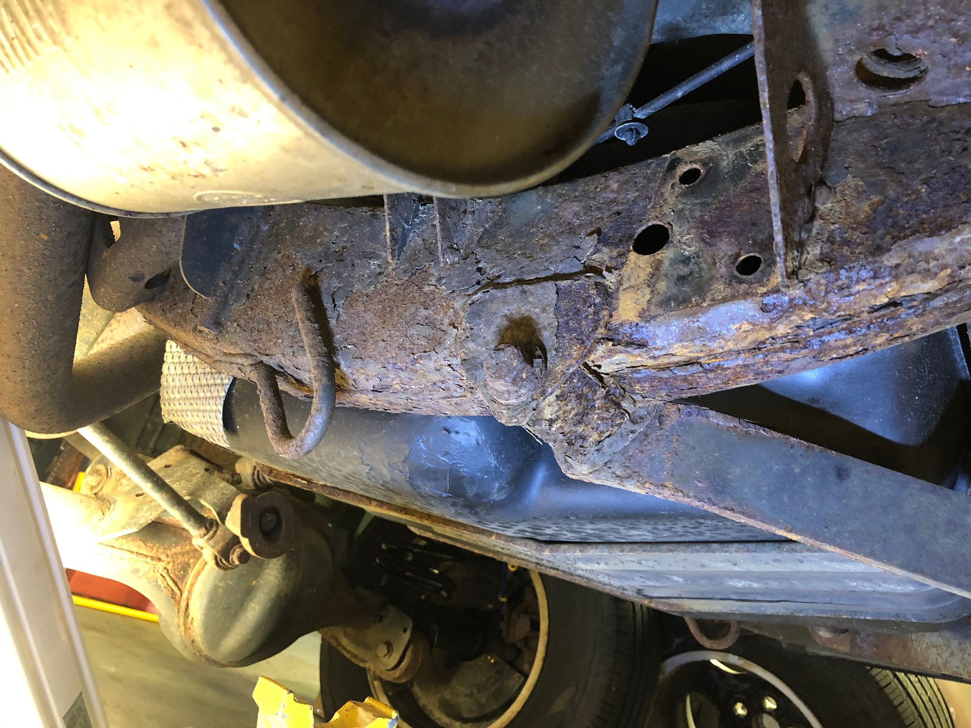

Project is again progressing. As I was installing the lift on the rear of the truck and needle scaling the frame as I went I found a pretty good hole in the frame behind the drivers side rear spring pocket.
looked into various options from a whole frame swap to just replacing the rear frame half. Many thanks to @boston4 for recommending AW Fabrication in Woburn. Keith is a great guy and his prices are extremely reasonable. Checked over the rear frame and replaced any sections that where bad. It’s not the prettiest work but it sure is solid now.

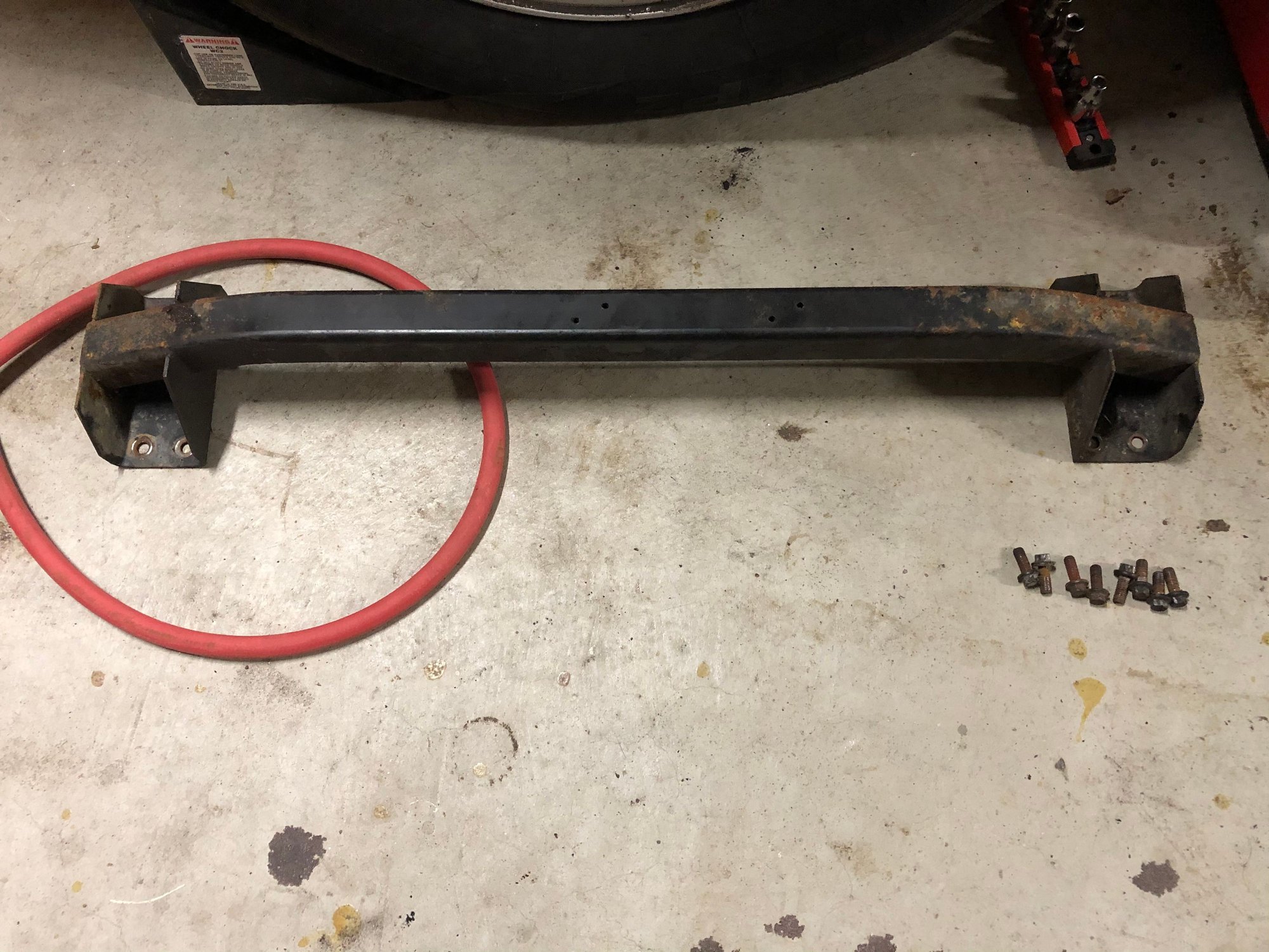

I feel like I won the lottery today. All eight bolts removed from the cross member successfully. Just a little heat and WD40 did the trick. Took all of 30 minutes. The front driveshaft was about an 1” away from it so it needed to go.

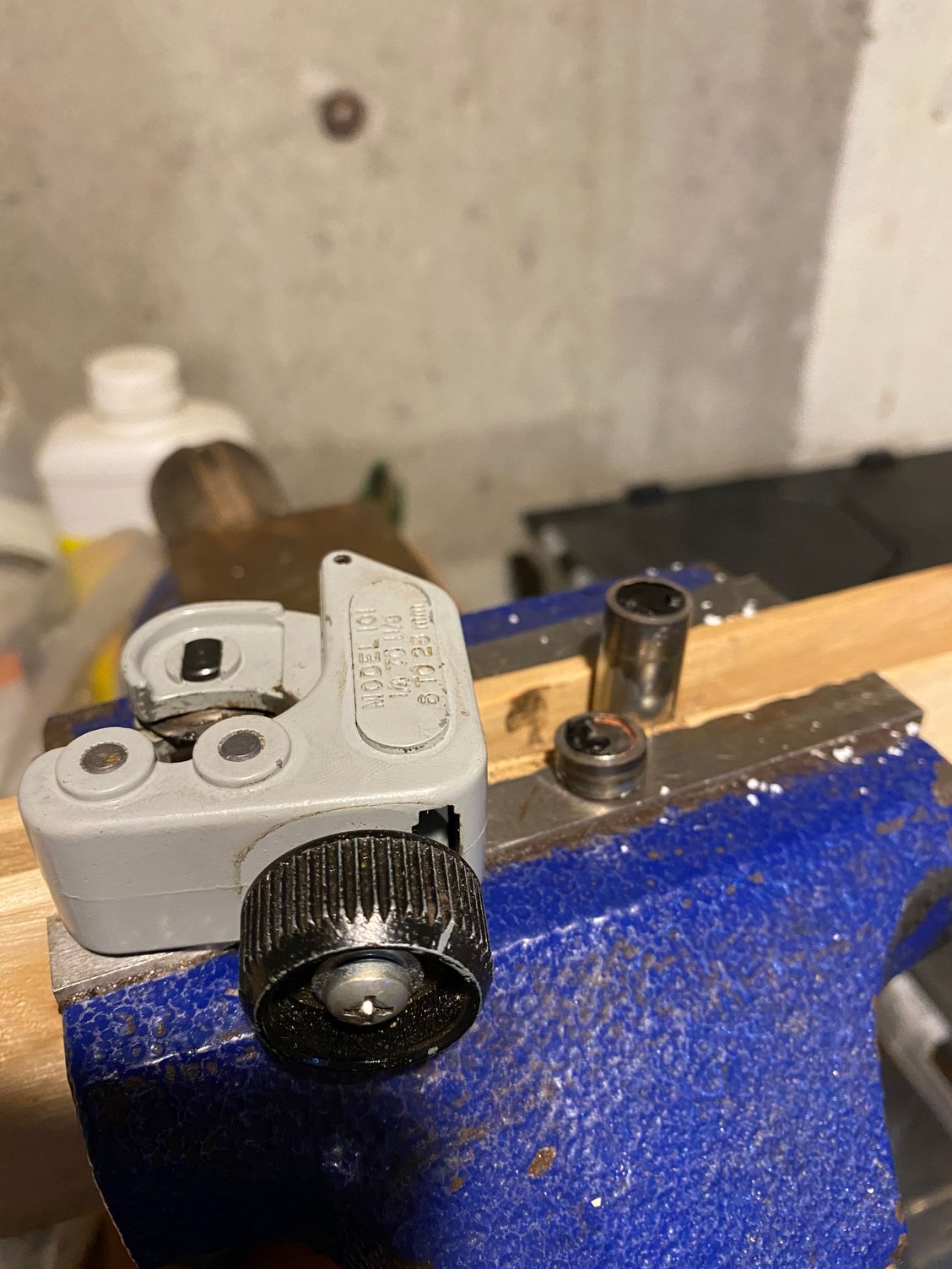

I decided to fix the loose headlight on the passenger side while I wait for more parts to come in. The finisher was cracked in two. I had to drill out one of the etorx bolts as it was seized in good. One of the Philips screws in the headlight was spinning with the brass insert. I used a high speed drill to spin the screw and insert to melt the plastic so I could get it out. Then removed the screw from the insert on a vise. A little superglue and the insert is good and tight back in the headlight housing.

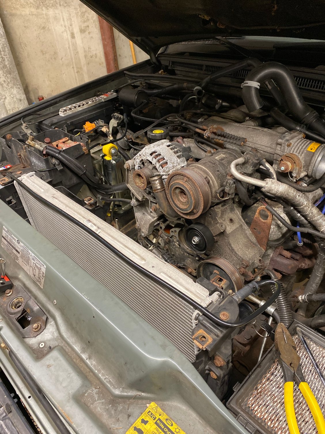

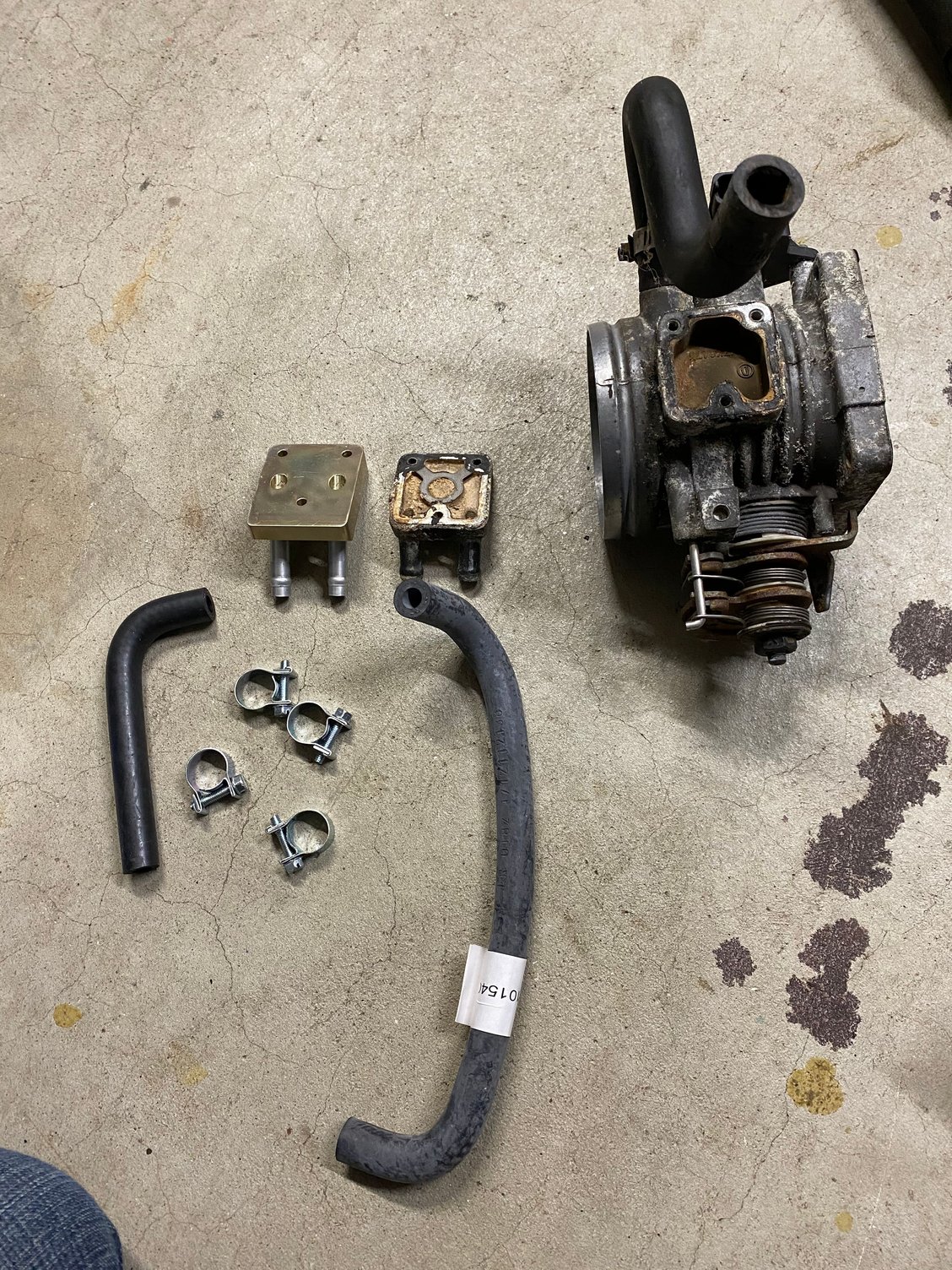

Refreshed the cooling system with all new hoses, water pump and in-line tstat from extinct. Overall a fairly easy job. Also replaced all the idler pulleys, tensioner and belt. Plugs and wires where just done by the PO. I installed an updated throttle body heater plate I got from the Sports Car Centre in Edmonton. Completed the PVC mod which took all of 15 mins.
I had some trouble bleeding the air out of the cooling system. I might modify the new thermostat housing to add a bleed screw on top.
New heater plate along side the old.
Coolant system tear down
Cutting the old PVC baffle out and widening the tube.
