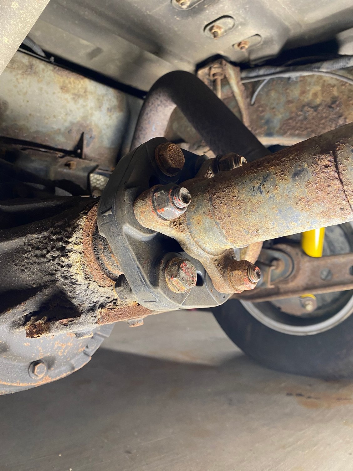

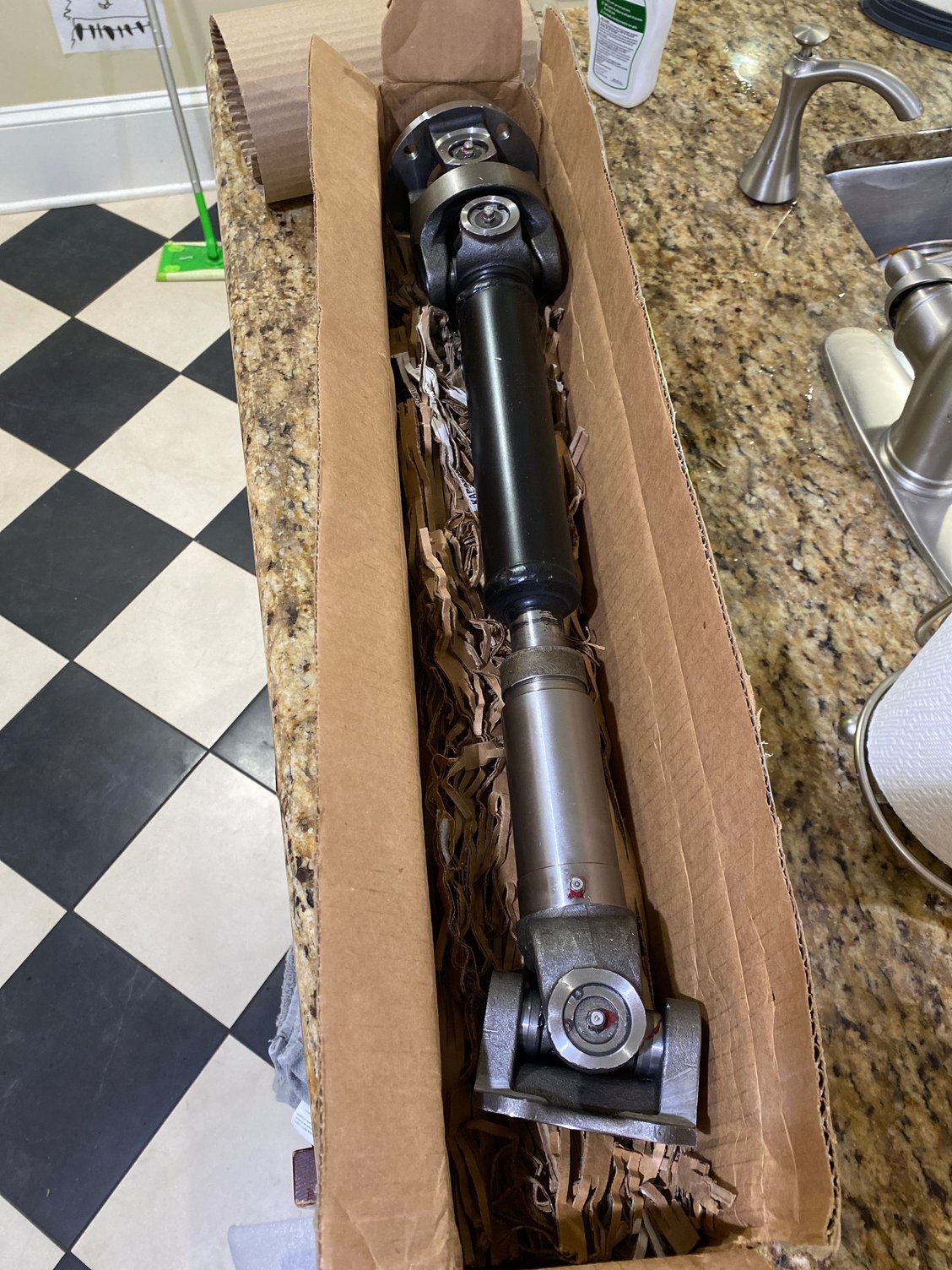

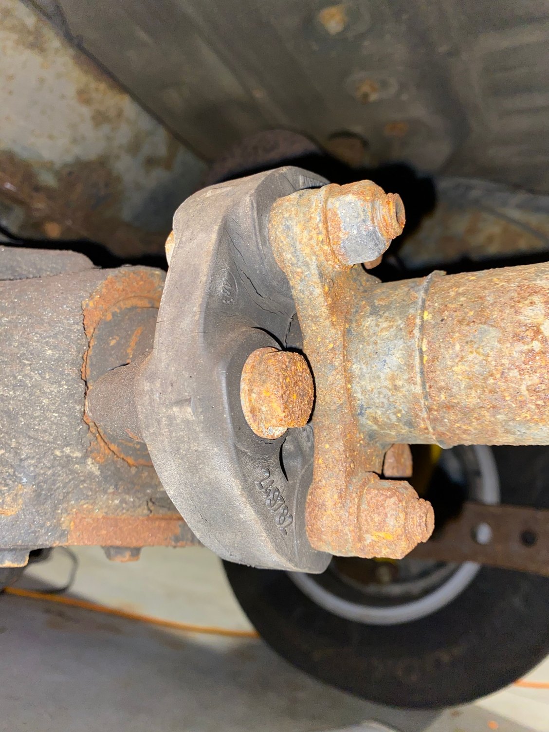

Installed new front driveshaft from A1 in Milwaukee. Very well built unit at a great price point and fully serviceable.
Also replaced the rotoflex as the existing one had some good cracks. The one I got from Lucky8 had the arrows in the opposite direction as the OEM unit I pulled out which was curious. I reinstalled it but used the bolt orientation as OEM.
Old:
New:

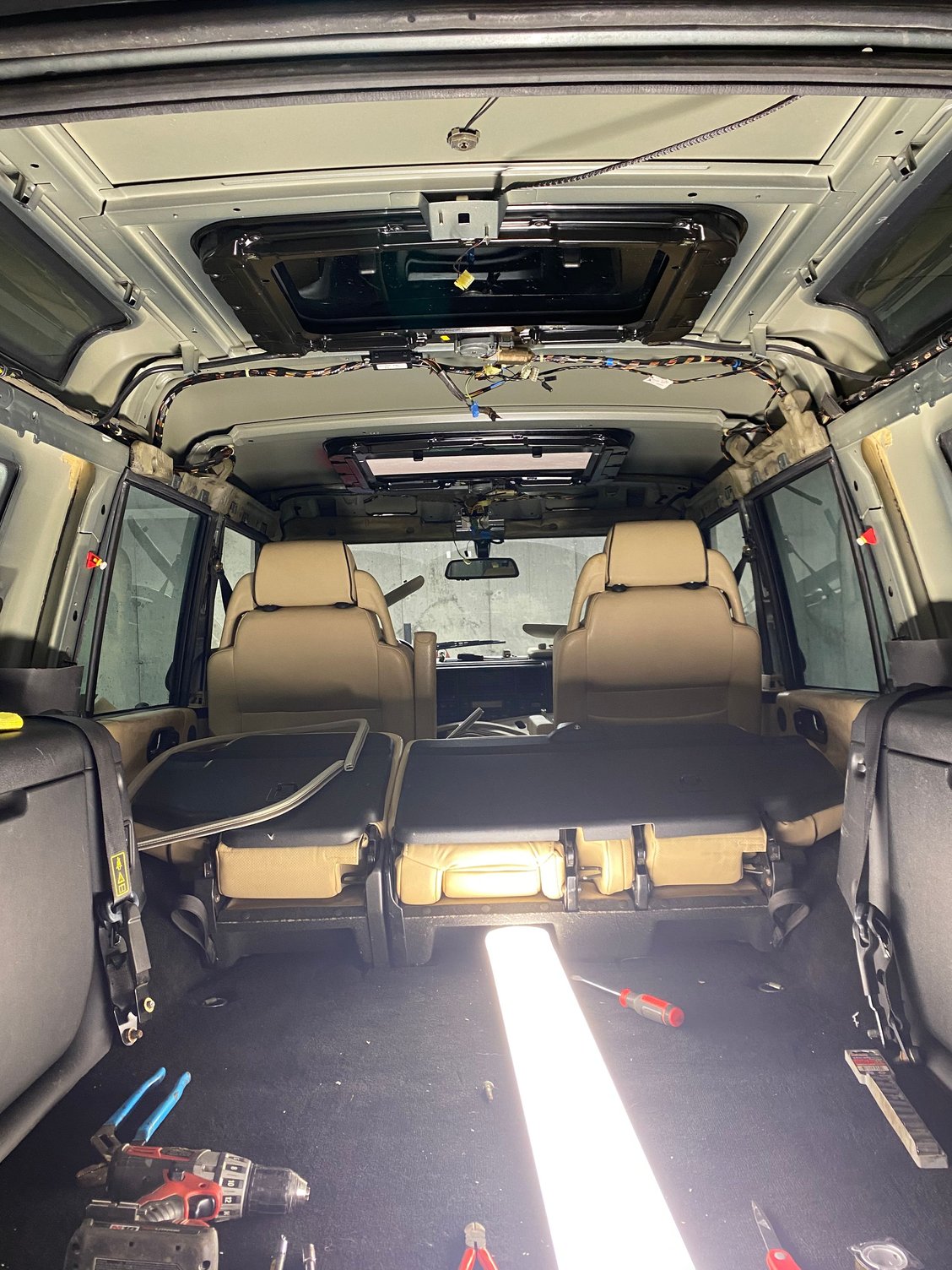

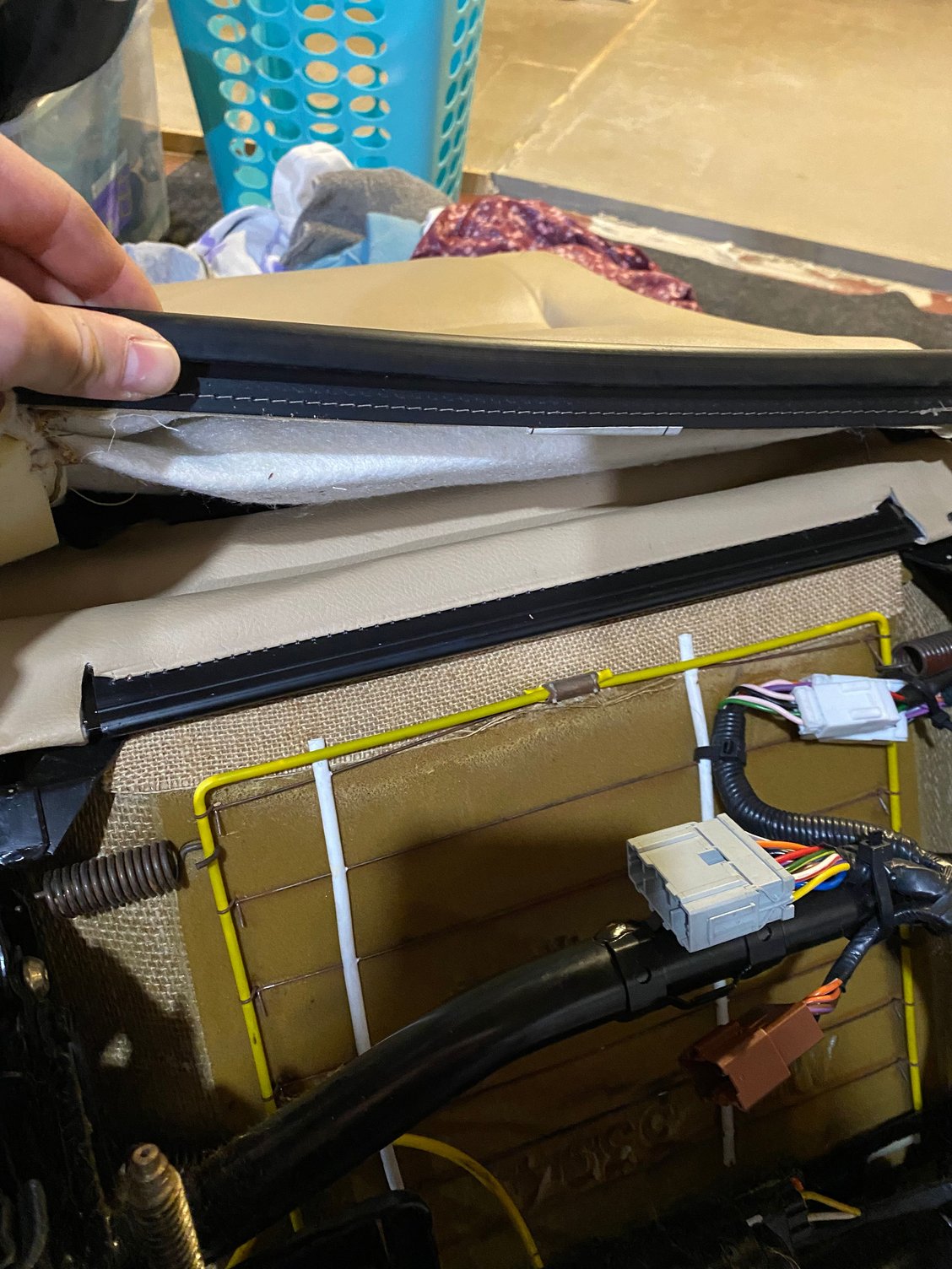

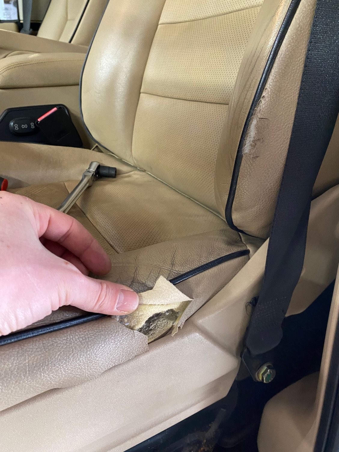

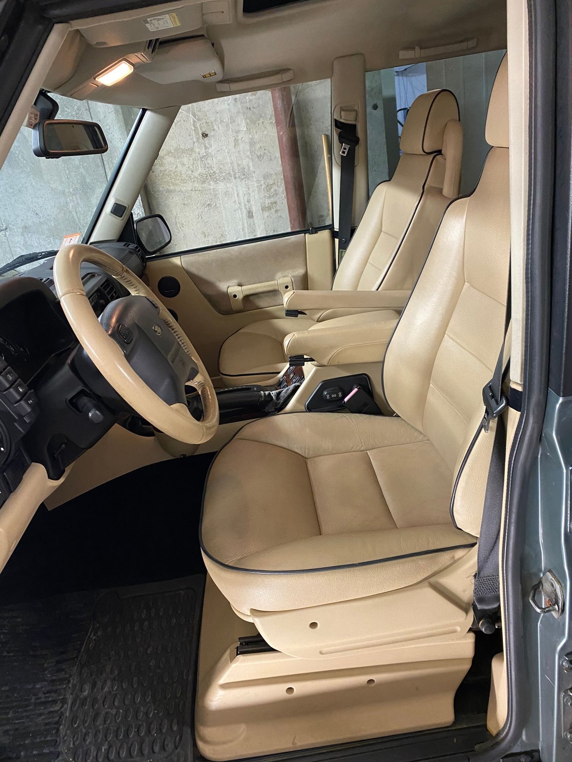

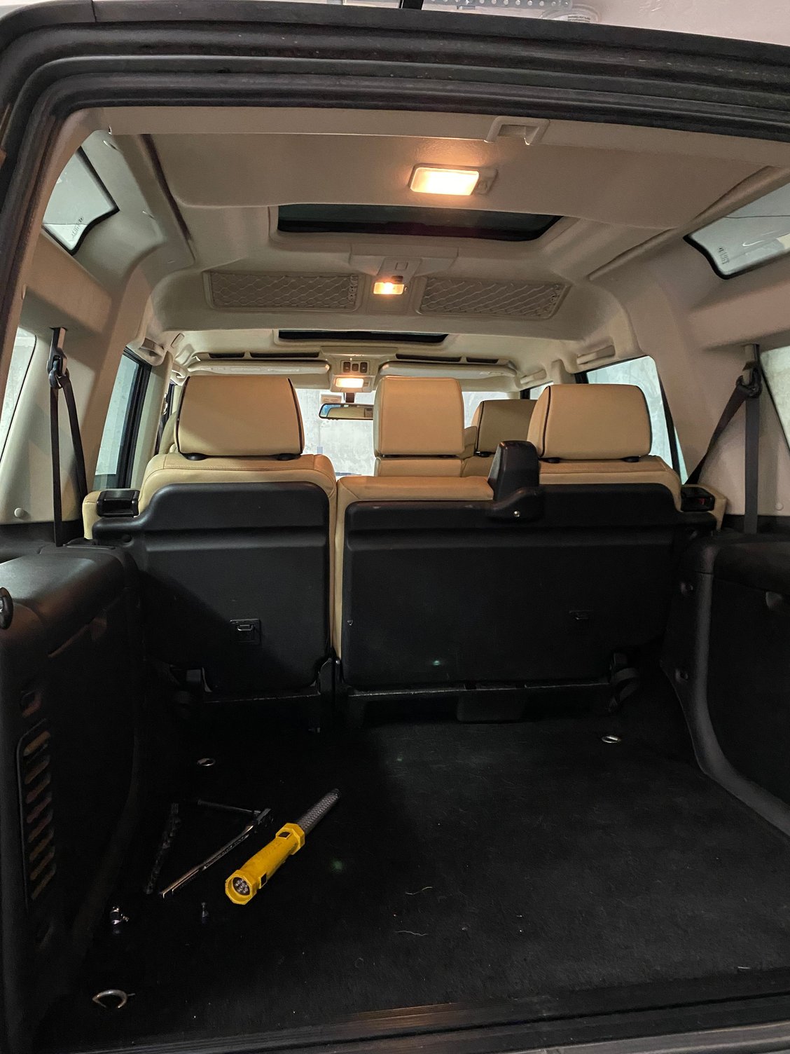

Completed the interior refresh while I wait for additional suspension components to arrive. All sunroofs are now functional and leak free. New headline is in and fixed the sagging nets in the back and swapped in new front seats that I pieced together from my donor vehicle.
All my interior dome lights didn’t work either. Not sure what the problem was but someone replaced the front sunroof motor at some point and I think removed a ground from the dome light. Now they all work consistently which is nice.
Removing the seat backs to switch the bottoms over
Example of the damage to the original seats. Much worse in other areas
Repaired front seats installed
New headliner in with working dome lights

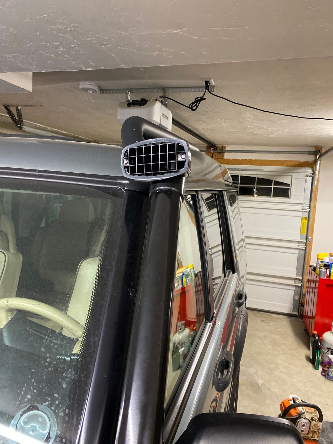

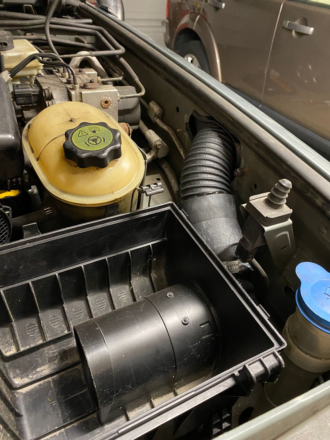

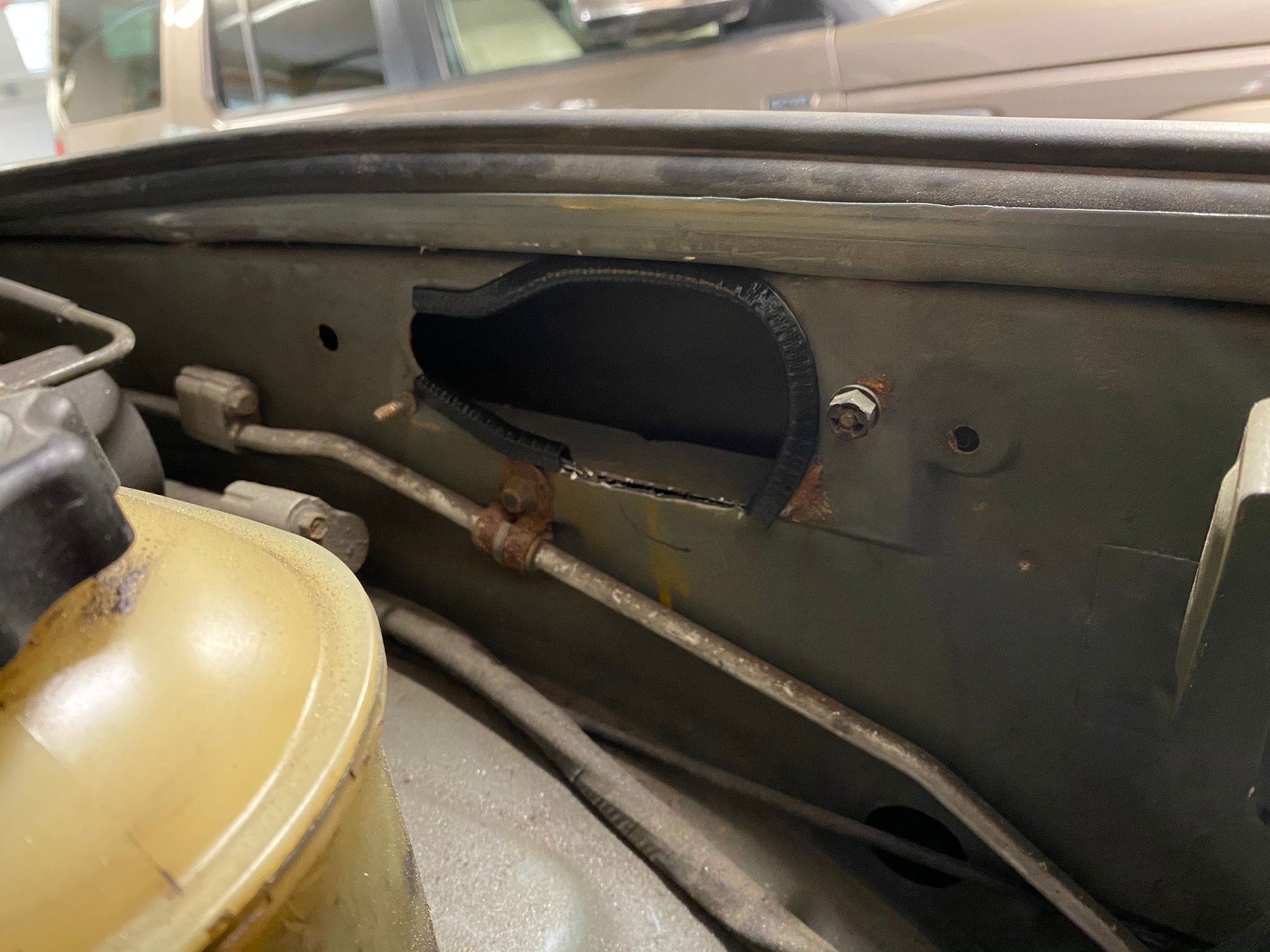

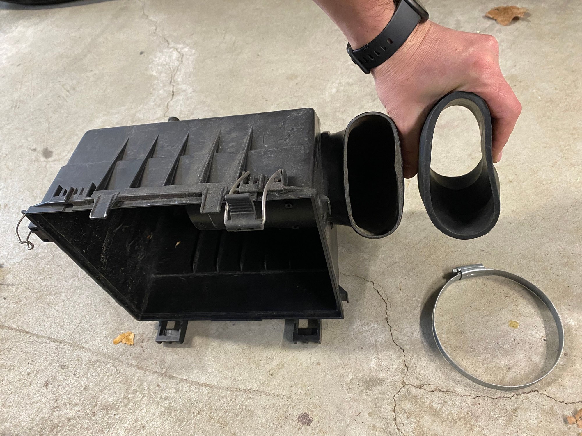

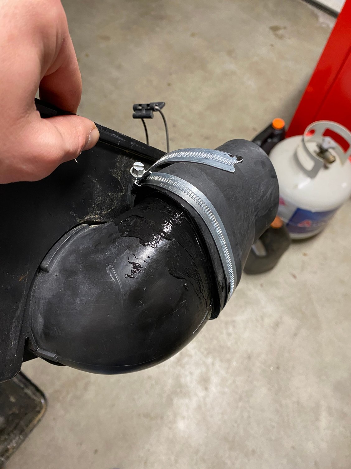

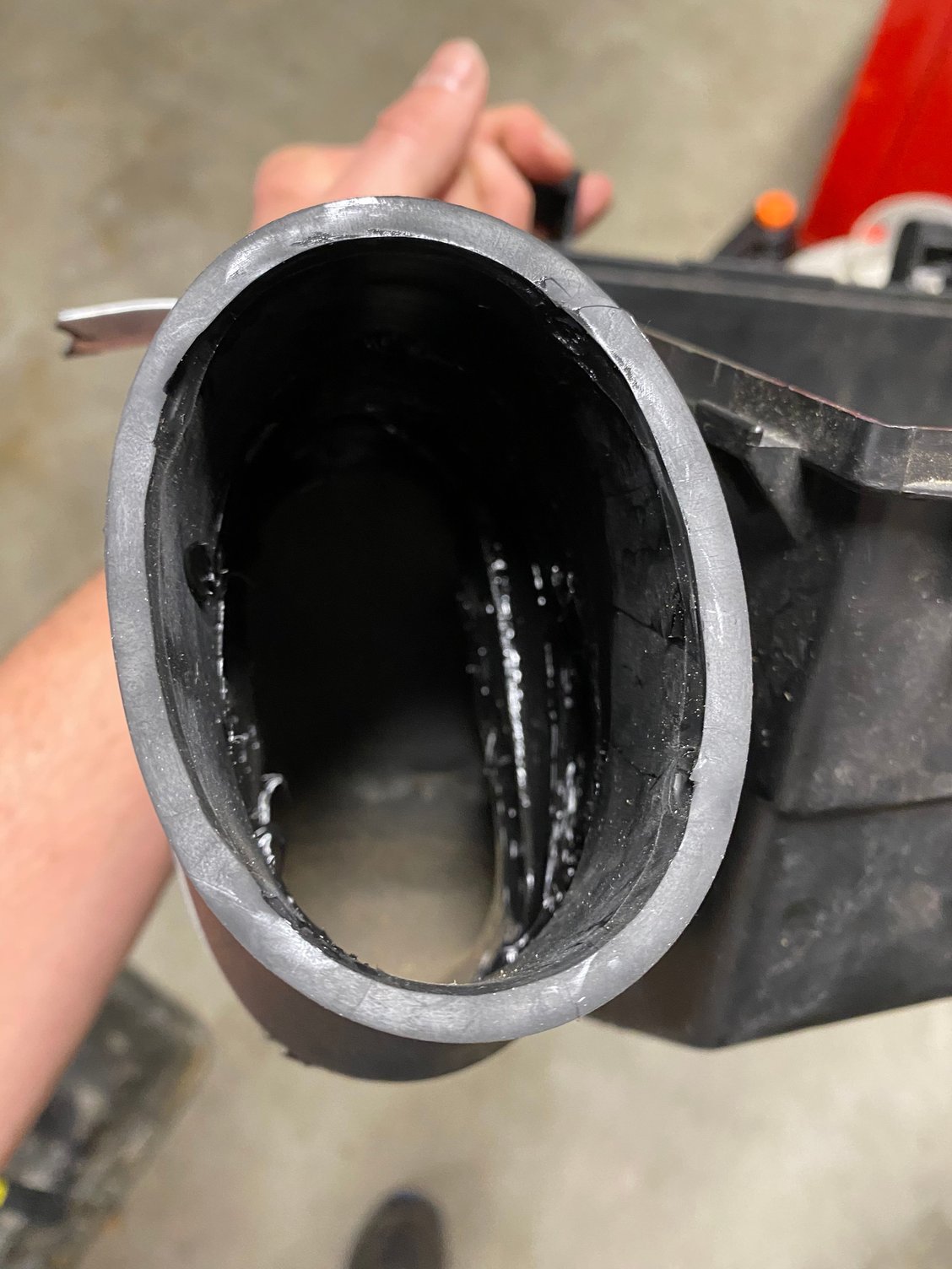

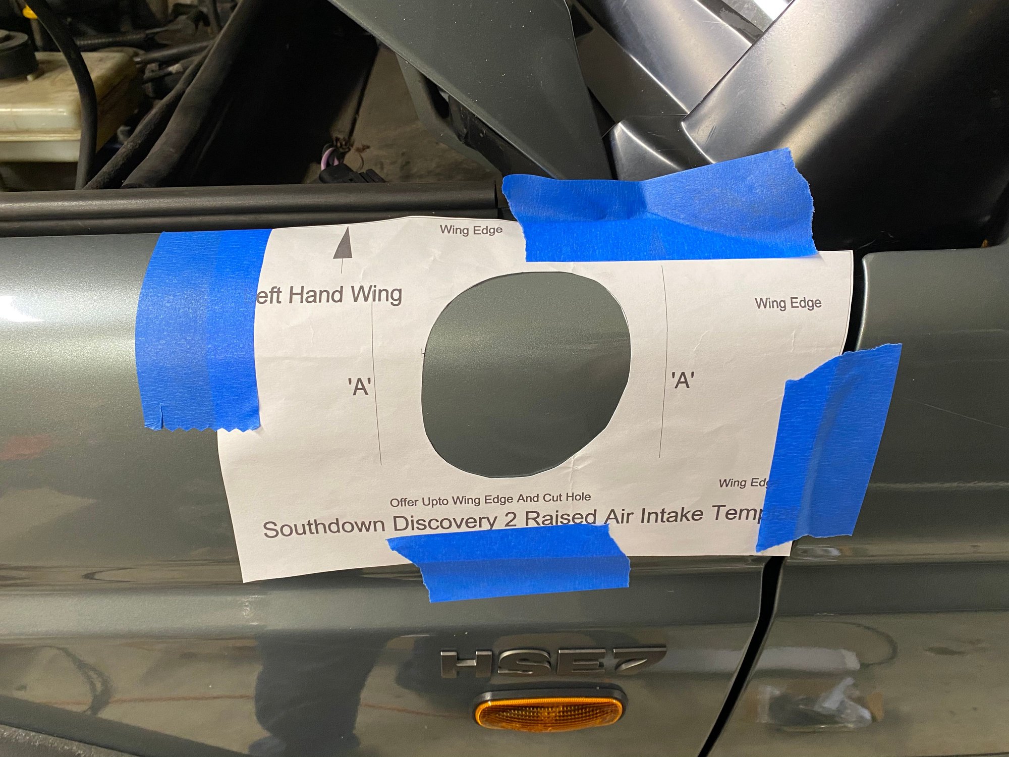

Installed a Southdown snorkel this weekend. All went pretty smooth and it’s a well put together kit. I ordered directly from Southdown for just about $295 shipped. It was cheaper then purchasing from domestic suppliers. Some pointers:

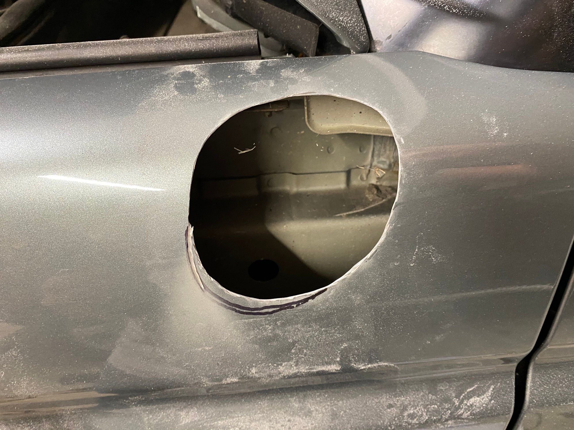

- the template provided is close but the hole needs to be extended in the bottom left edge so that the plastic moulding fits the wing properly

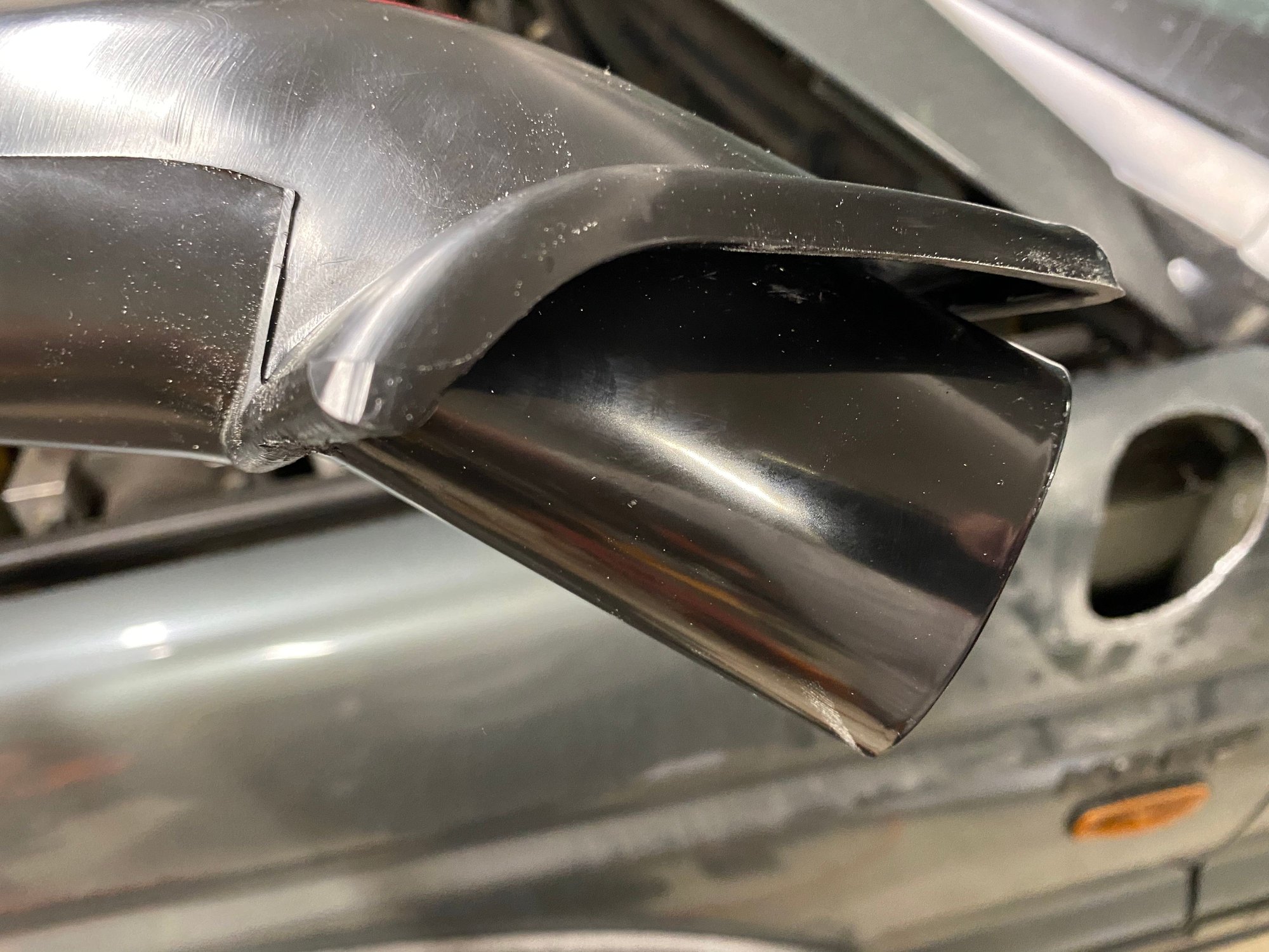

- make sure the pipe is completely seated into the plastic moulding.
-Remove the air box so that you can properly attach the reducer and use lots of sealant/adhesive.
- loosen/remove the inner wheel well liner so that you can help guide the flexible hose through the wing.

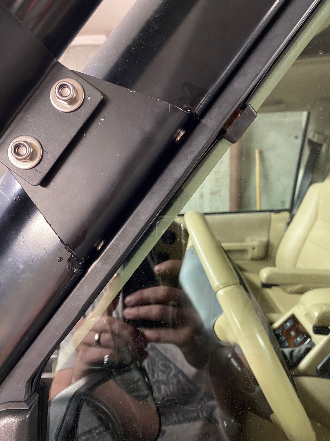

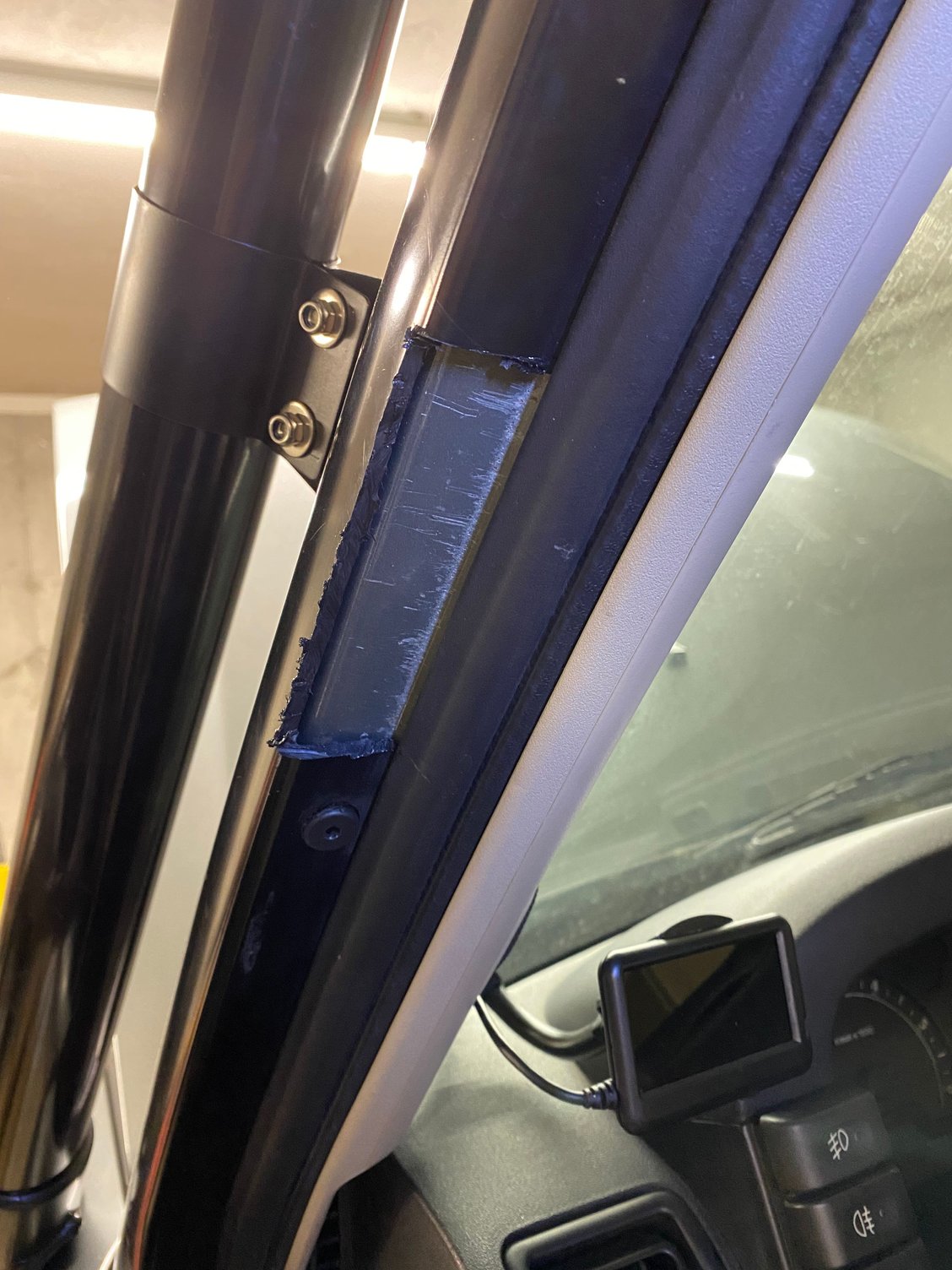

My truck had aftermarket pillar trims installed at some point which are thicker/larger than stock and there was no way it would fit with the door closed. I had to remove material to get it to fit properly. Not sure it would fit well even with stock pillar trim as the screws that come with the kit have a thick pan head.
Template aligned on the wing
Extended the hole to properly fit the plastic moulding
Fully seat the pipe to the moulding
Widen the hole for the flexible pipe. Added edge guard after filing down the cut edges.
Air box out with reducer abs jubilee clip
Mounted with plenty of sealant
Smoothed sealant inside
Air box installed
Removed section of pillar trim
Mounting bracket inset to pillar moulding
Done!

What's the deal w that front shaft? You think it's better quality than the standard Lucky 8 part? Or at least a little cheaper than a Tom woods?

I think just about anything would be better than the standard lucky8 part...had a brand new (sub 5k miles) crap out on my drive from CO to VA somewhere in KY.

In my opinion yes, it’s an extremely well build shaft and no balance problems. The price is also very good compared to other options.
