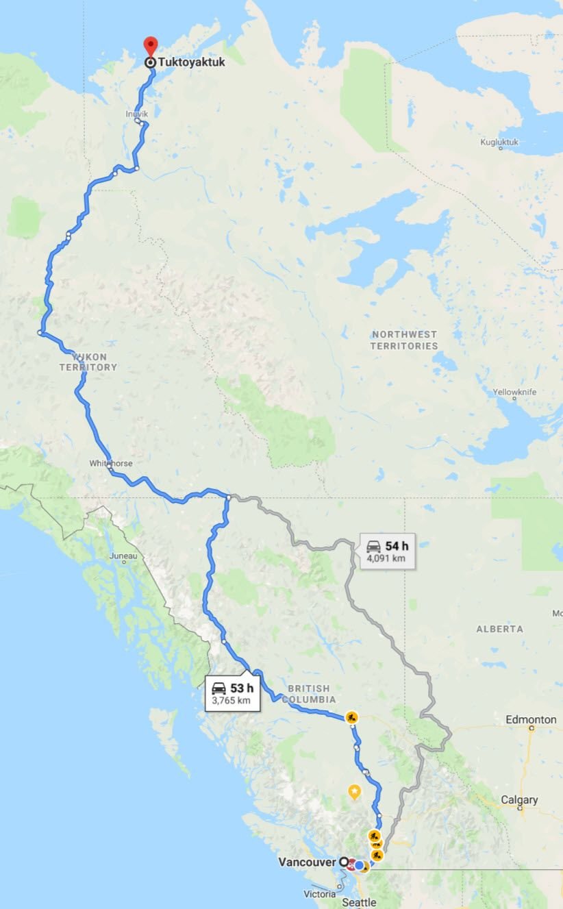

I am going to use this thread to cover the preparations I am doing to get ready to travel to the Arctic Ocean - from Vancouver BC.
The current plan is to travel north as part of this group Northwest Overland Society and of course representing my own group the Roverlander of BC . As a bonus it is the 30 year anniversary of the Discovery line.
If work does not allow me the time in late August even though I have put in for 4 months in advance, a possibility, my plan is to go solo in early August, now that it is in my mind.
The general route either way is :

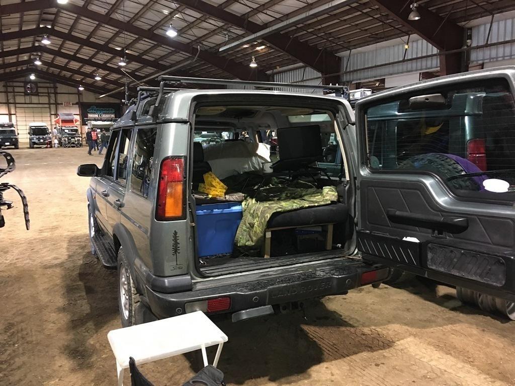

Here she is at the Roverlanders annual get together this year - this is my basic overlanding /camping setup which will get a bit of an overhaul for this trip
