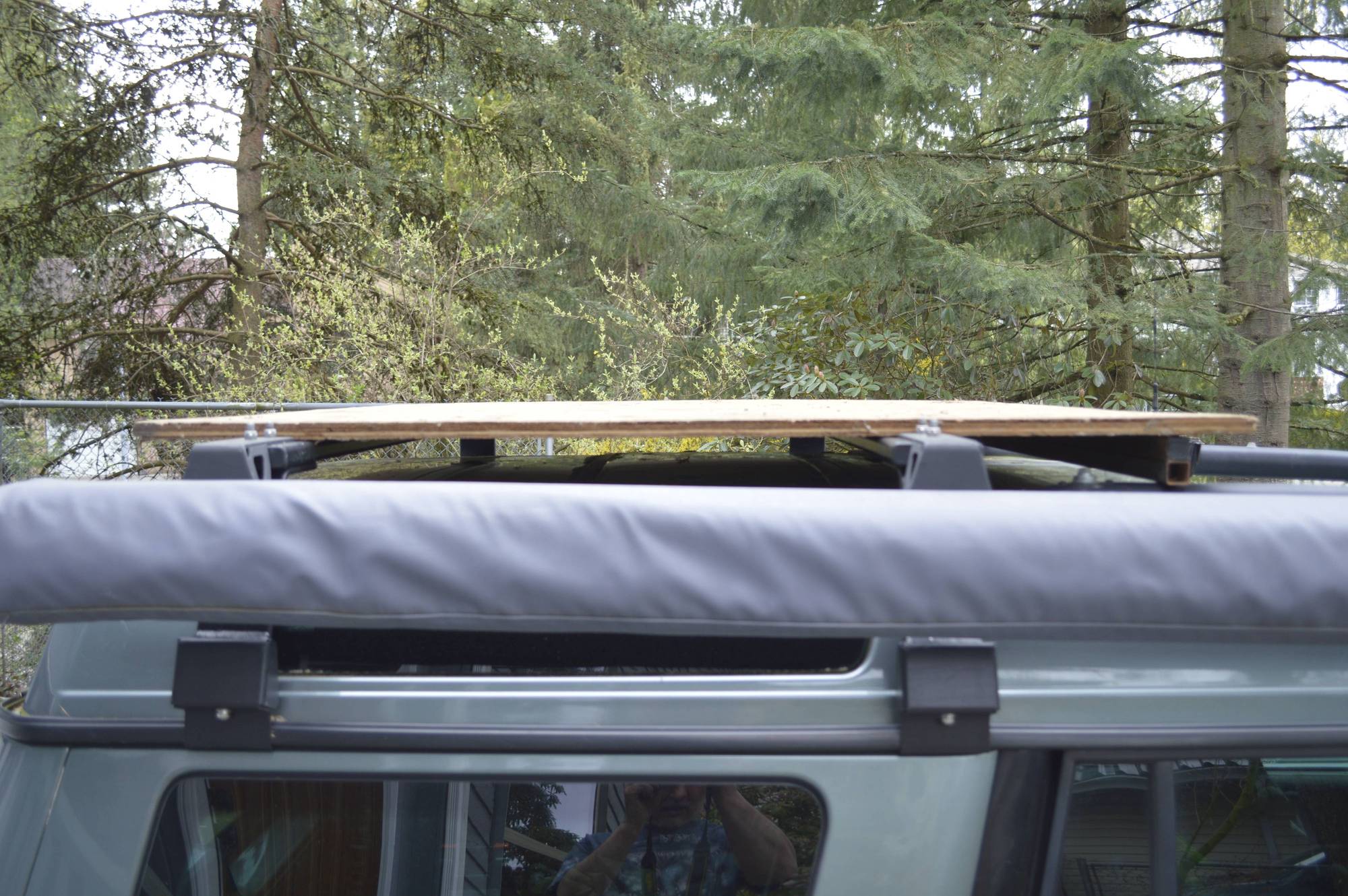

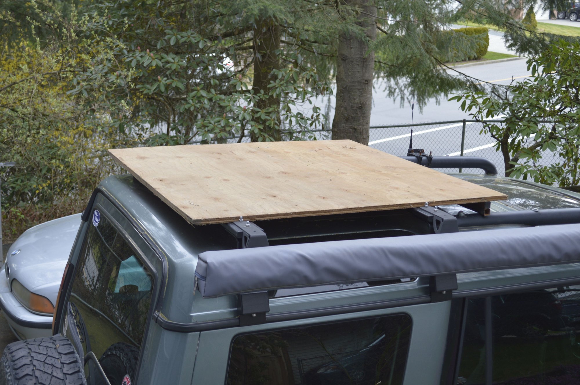

Well after driving the wife nuts doing my research and due diligence, with luck I will be picking up a Tepui tent tomorrow. I have a test piece of plywood up there right now and there should be no significant issues.
So 1st up a 48 x 50 piece of plywood to check general fit, the tent is 48 front to rear so that works pretty well, it is only 42 left to right so I am 8 inches wider on the plywood no biggy there.
You will notice an additional support mocked up at the front , the load for the stock roof rack is 110lbs so it will carry some of the load for the tent just fine. (the tent is 95 lbs)
All up with me and the tent the static load will be about 300 lbs, with half on the overhang of the tent. Each Front Runner bar is rated for around 220 so I am good there.
The rear most load bar will get moved forward a bit and the front load bar back a bit they need to be between 24 and 32 inches apart, right now they are 31. I am thinking closer to 26, for better spreading of the load.

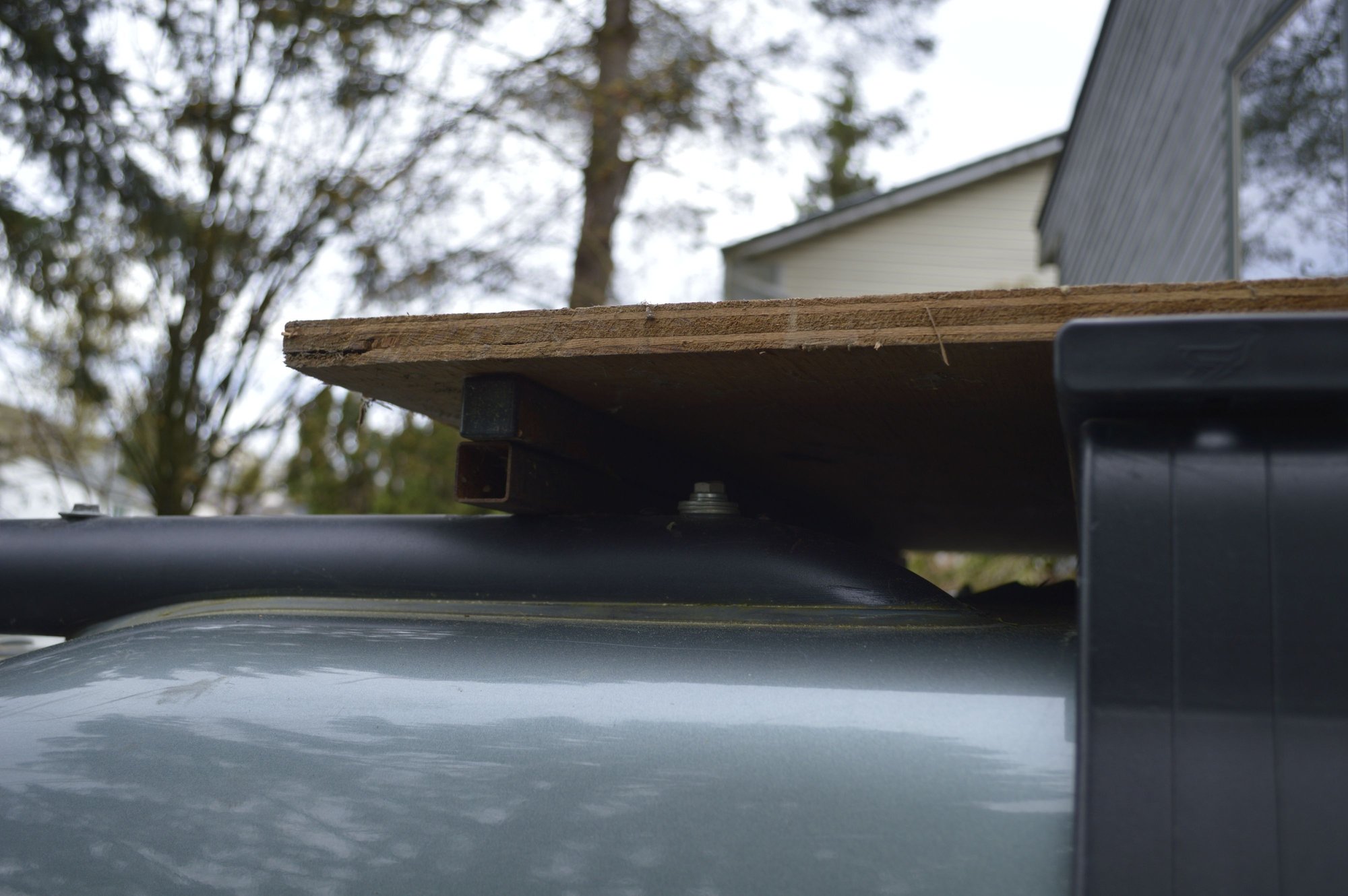

Just a close up of the test mount for the front, I am hoping to get a 2x2 square tube of aluminum for the front mount location. I wanted another Front Runner bar but that would have been nearly 300 CDN by the time it got to me. I can pick up a single load bar for a Delcia for 175ish CDN if I feel the need for more support
