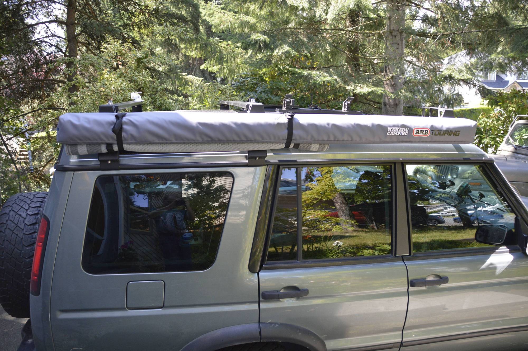

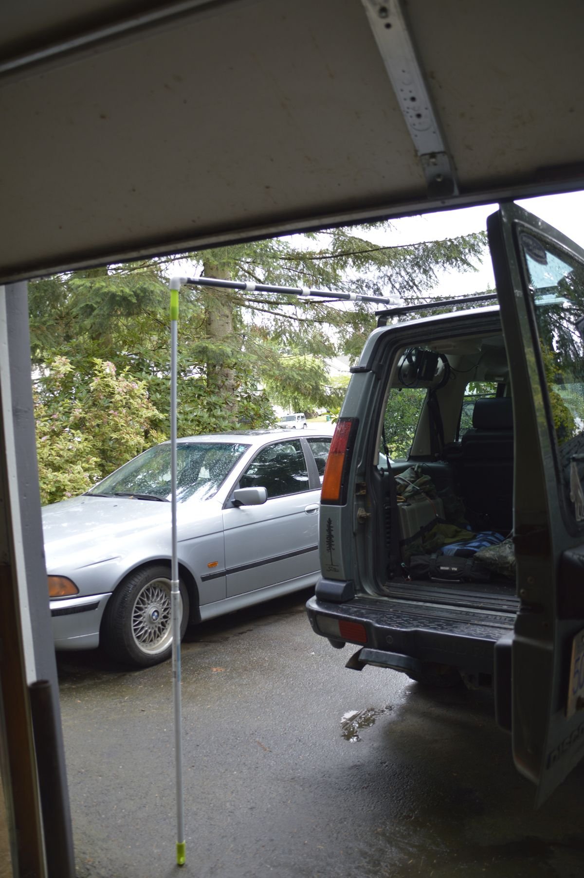

Rear awning/Rain cover
This was fairly high on my list I have an ARB awning on the passenger side but needed something for the rear door.
Parts list in CDN dollars
  • 18.95 Marine antenna mount
  • 12.00 3/4 irrigation pipe (total of 4 pieces) ABS/PVC
  • 8.00 Connectors and 90 deg Elbow
  • 10.00 Tarp - I already had this but for clarity
  • 8.00 Paint roller extendable handle

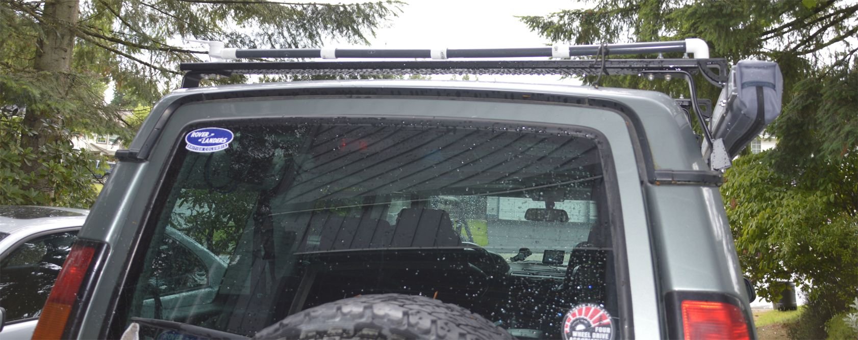

The marine antenna mount rotates through 180 deg and has 4 mounting holes. There are more expensive and durable options but I was not sure of the setup so cheap it is.
You could use 1/2 in irrigation pipe, but I could not find and step down adaptor, I find the 3/4 stays fairly level even without a down support
I have a Front Runner cross bar to mount to so that makes things simpler.
Here it is mounted - no tarp in the stowed position

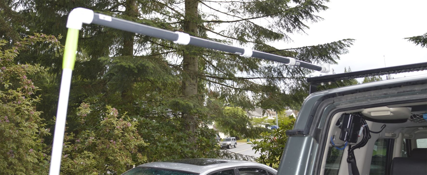

Extended with fancy paint roller extension vertical support
Extended full shot
Tarp over top for a test fit - note the current tarp will over hand the door window a fair bit - which is fine.
Being BC and summer as I got everything set it started to rain and I was thinking a bit of light rain is not too bad then it RAINED.
The intent is to roll the tarp around the outrigger and stow it that way, so a it is quick to deploy.
I will post images of the final setup.

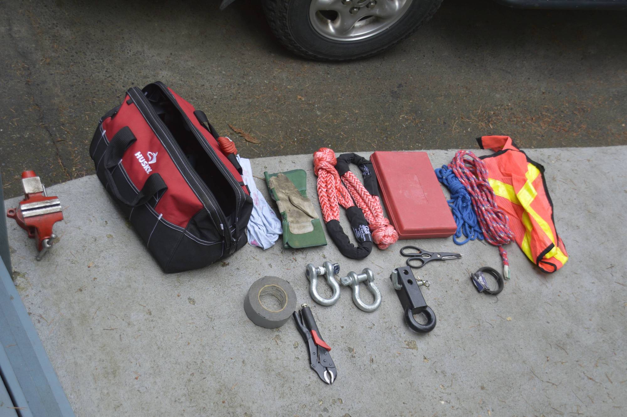

Recovery bag
Left to right
  • Bag and orange para cord
  • Rag
  • Work Gloves
  • 2 Large soft shackles
  • Tire repair kit - spare patches and plugs are in an ammo box
  • Misc lightweight rope
  • Safety vest
  • Duct tape
  • Vise grips
  • 2 hard shackles
  • Hitch adaptor for recovery
  • Shears
  • Bailing wire
  • Although not shown a bunch of zip ties
  • I have a Non kinetic recovery strap stored separately
Vice is not included, it just happened to be there. I store the recovery strap separately

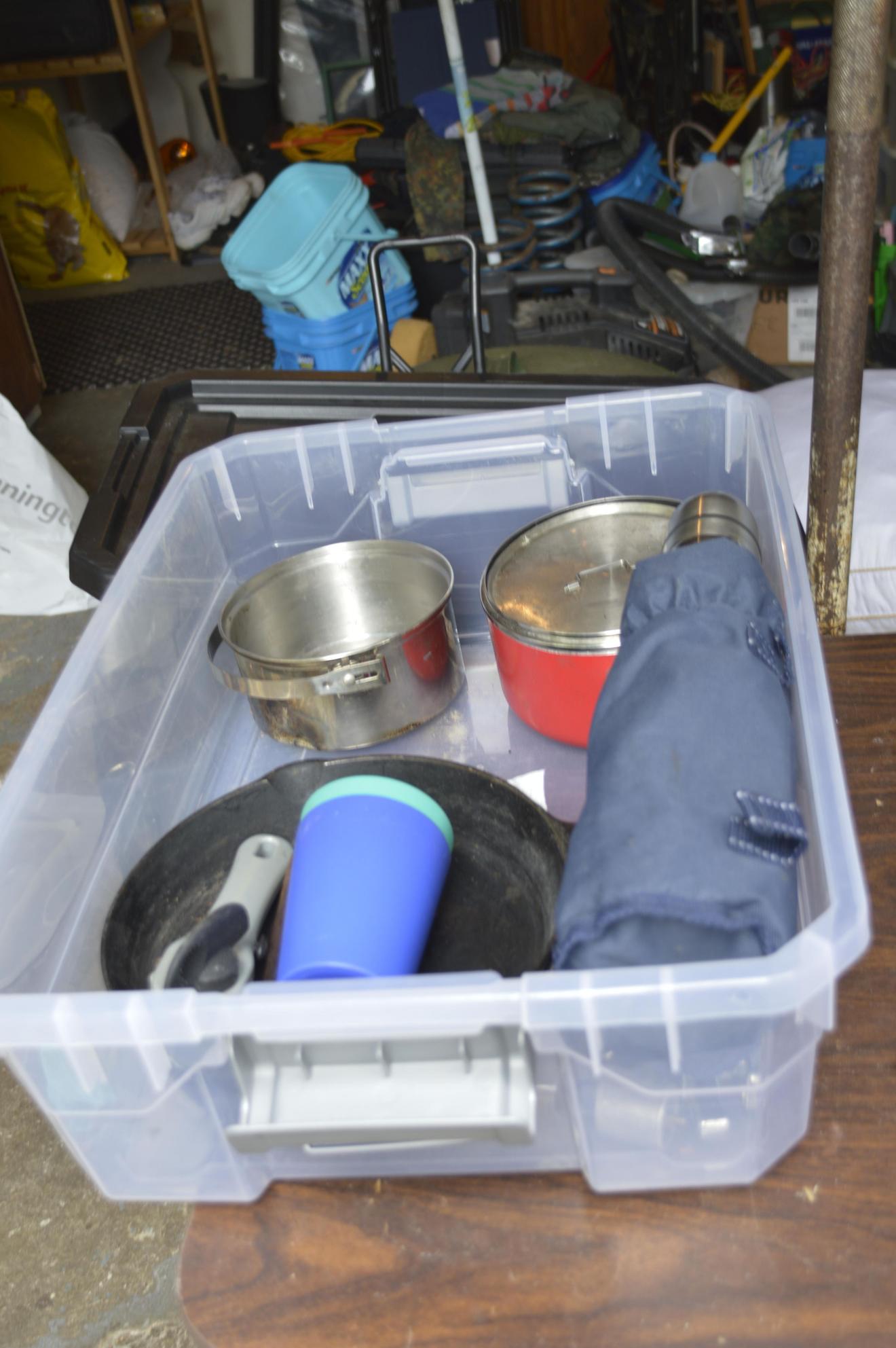

Cooking utensils - this bin goes under the sleeping platform at the back - yes the garage is a disaster area - spring/summer cleaning
  • 1 light duty aluminum pot
  • 1 larger pot
  • 2 cast iron frying pans
  • Can opener
  • 2 misc cups
  • Thermos in a thermos bag
Cooking utensils Bin 1
