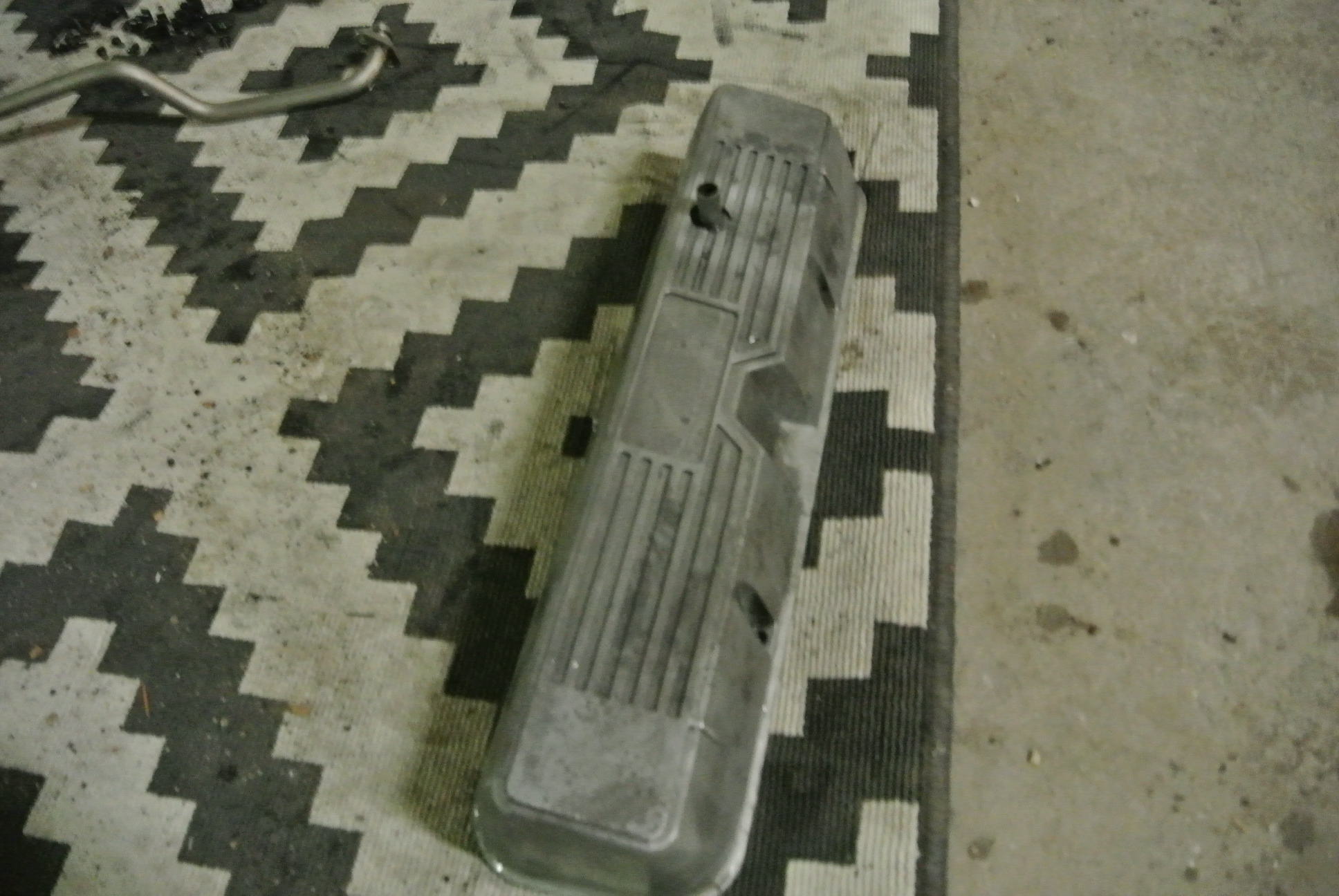

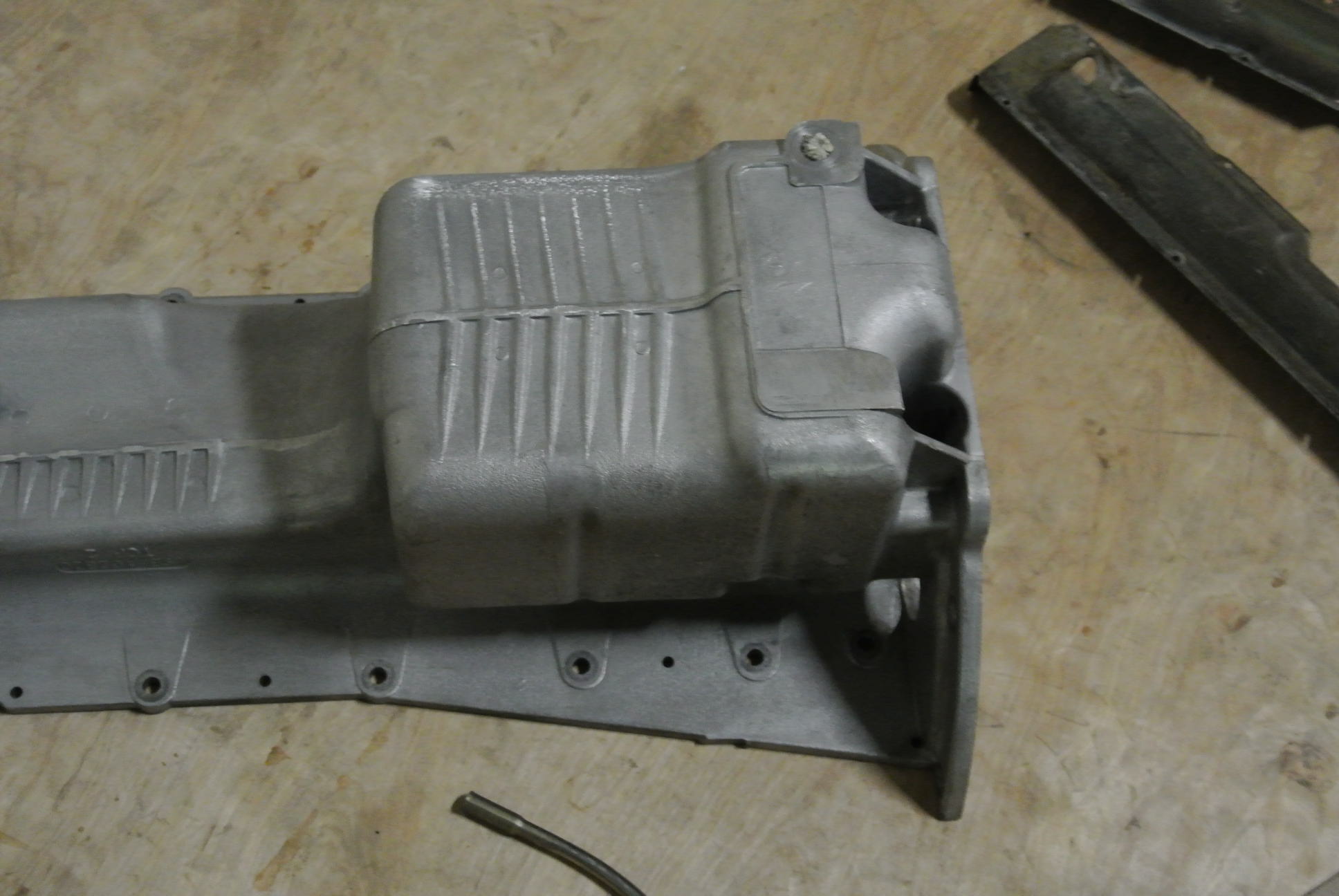

used grill oven cleaner to get of the thick gunk. elbow grease and a little $30 hf long shaft die grinder for the rest. yes i am painting everything white. not because i am fancy, but because i want to search and repair any leaks, before my engine becomes a big gooey mess. a case of vht white engine enamel.

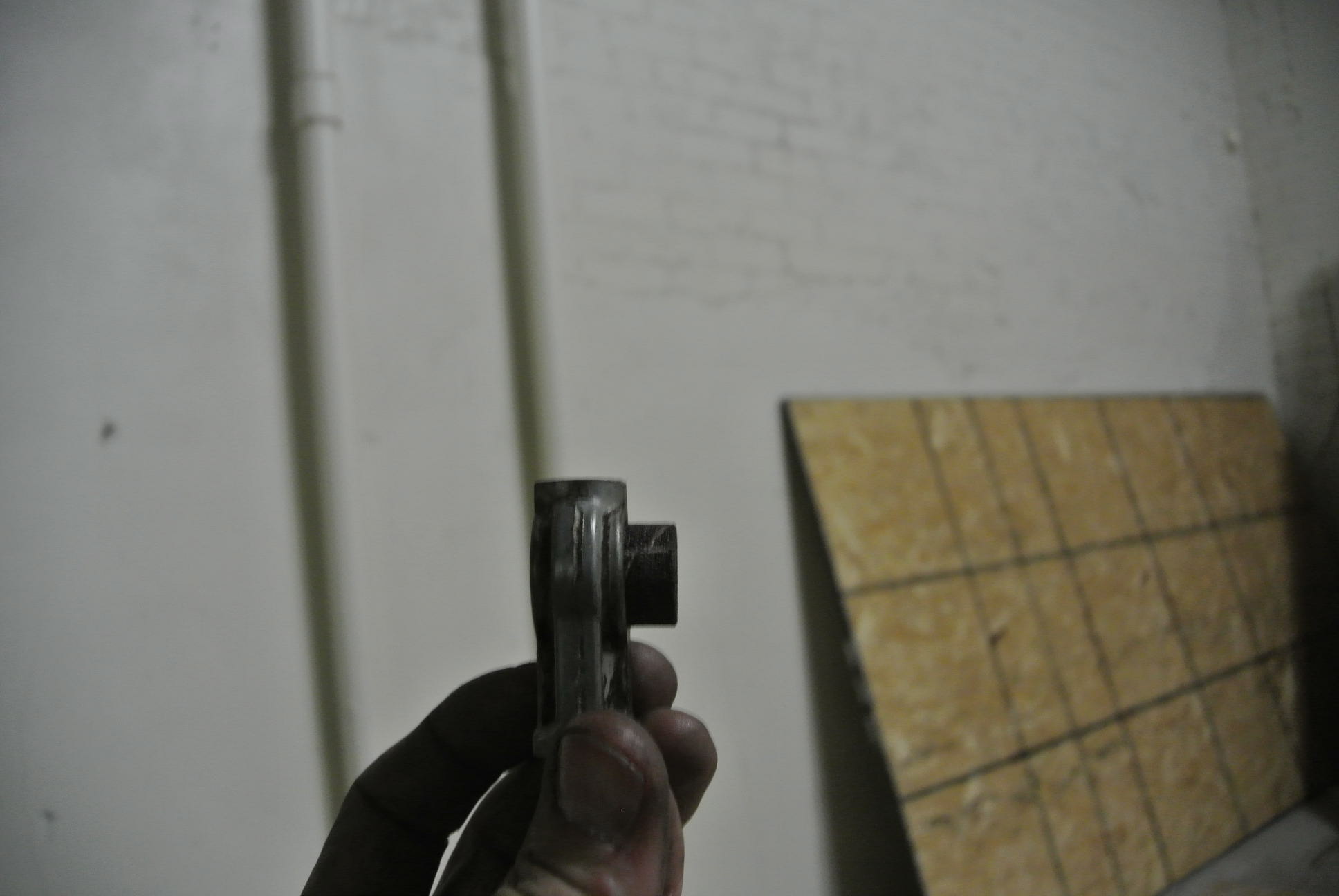

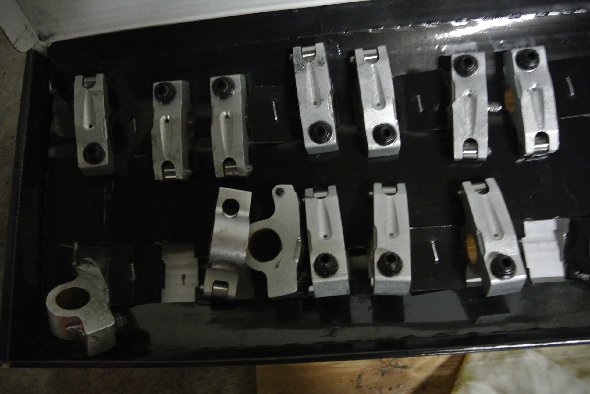

so the first real thing that i got to do was build the rocker shaft assembly.
i got some yella terra roller rockers from v8tuner. assembly was simple and straight forward. I got new shafts, springs and used pedestals. (currently making aluminum shims)
these rocker arms are designed to produce less friction and wear. they come with their own washer/shims that flank each arm. this is to achieve better alignment with valves and push rods. 1 on spring side, 2 on pedestal side.
the donor shafts that came with my pedestals, show why you don't reuse old shaft and components. pedestals were the only thing i was willing to use. i had to hand polish and true them up (they tend to slightly deform, a bit... i assume from use and clamping pressure). easiest way i could find was to turn barrel sanding rounds inside them worked great. I used the old shafts as a guide to make sure that they slid on perfectly, so that i did not scrape up my new ones.

You said you are making shims. Will you need shims for these rockers? Aren't they adjustable?

they appear to be also see i they will would with 5/16 pushrods instead of the 1/4 stock ones.
