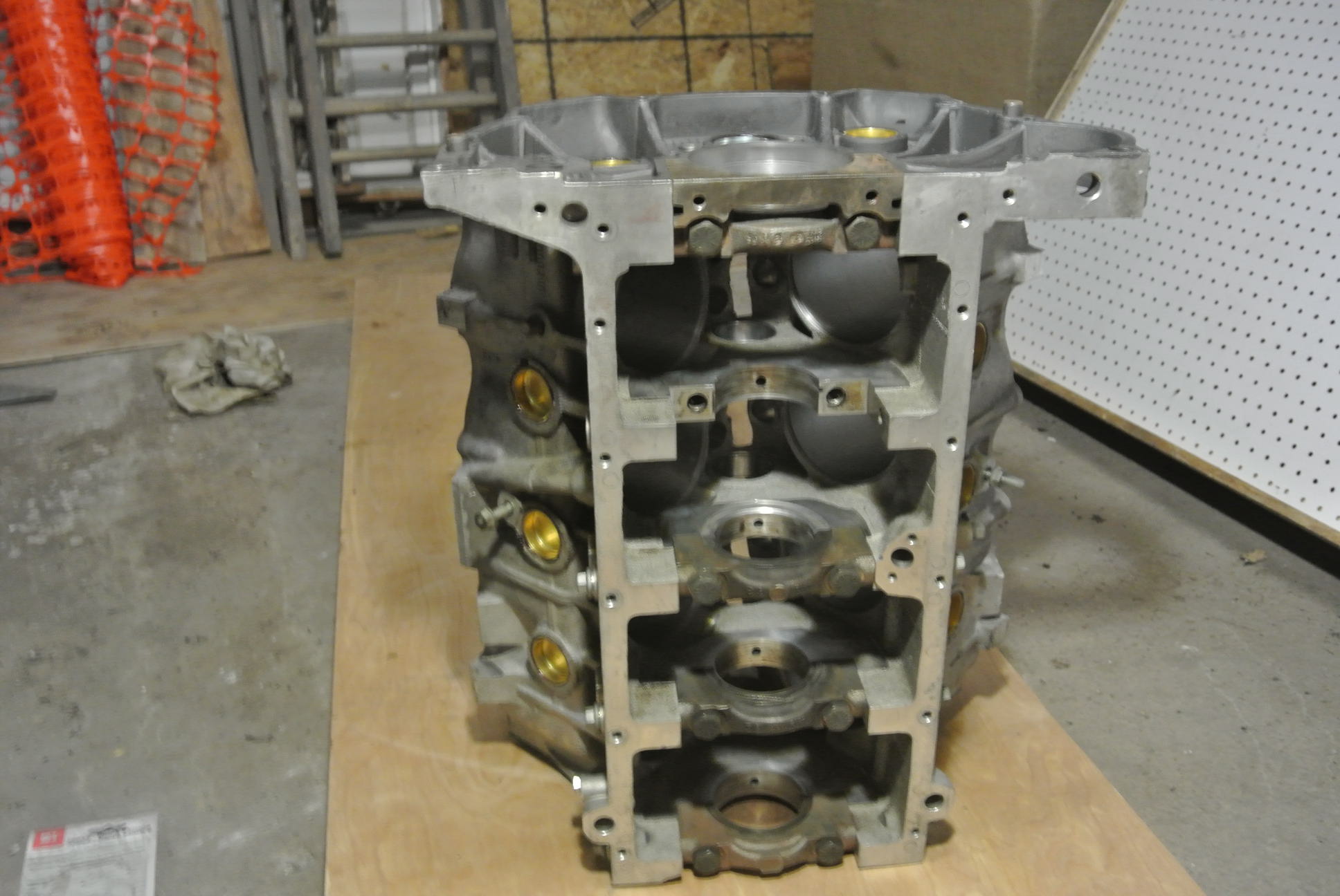

more bits and pieces rolling in.
block, 1 head, crank, a couple of pistons.
block looks good, hats and new freeze plugs.
head looks good. the shop did a nice job fitting the bigger valves and springs. port and polish looks decent. a couple of places on the exhaust side, I will probably hit again (couple of little boogers, no big deal). so far so good. hopefully I will get some more boxes tomorrow.
off to find some friggin 3/8 bolts. I have every length in the world, except what I need to put this thing on the stand
Attached Thumbnails 4.6 engine build-dsc_3541.jpg   4.6 engine build-dsc_3540.jpg   4.6 engine build-dsc_3539.jpg   4.6 engine build-dsc_3537.jpg   4.6 engine build-dsc_3538.jpg

it looks sweet all hot tanked and decked up, i assume you had the cam bearing done. what are you using for a rotating assembly?
