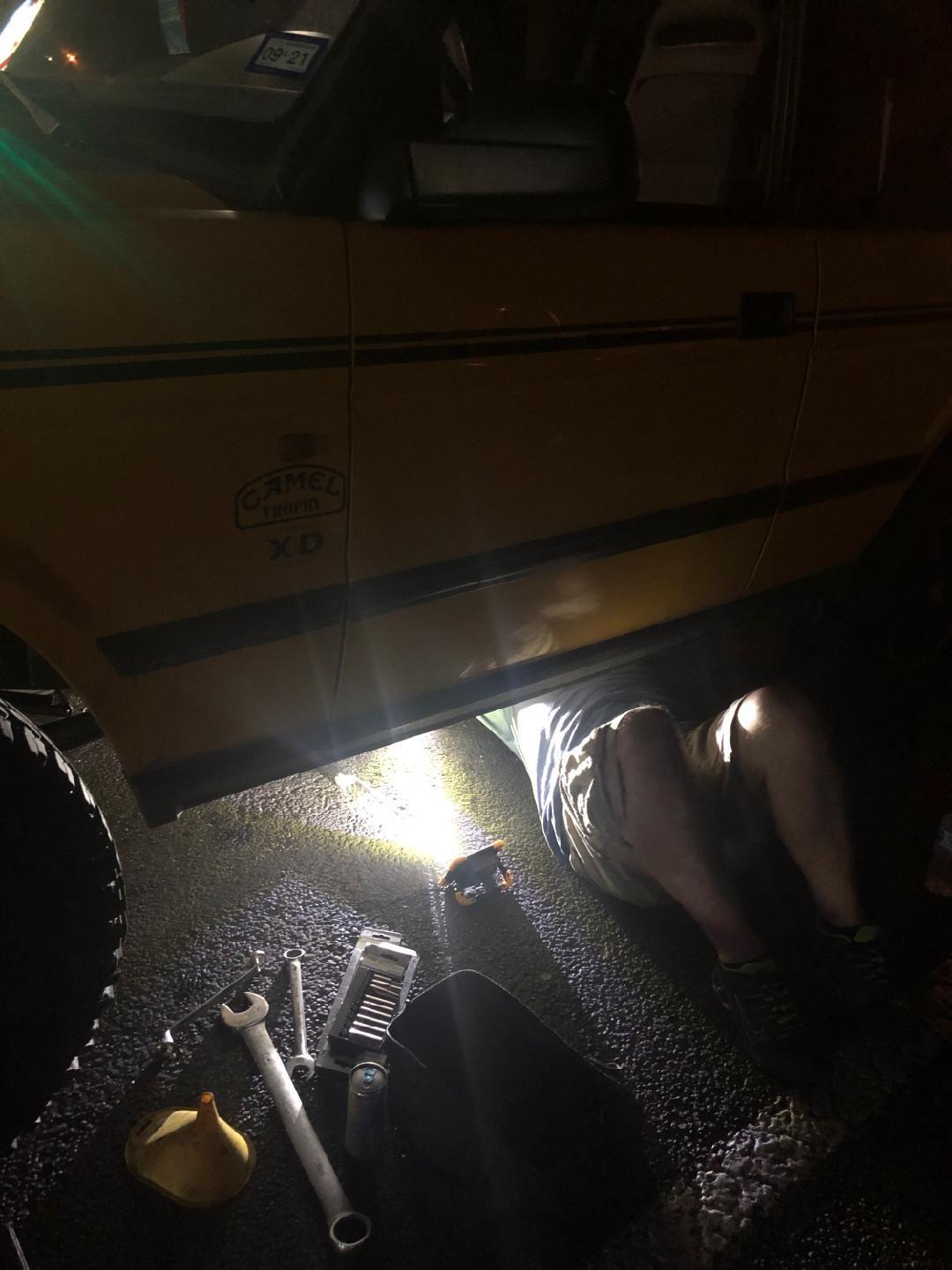

I had just made it into Austin when a grey RRS pulled up next to be beeping & rolling the window down. It was my best friend from Austin Roverworks! He said he'd see me tomorrow so he passed me up & at that moment the XD literally exploded!!!!! White smoke/grey smoke was gushing out from under it & as my friend exited he was looking over at me and I read his lips to something along the lines I think you're on fire!!!!
I pulled over ASAP & my friend following me pulled up behind me. I got out popped the hood and the dang radiator from china had died at AT cooler sending all my AT fluid out and onto the drivers side cat.
Austin Roverworks buddy got me hooked up and I went and grabbed the parts I needed. We did the repair ASAP & I finally made it into Marble Falls at Midnight. With "just" a 3.5hr delay lol.

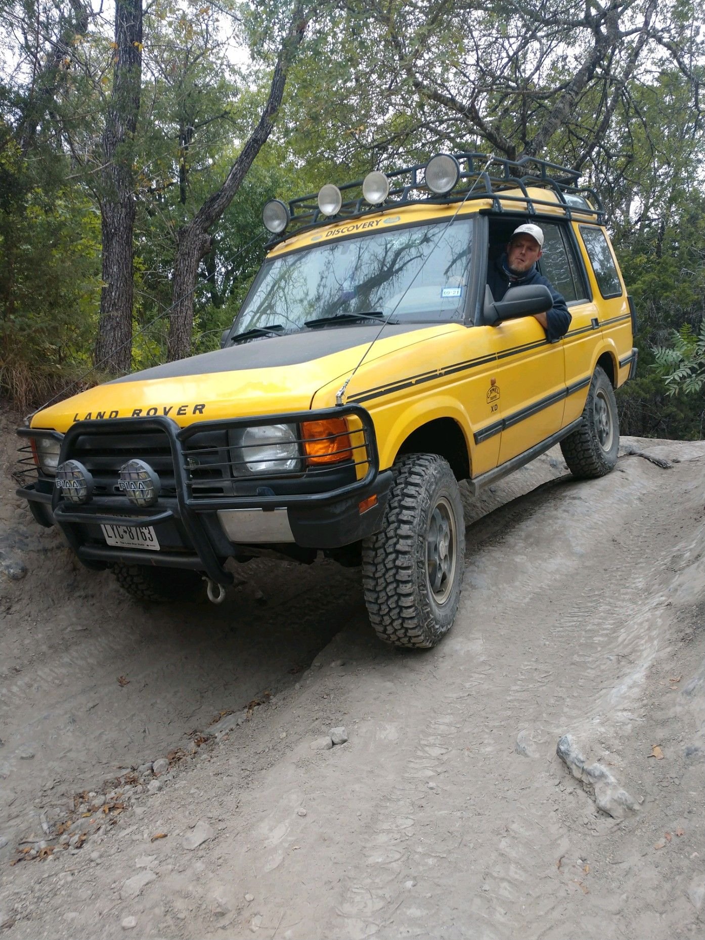

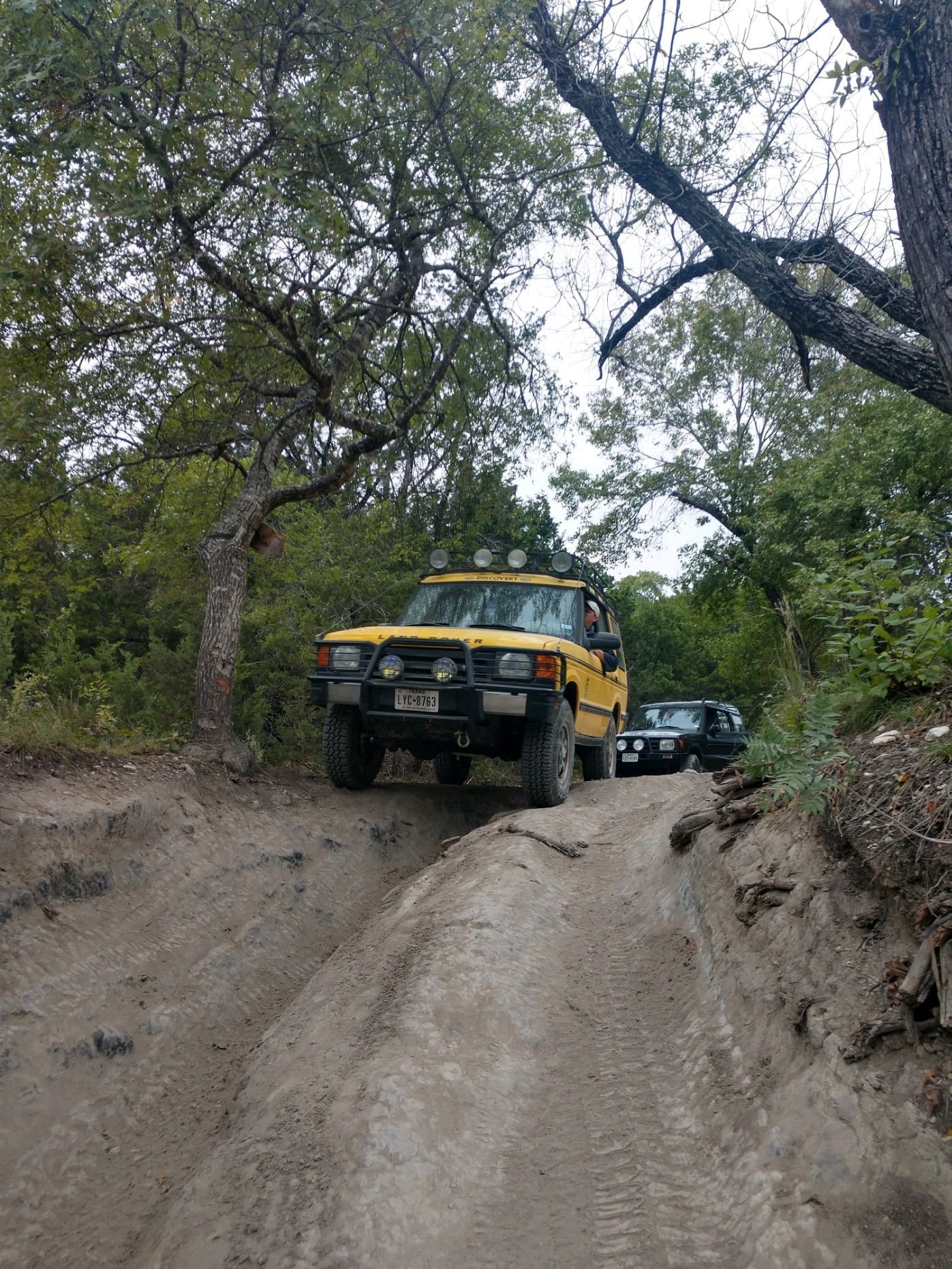

A few pictures from the 2020 HCRR Event. This was the first time I got to put the Korean Thunderer M/T tires thru their paces. I never even aired down and I hardly spun a tire even totally off camber with just 2 wheels on the ground. XD did extremely well out on the trails. Rear Spring retainers kept my coils in place and it flexed really well with zero rubbing.
