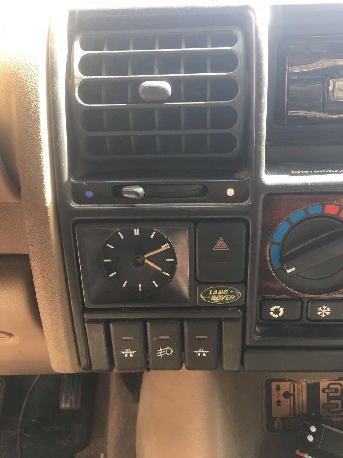

I messed around with it today & I was told by the previous owner the AC hasn’t worked for the last 6 years. I figured I’d tinker with that as AC is kind of important in SETX. I started with the basic stuff, R134A present in the system, fuses good, then I never had 12v at the compressor. The blower switch was SUPER flaky so I went ahead and pulled the center dash bezel. I used the rear AC slider out of a D2 rear air switch, then I slapped in the D2 rear A/C on/off button as well. I went to test it & my blower now worked on all 4 speeds, and the AC kicked on!!! Of coarse the idle went nuts trying to deal with it (still messing with that), but that AC is ICE cold!!!!! All because of a dead switch....
While I was at it I installed my 95 RRC Analog clock, and I removed the broken cubby on the opposite side & installed the 6 multi-switch pack from a D2. I’ve got 3 blank plates so I just need 3 more. Then I’ll have a spot for future switches.

The switch blanks I need are for the 6 switch pack mounted on the center bezel where HDC, emergency flashers, rear defrost, front defrost, SLS, and the fuel door (03-04) are. On a D1 it’s a tiny cubby pocket, and on the XD it was trashed so in it’s place I installed the D2 6 switch bezel. That way I can add additional switches later. I did pretty good and scored 5 out of 6 lol. The HDC switch is latching so I might leave it.
I know the wood HVAC control doesn’t match a thing on an XD, but it sure beats what it came with!!!
