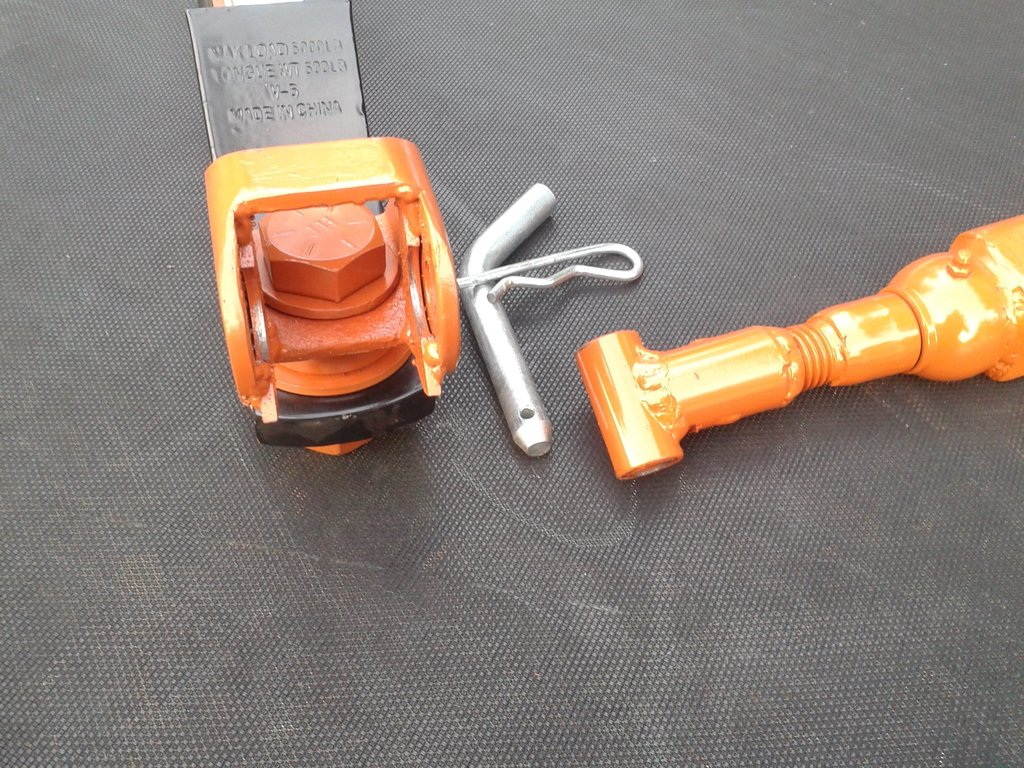

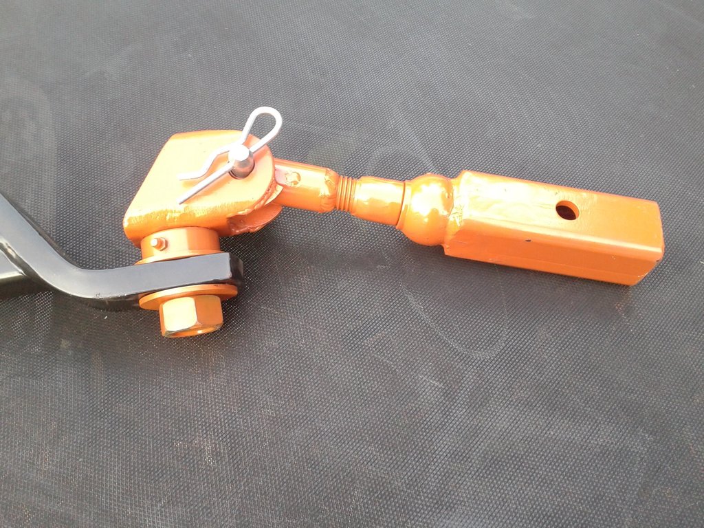

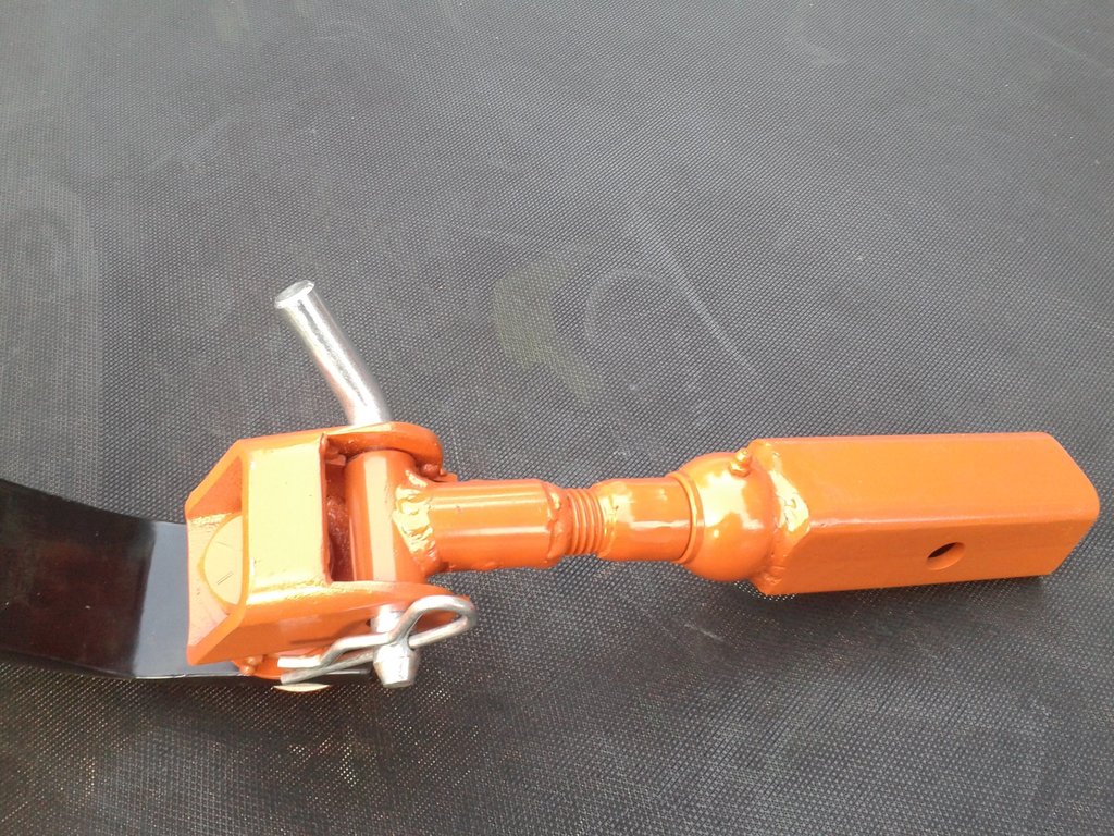

finaly finished the 3 axis off road hitch for the trailer, found the directions on the tventuring web site

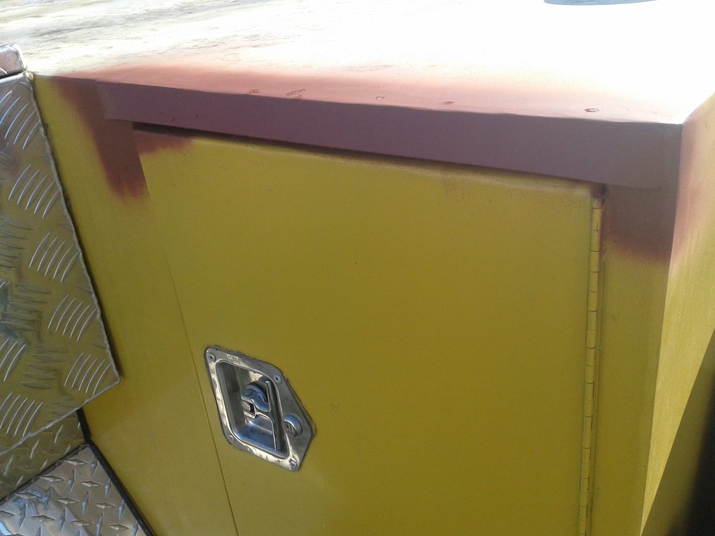

Well had a setback , more of a issue I expected, my wife opened the back door and found the trailer full of water, all our camping gear soaked ugh, called me so I had to drop everything and come home, empty the trailer, dry it out, shove my son in it and hose it down, just as I thought, the gasket on the read door failed and I never put a gutter over the doors so water ran off the roof and in the trailer
Solution was simple cut a few strips of 16 gauge and welded them on over the doors so the water runs off need to snap a pic but testing shows it solved the problem

sounds like an easy fix. that trailer hitch is something else

Here is a poor pic was a simple fixName:  IMG_20151207_114445_zps9b0ptroh.jpg

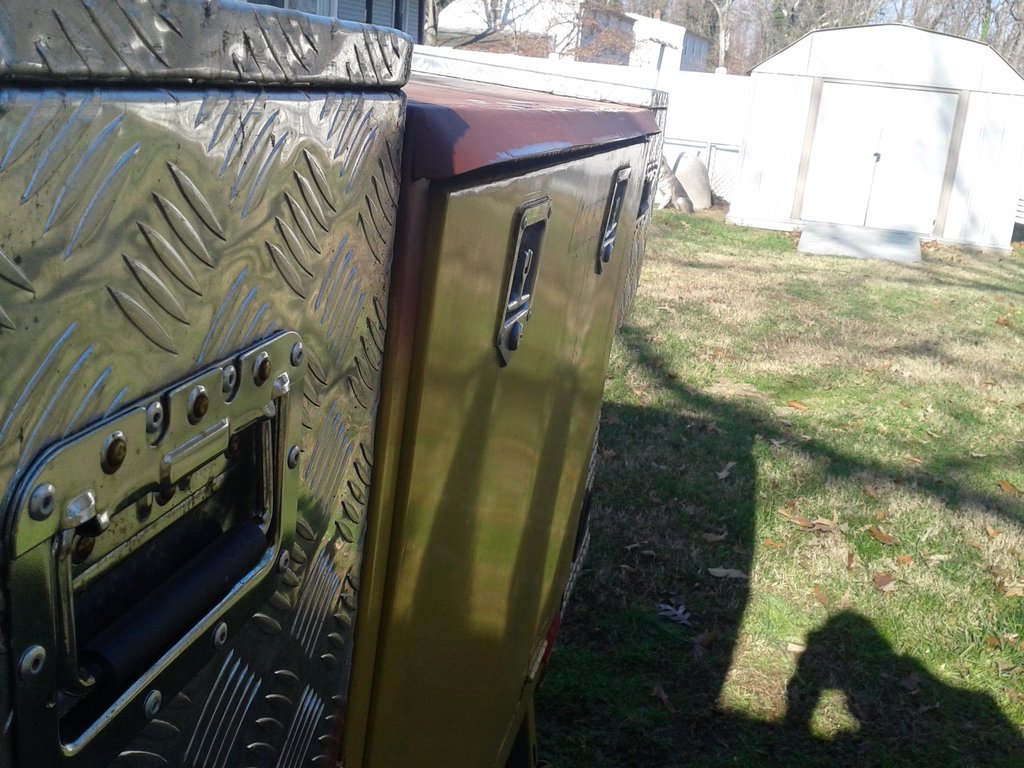

No leak on the side door but did the gutter anyway
