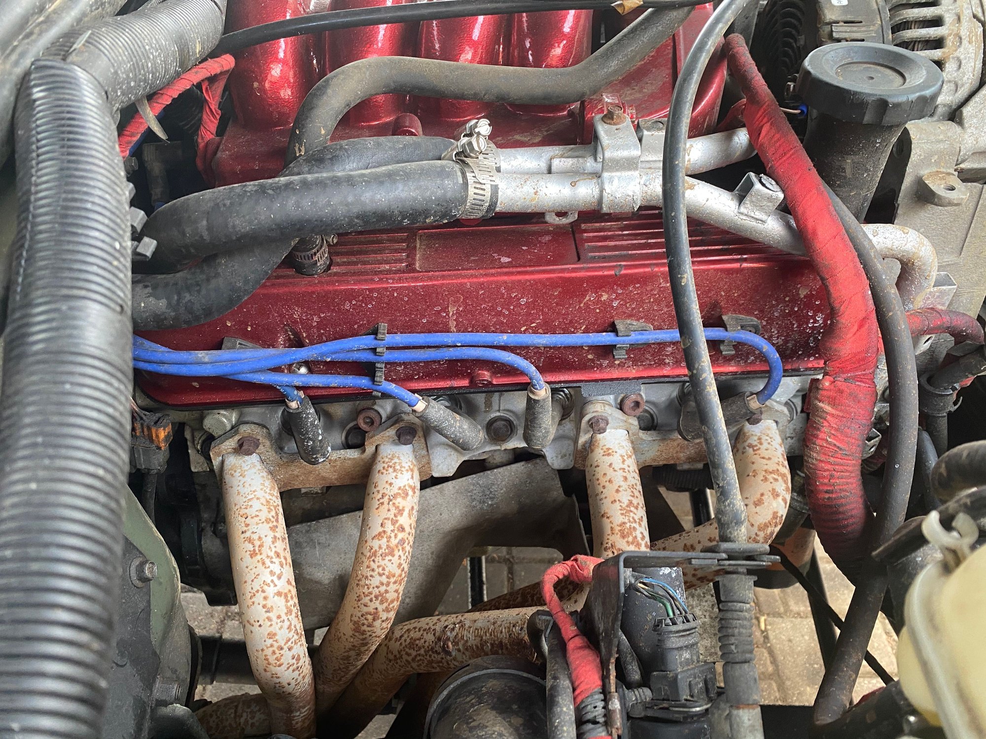

Condition of my headers after there first winter

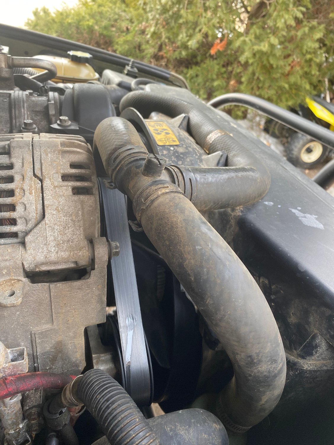

Found my slow coolant leak. That was a brand new britpart hose assembly I used when I installed the motor last summer.
I guess for using a spray can paint there not horrible considering how much salt hey use on the roads around here
We had a nice day out yesterday here, snow is melting, so I checked Under the hood to plan some upcoming maintenance. Have both coils, new plugs and wires, upper intake gasket, and front main seal on there way. Will probably do the thermostat mod as well.

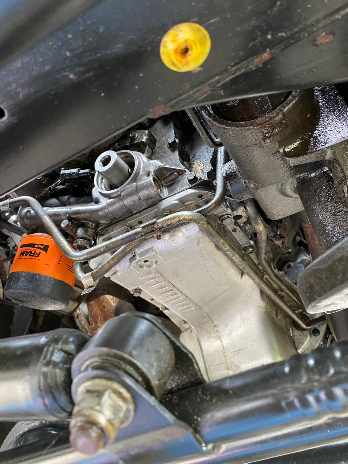

Finally changed the front main seal. While I was in there I noticed a power steering hose seeping. Ordering more parts. Lol. Never ends

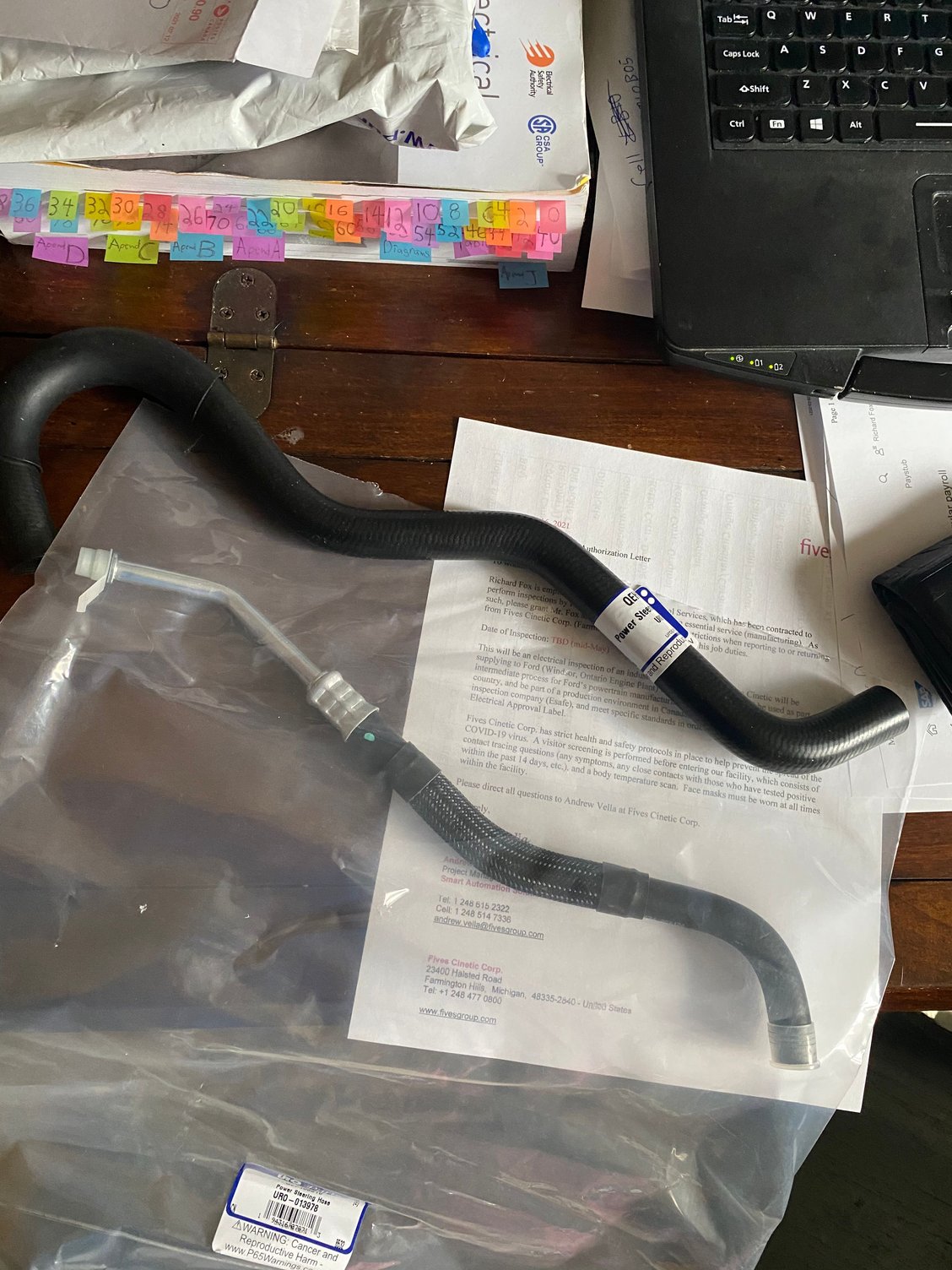

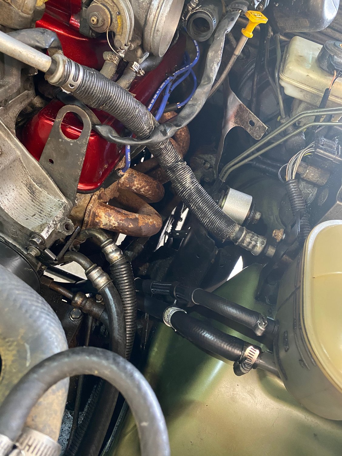

New steering lines put in today, thinking I may have to order a new pump now. Lol. It was so messy I couldn’t tell if it was the pump or the hose. This was a used pump I put in last year or maybe 2 ago.

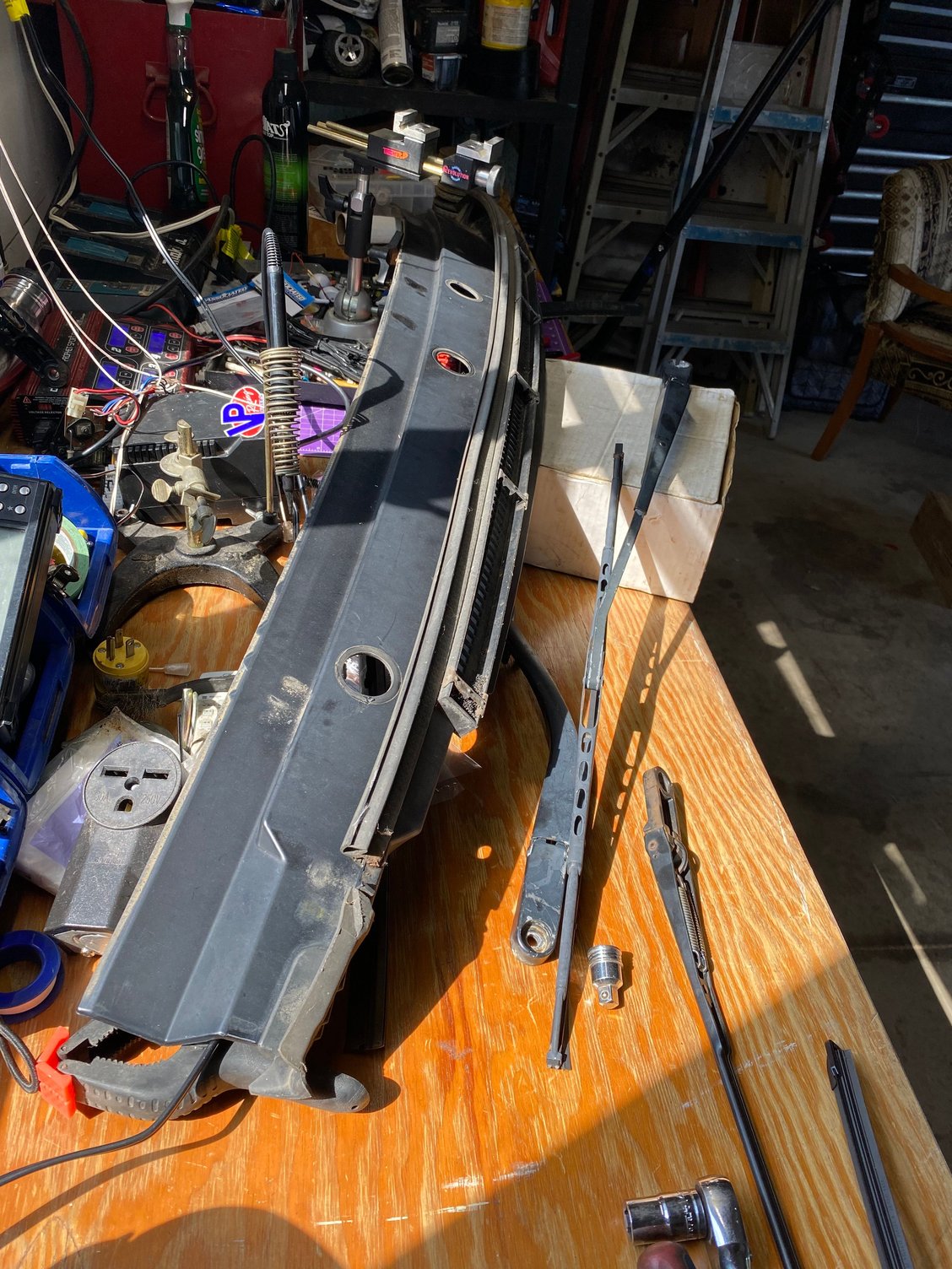

Well the used pump has been fine, hardly any steering leaks now, front main has been good since I changed it out, now about to change the cowling for a non cracked one and fix my wipers as well
