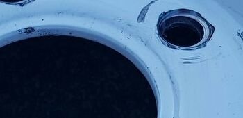

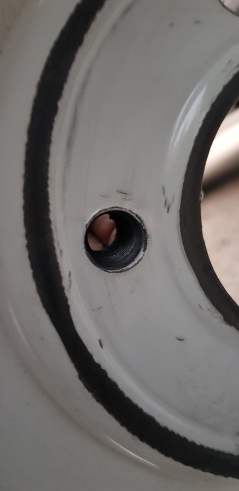

The small end of the cone should fit inside the stud hole on the wheel. The cone centers the stud in the hole while keeping it tight. Time to whip out the tape measure and see if the small end of the cone is bigger or smaller than the stud hole.

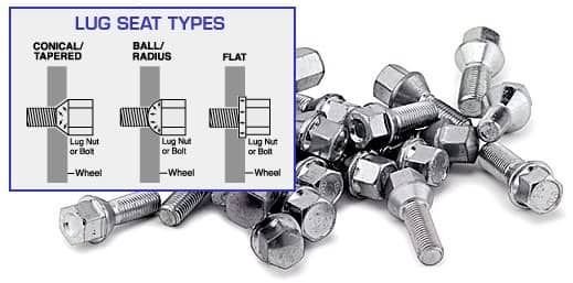

All the steel wheels I've ever messed with = always had a very visible ring around the lug hole which was for the "conical seat" type of lug nut. Like Fish said take a wheel, and sit a lug nut in it. You should be able to tell which type it takes very quickly. His attached image is a very good comparison of the 3 most common types.

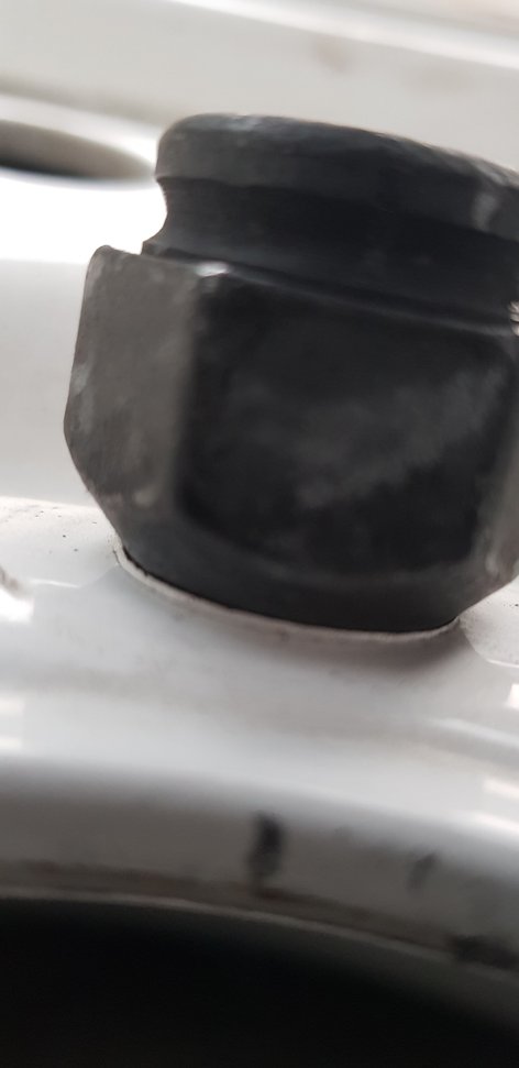

This pic of yours is very telling though. You can see where the taper of the nut mated with the stud hole.

I don’t think the question really needs to be which lug nut P/N works, but more like what lug nut seat does the TF rim use. Conical, Spherical, or Mag type (flat). Then you could easily get any brand say for example Gorilla 14x1.5 threaded lug nuts with the proper seat and be done with it.

In the close up of the rim without the lugs installed it was pretty evident the "damage" to the rim is that the lug nuts where torqued off center from the stud hole thus putting a nice off center impression in the steel. I don't know what you torqued the nuts down to but DII alloys are 103 ft/lbs and P38 alloy and steel spare are 80 ft/lbs. Now that there is an off center impression in the wheel it's gonna be tougher than a Nor'easter in 20' open wooden boat to get the nuts to line up with the studs. My son used to be a wheel jockey at a local shop so I asked him about your problem...... your hosed. Should've used a hub ring of some type to center the wheel and then tightened the nuts enough to center on all five studs then when all are centered torque in a star pattern to final spec which I would've gone with the 80 ft/lbs first since its good enough for a P38. A removable hub centering tool of any type would've done the job like a short piece of exhaust pipe that fits the unit bearing pilot and the wheel center, even a plastic hub ring on backwards to remove after the job was done would've worked. You could try a 60* taper to ream a small lip on each stud hole and use the smaller nuts (if they'll seat inside the hole). I don't know, this is a mind blowing issue for me, I've never had a problem so far in I couldn't back up. Also as far as your wheel weights being on the inside/outside of the rim it doesn't matter, the machine was programed with the tire width so it doesn't matter. He said they should've done stick on rather than clip ons because you can glue em closer to the wheel center but that's already gone by so your wheels should be good enough to not cause vibrations, bottom line.

You can see in this picture, that the larger lug nut was making its own tapper (and off center, because of poor installation...and not trying to be rude, just truthful). Look closely, and you can see the original tapper of the lug hole farther down in the rim hole. These rims are trash now.
You can clearly see that your larger nuts did not fit down into the tapper.
Question, when the tire shop originally mounted the tires on the rover, with smaller lug nuts...did you have a vibration at 45/70 mph? Or did it develop after installed larger, supposedly correct, lug nuts? I've gone back and read most of your comments, and l'm not seeing any mention of vibration...until you...changed lug nuts to larger style (so, you could use plastic covers). So, in my mind...and by looking at pictures...the smaller diameter tappered lugs were "more" correct than the larger. Granted, you didn't get them centered very well...but...being larger to begin with...it may not have been possible to do so. Have you tried using the smaller lugs again, like l suggested a dozen posts ago? If you did, and you still have a vibration...then...most cettainly...the rims are junk now.

The ANR4851 lugs in no way shape or form fit inside the lug holes of the wheels. Not when the wheels were brand new and not now. Yes they kinda have a cone shape on the bottom but even that part of the lug not is too wide to fit inside the lug hole. The bottom of the lug nut simply rest up against the outer perimeter of the lug hole and that's that.
