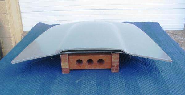

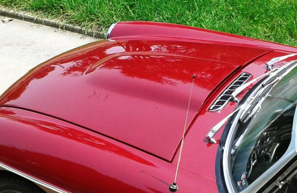

Putting in a order for this as well, it should solve the clearance issues
Attached Thumbnails It's not a Rover build thread, MGB with Ford 302 power :D-rv8-hood-5.png   It's not a Rover build thread, MGB with Ford 302 power :D-img_6845.jpg   It's not a Rover build thread, MGB with Ford 302 power :D-img_6846.jpg
