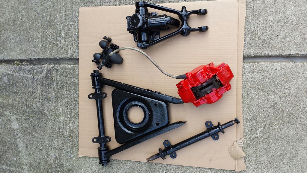

He cleaned a bunch of parts up and prepped them for paint. Also freed up a few frozen bolts. So progress is still happening even though I'm stuck at work. He plans to paint all the parts tomorrow. Going to have to put the cross member back in incomplete though since it will be the better part of a week before a few of the new control arm parts show up.

That will teach me to say if your bored throw a splash of color on the calipers.

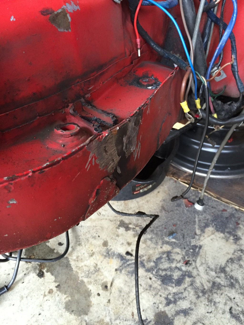

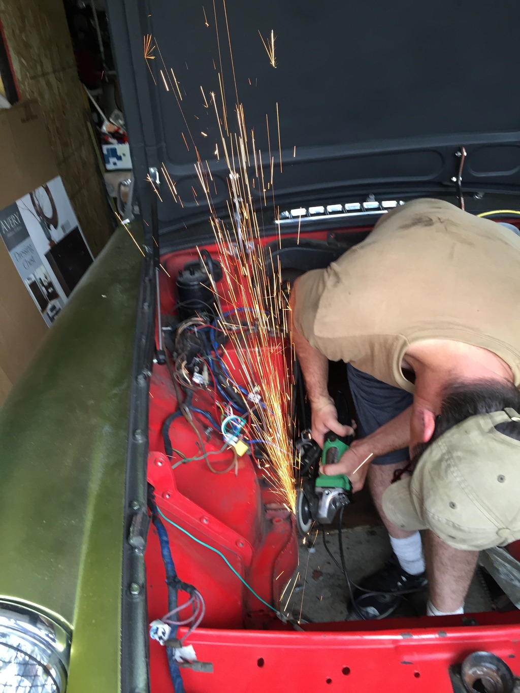

All the rest of the bits have been painted. Got to work in the engine bay. Got the tranny tunnel upper ridge clearanced and cut out the motor mounts and ground it down. Got the wiring pulled labeled and out of the way for paint. Have a bit more to remove from the bay and it will be ready for paint hopefully tomorrow.

And just so you don't think I do nothing but take pictures.

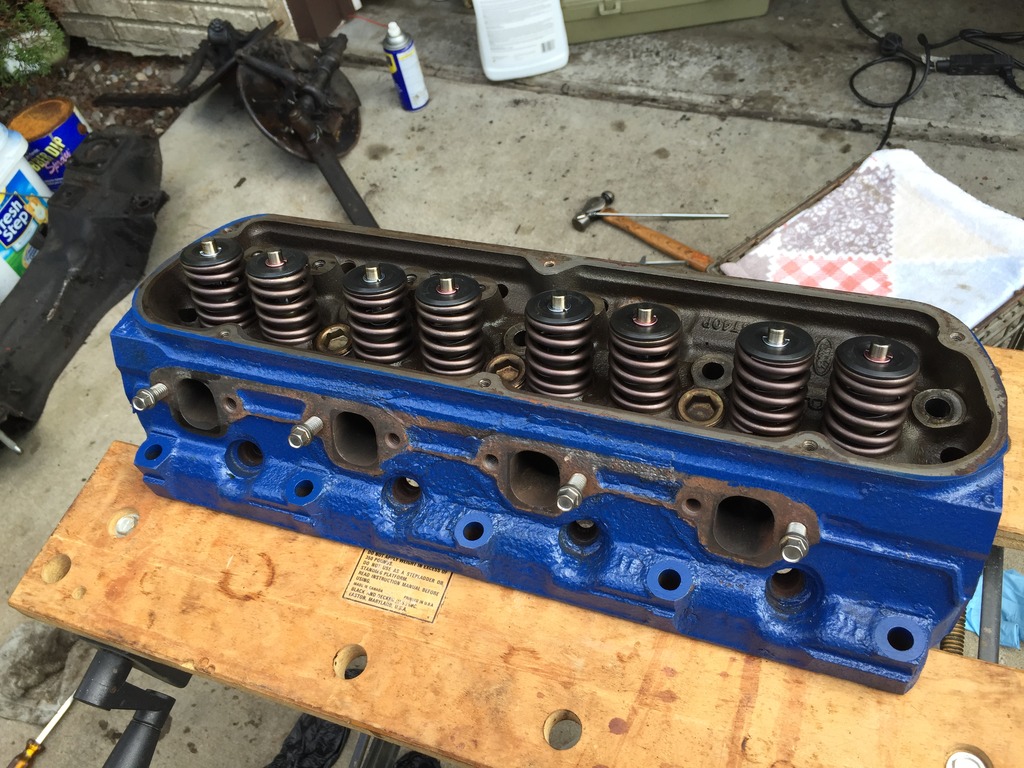

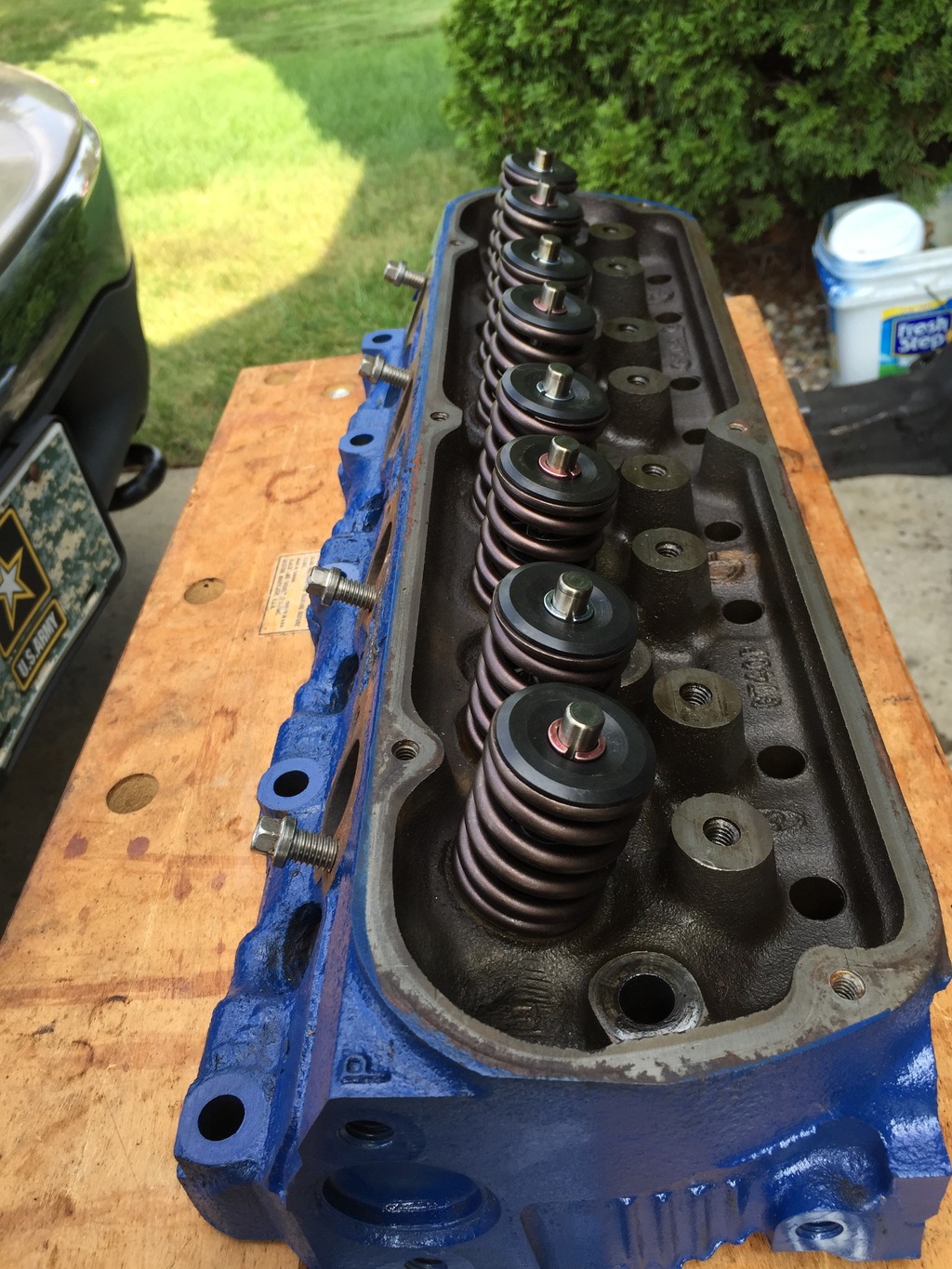

That machine shop wasted my time line and either is incompetent or criminal. So today was spent changing valve springs, and seals. Wasted quite a few hours thankfully the head bolts are not torque to yield and they had a set of quality head gaskets they gave me since my others had already been installed. So a lot of time was spent doing things that were already supposedly done.
