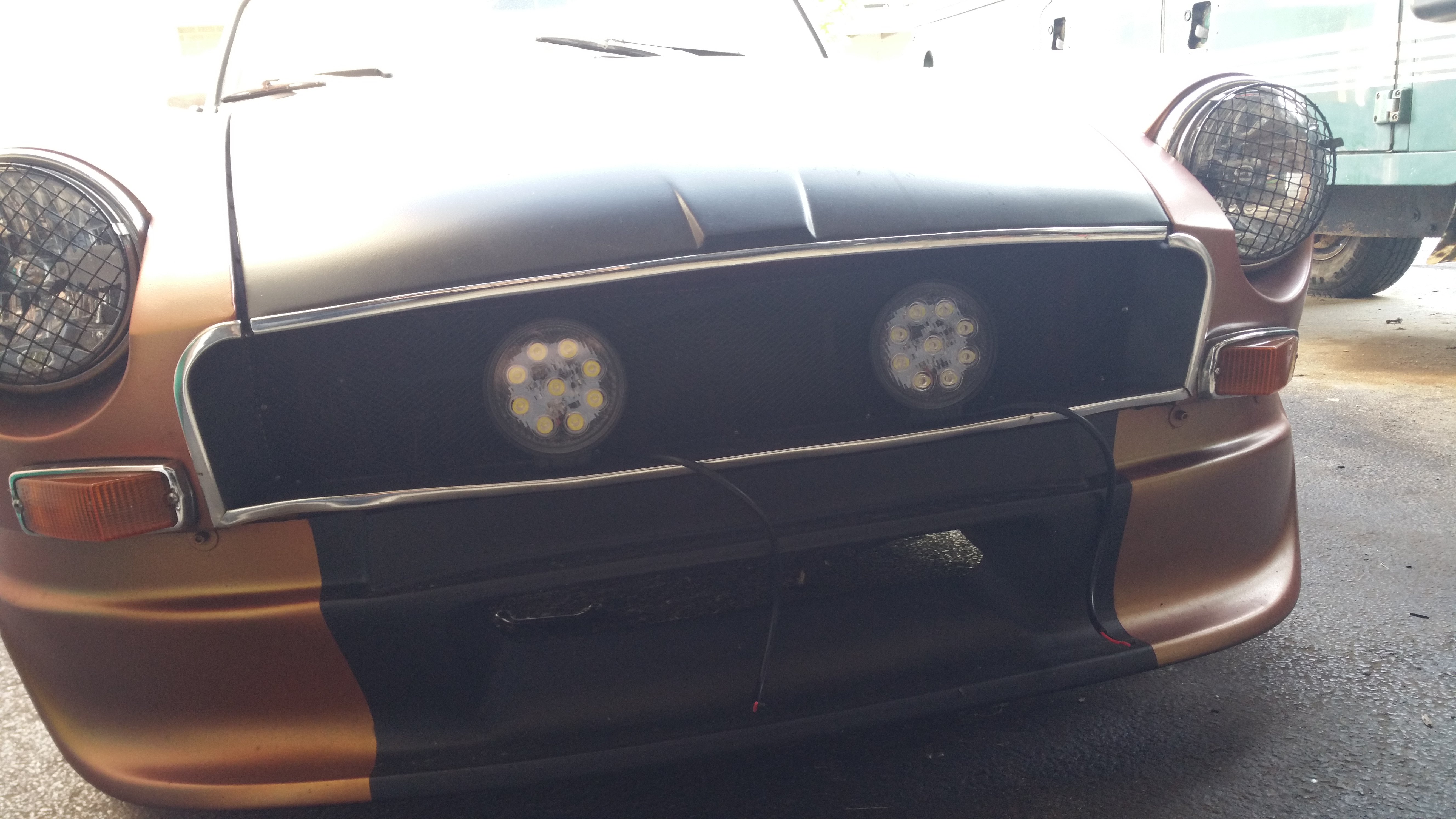

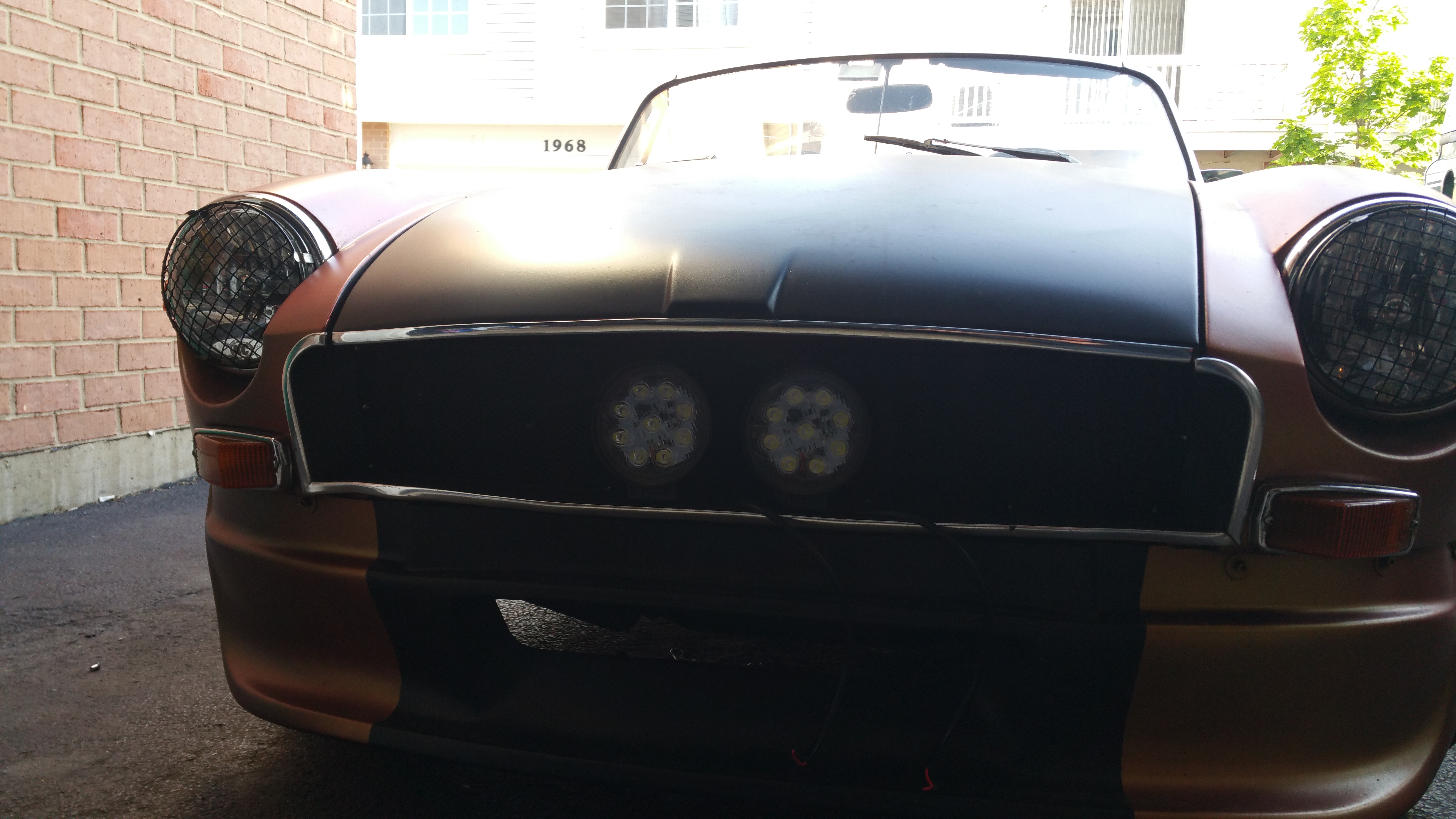

Picked up some LED Driving lights plan on putting them flush into the grill and they will bolt in behind it for a nice clean look. Light output is 1900 lumens so might be able to drive with them instead of headlights lol.
The question is where to mount them.
Center, Middle or Outer Edge

Old Jun 7, 2015 | 06:35 AM
  #84
ihscouts's Avatar
Joined: Jan 2010
Posts: 4,245
Likes: 402
From: Traverse City MI
You have a dilemma....... all three look good. Where do you want the most light at night?
Old Jun 7, 2015 | 06:59 AM
  #85
TOM R's Avatar
Joined: Mar 2009
Posts: 5,736
Likes: 230
From: south n.j. and ne va.
i agree all look good, last pic is my choice
Old Jun 7, 2015 | 10:25 AM
  #86
I played with the lights a bit more last night. It looks like the mesh grill doesn't block much of the light so I may try putting them behind the grill so you only see them if you really looking or there on.
I to like either splitting the difference or the outside placement.
Light isn't much of a problem up front anymore but I like having driving lights. The headlights are KC 7" round housings, with a 5k HID Kit. The only downside to the setup is no high beams, not that it really bothers me.

Old Jun 7, 2015 | 10:25 PM
  #87
I went with splitting the difference behind the grill mounting.

Old Jun 8, 2015 | 03:51 PM
  #88
ihscouts's Avatar
Joined: Jan 2010
Posts: 4,245
Likes: 402
Educated guess but if you had moved them further apart the grill's shroud might have blocked the diffused light (towards the curbs) mounted behind the screen. In the current location your getting everything, beam and diffused. Good choice from what I see.
Old Jun 8, 2015 | 05:30 PM
  #89
I honestly went with split the difference so i wouldn't have to relocate the washer bottle and horn. I think it worked out well though lol

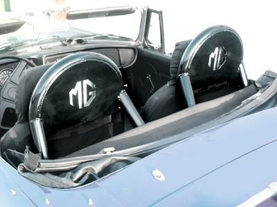

  #90
Been doing a lot of general maintenance items, adjusting the valves, oil change, adjusting the carb. I was poking through the for sale items on the MG forum and scored a SCCA certified double hoop roll bar. I kinda dig it and it will make my dad and wife happy for a just a bit more safety. It should be here next week, the pic is one from a mg parts vendors website.
Attached Thumbnails It's not a Rover build thread, MGB with Ford 302 power :D-459-022_1.jpg
