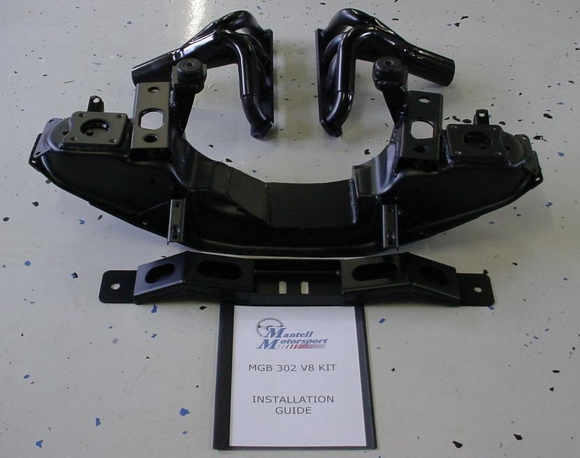

Anxiously awaiting the install kits arrival.... Apparently I'm the 157th nut case to order a kit since my crossmember serial number is 000157

Just got a email from Mantell the kit will be ready for pick up on Friday!

that looks like one hell of a nice drop in kit
Old Aug 12, 2015 | 11:43 AM
  #108
Drow, the kit is top notch from everything I have read. Pete at Mantell has been a pleasure to deal with and is quick to answer my dumb questions.
It is still going to take a lot of work, with modifying the foot wells relocating the radiator trimming the support panel for the rad and opening the holes in the inner fenders for the headers.
It's going to be ugly but I think it will really be worth it for the outcome
