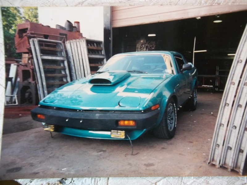

Boy oh boy that looks tight in there, I was lucky and had no steering issues, built my own exhaust manifolds......I'm thinking you'll be using the small u joint system. I needed this for my hood to go back on....lol!

From: Texas

That does look cool as hell, I dig the pro-street TR7 look lol. I like a bit of the sleeper look with the "oh S^&*" factor when it starts or the hood opens.
Oh and patience isn't one of my strong suites lol, but your right I know I'll get it. Just not a huge fan of surprises like that.
