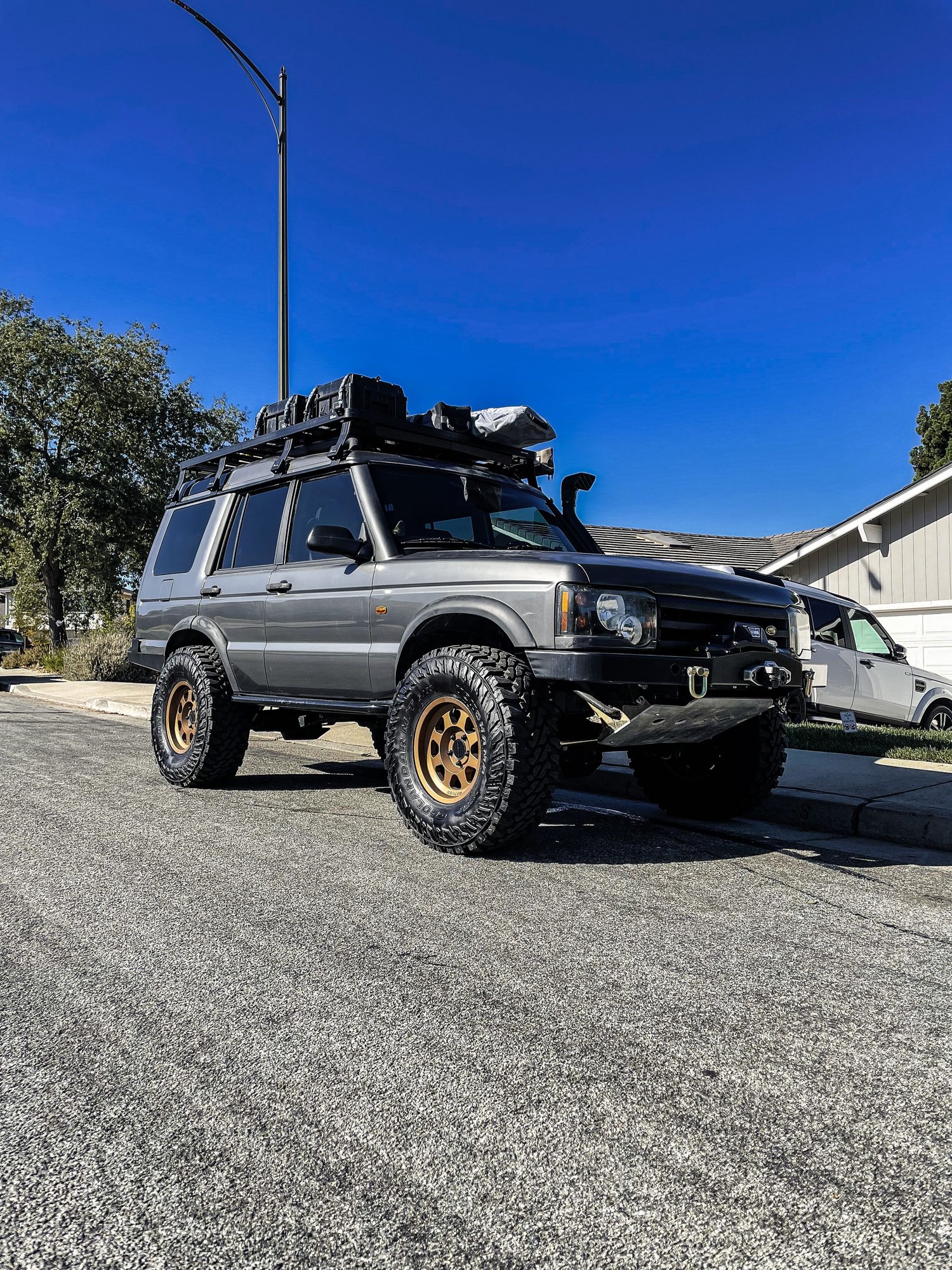

Project $$$ pit has been quite a headache as of late. For those who have followed by build know I installed a new AB engine shortly after purchasing the D2 given a blown HG. Since I’ve had the engine installed, there’s been a persistent oil leak. After resealing the oil pan, the leak improved but I was still having small seepage.
my shop added dye to the oil to trace the leak. To our surprise, they found a small hairline crack on the block. Luckily, AB warrantied the engine and my shop took care of the labor. AB and my shop have been awesome throughout the process but a headache nonetheless.
I got the truck back a few weeks ago with the new engine installed. I was surprised to find that the new engine runs quite a bit cooler than the old engine. At 70 mph on the highway I’m seeing temps for 186-190 whereas before I was typically seeing temps in the 200-210 range.

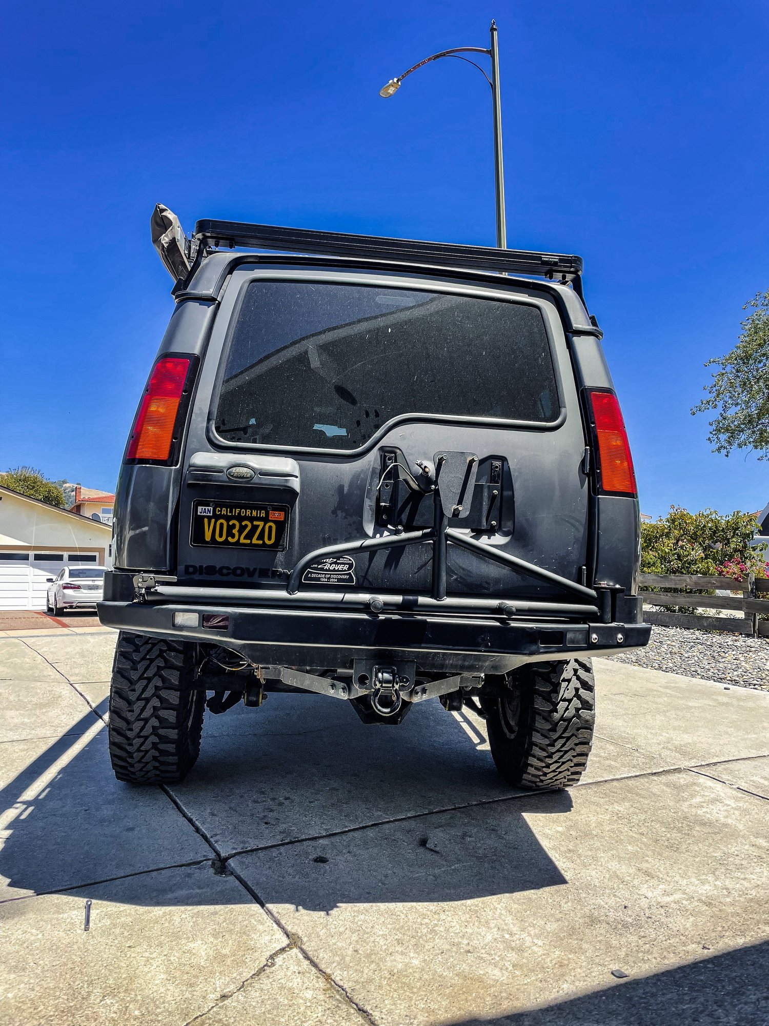

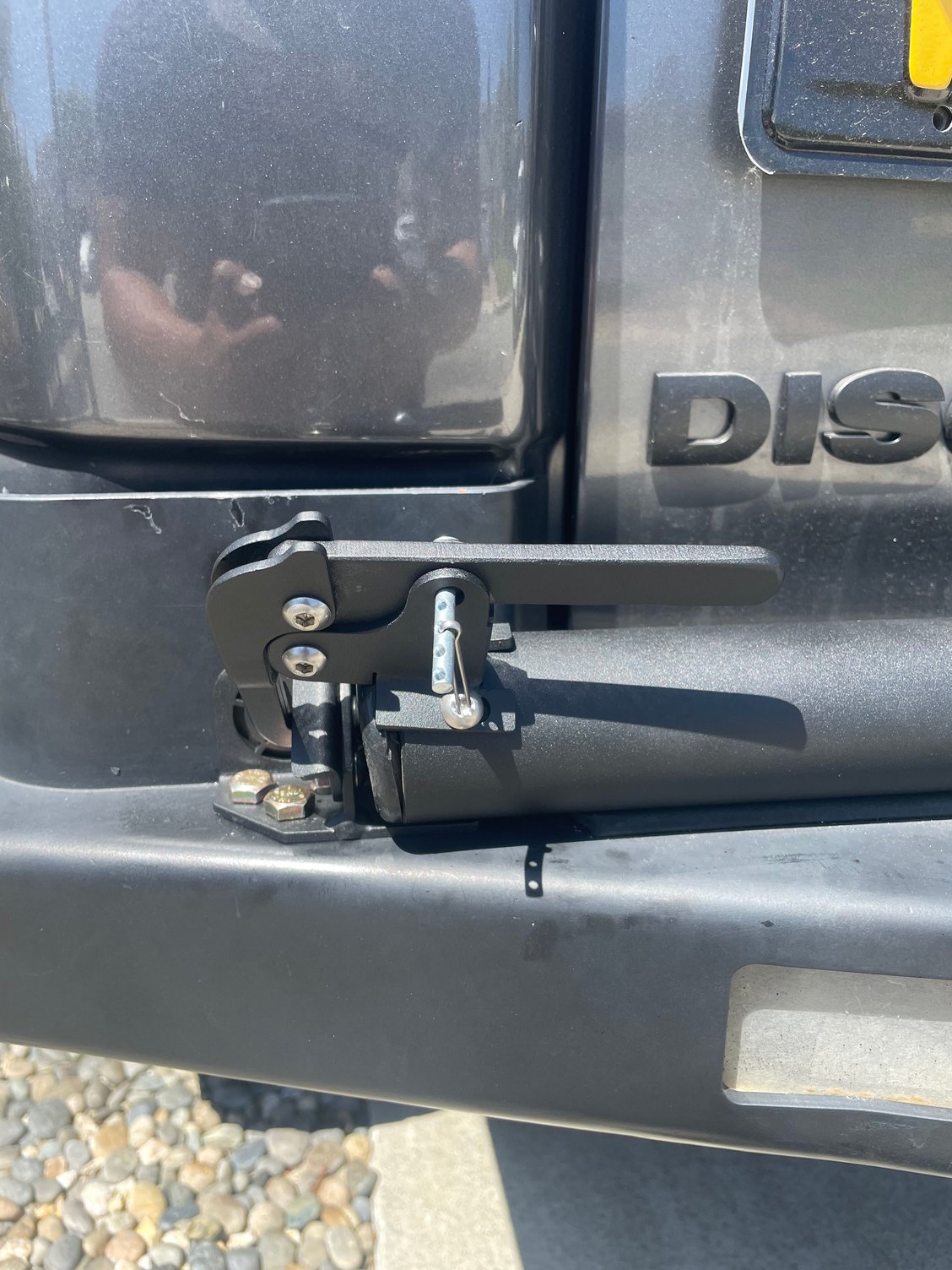

while I was waiting for the new engine to arrive, a custom rear tire carrier I had ordered last fall came in after quite a bit of wait.
I had some free time to install this weekend and the install for the most part went fine. But of course after several attempts to get the 35 in spare on the tire mount, I figured out the issue. The fabricator did not use the correct bolt pattern and lug size on the tire mount.
luckily the tire mount can be disconnected from the rear carrier, so it’s just a matter of getting a new mount. I’ve reached out to the fabricator and hopefully the issue will be resolved shortly.

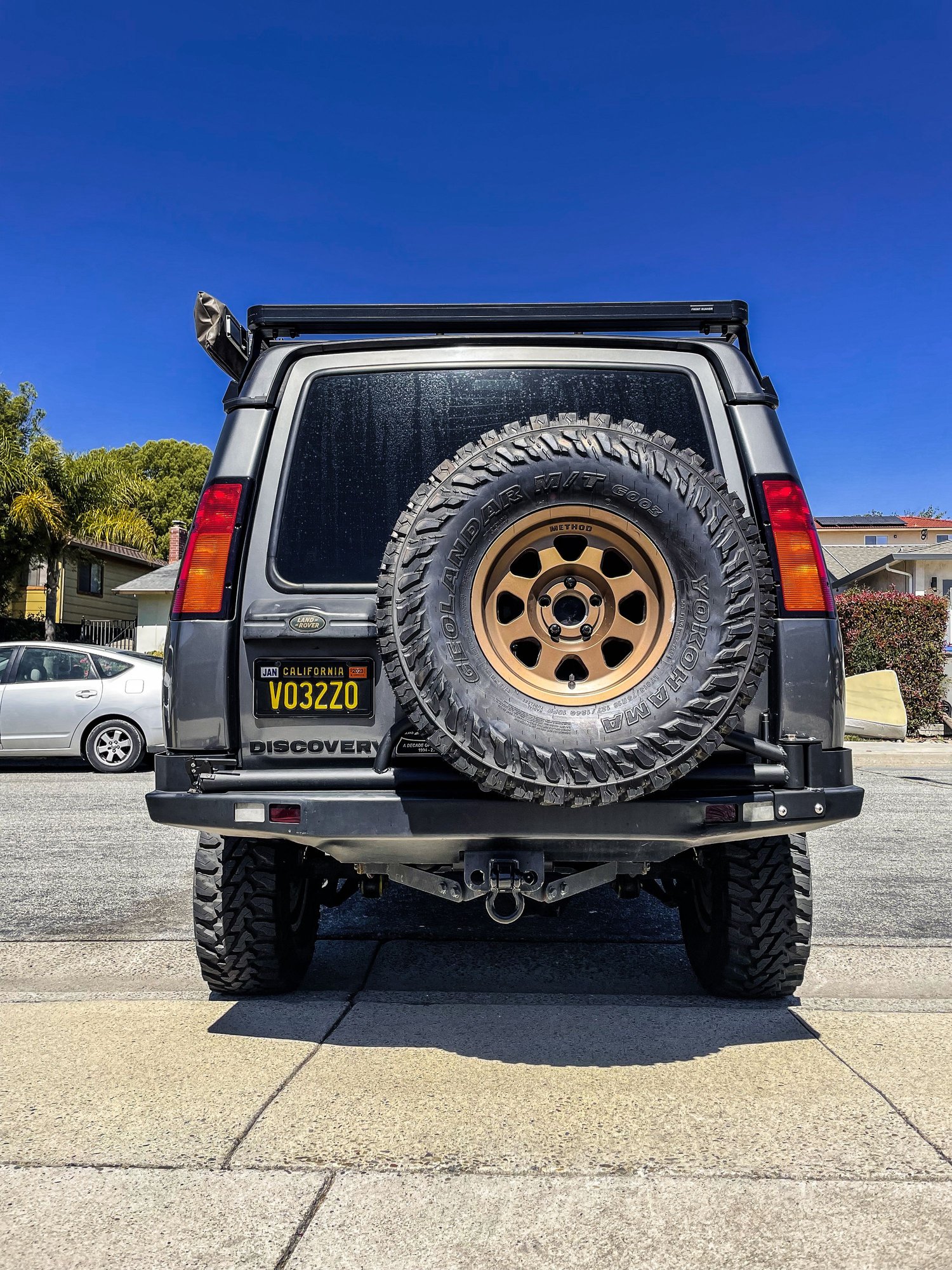

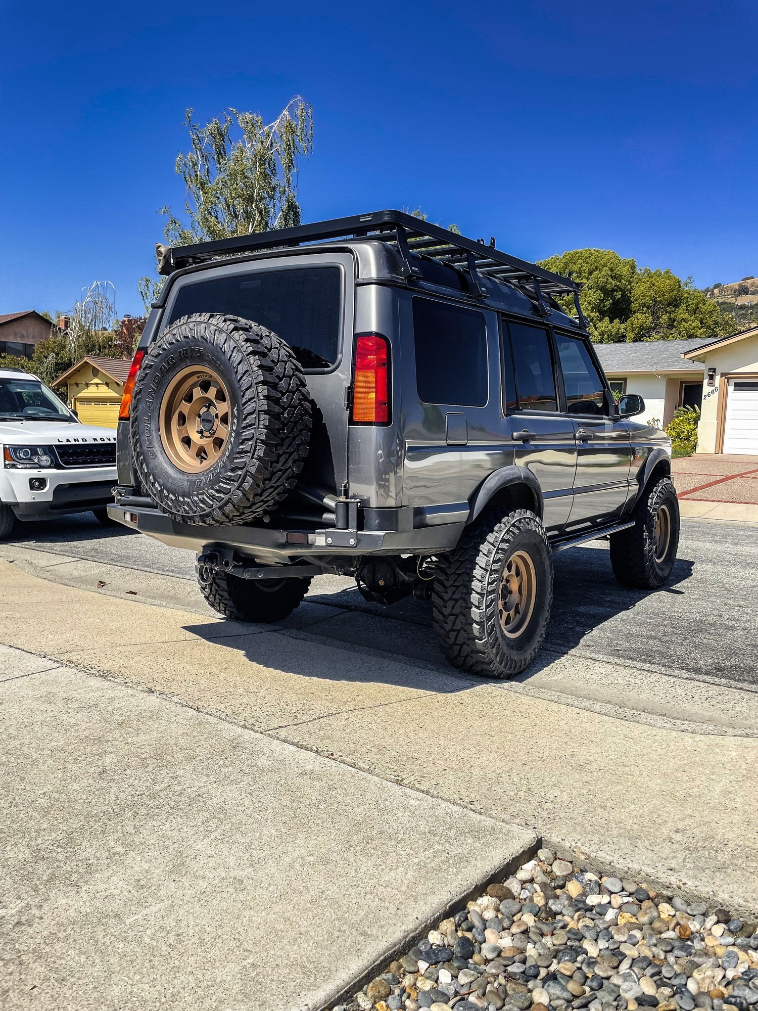

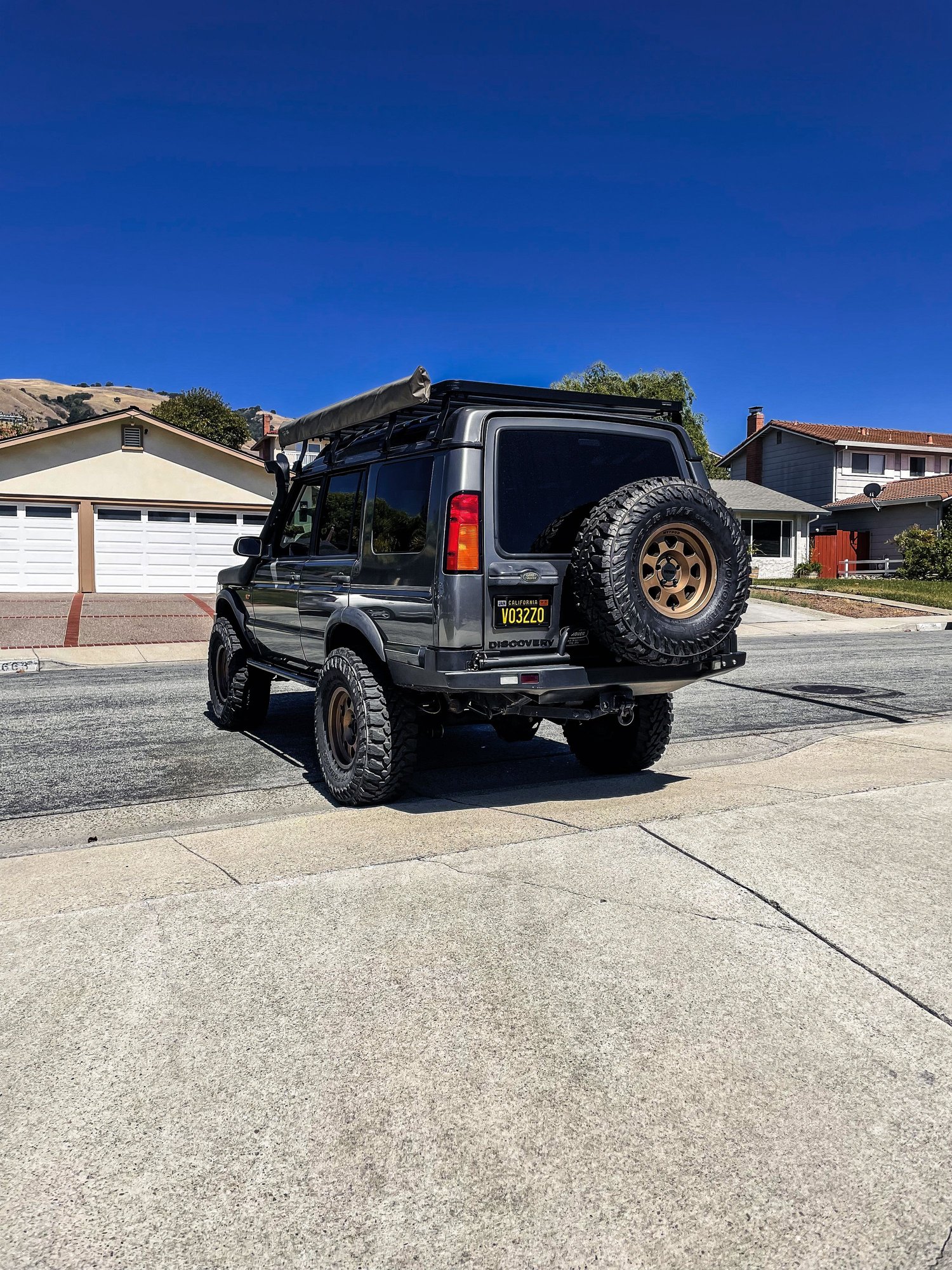

Update…rear tire is finally on.

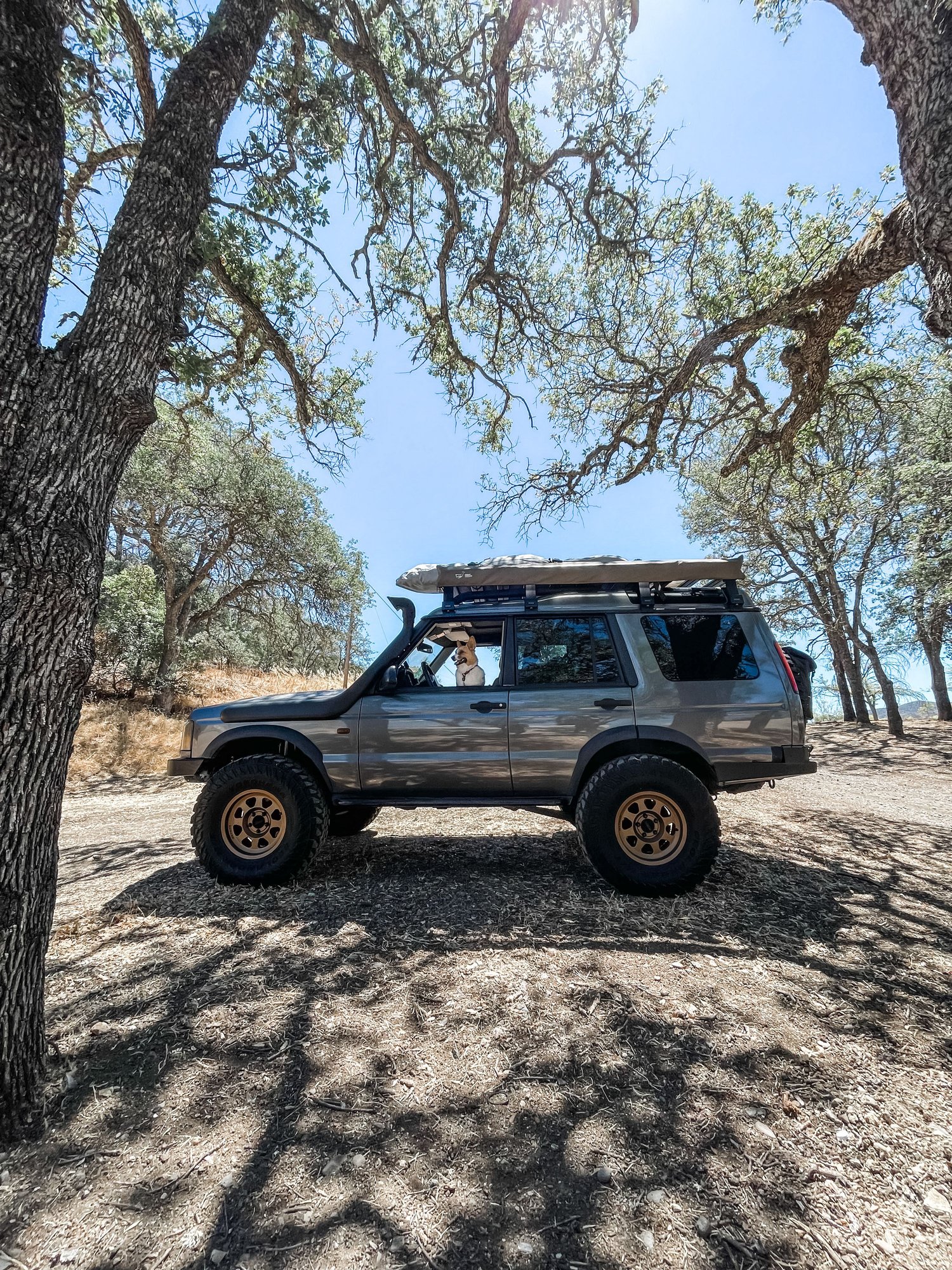

Finally managed to sneak away for a weekend camping trip with the family
