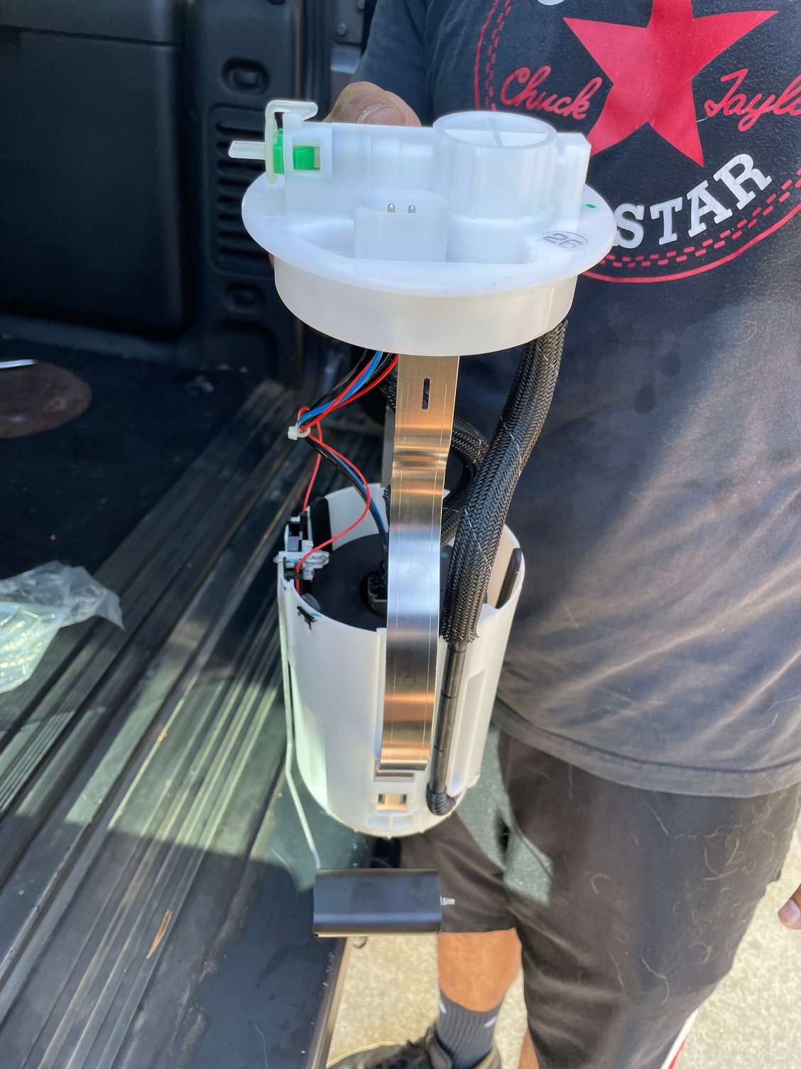

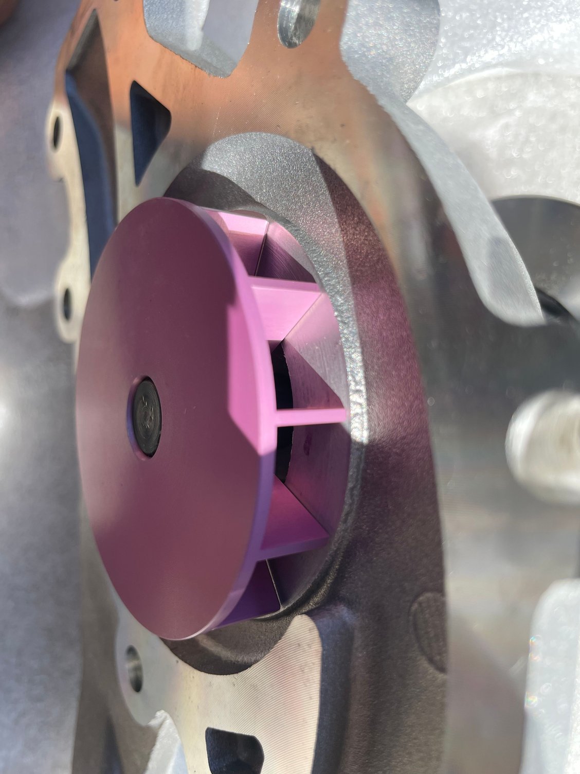

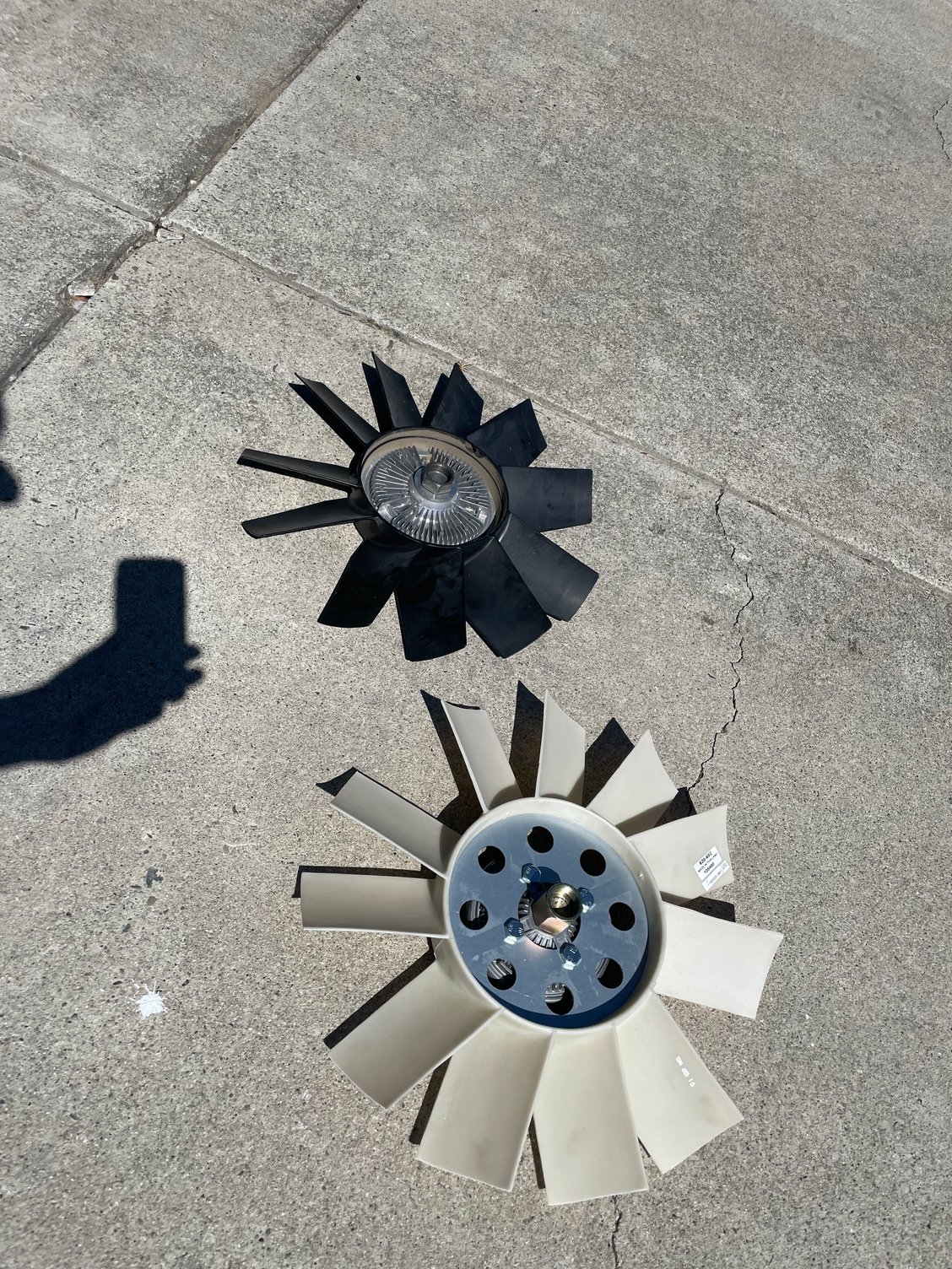

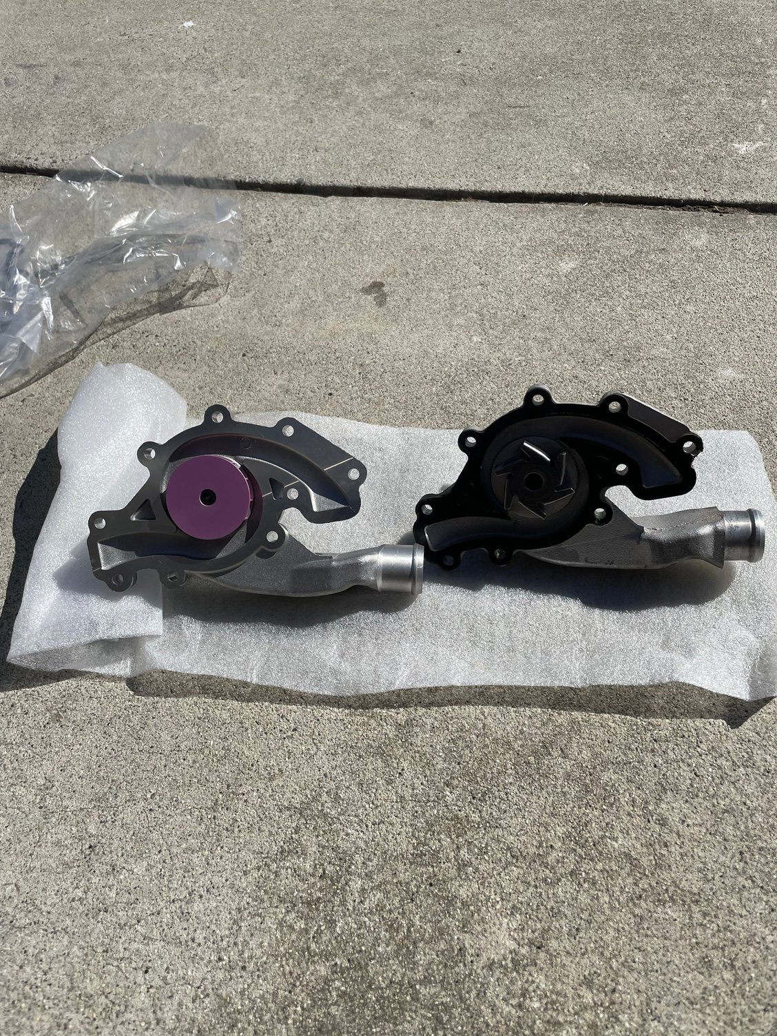

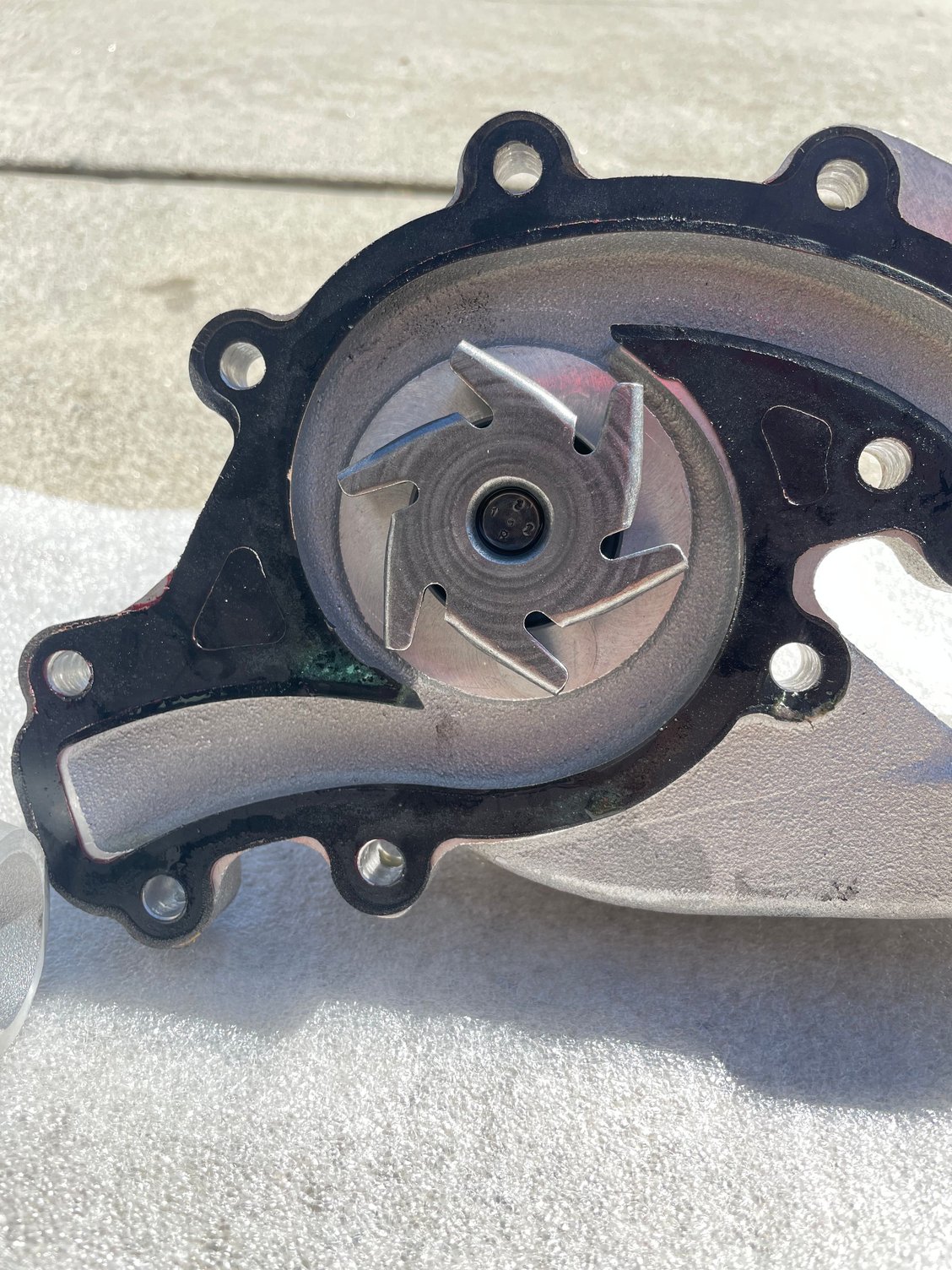

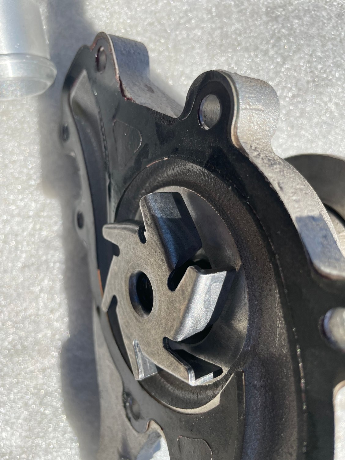

On my trip to Deer Valley last week ambient temps were in the 85-90 def F range. With the AC on I could not drive faster than 65 mph otherwise the water temps on the UG would go above 205 deg F. My truck has a new oem water pump, new oem fan and fan clutch, new Nissen radiator, and 180 deg inline T stat which were installed when the new engine went in the truck.

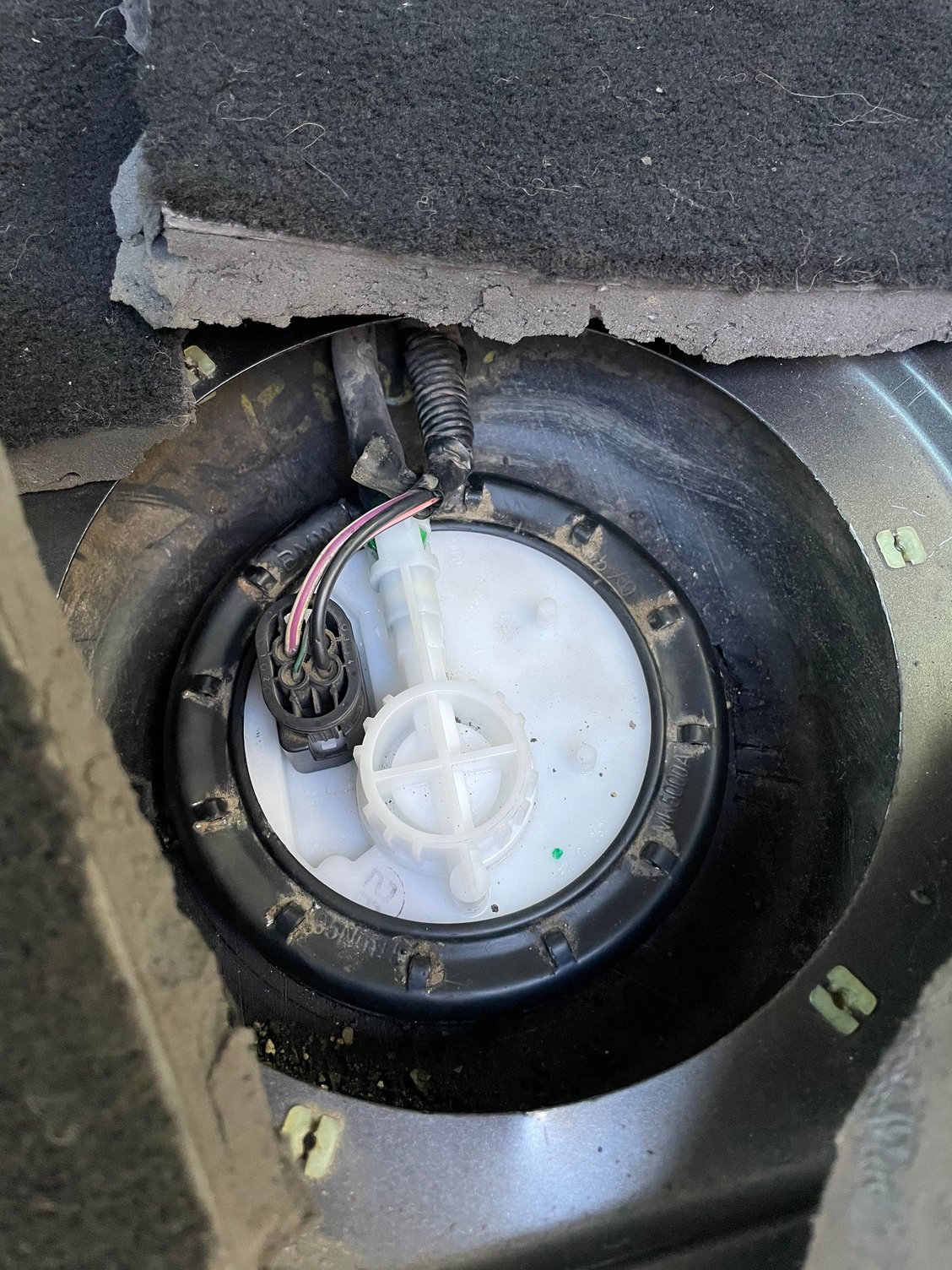

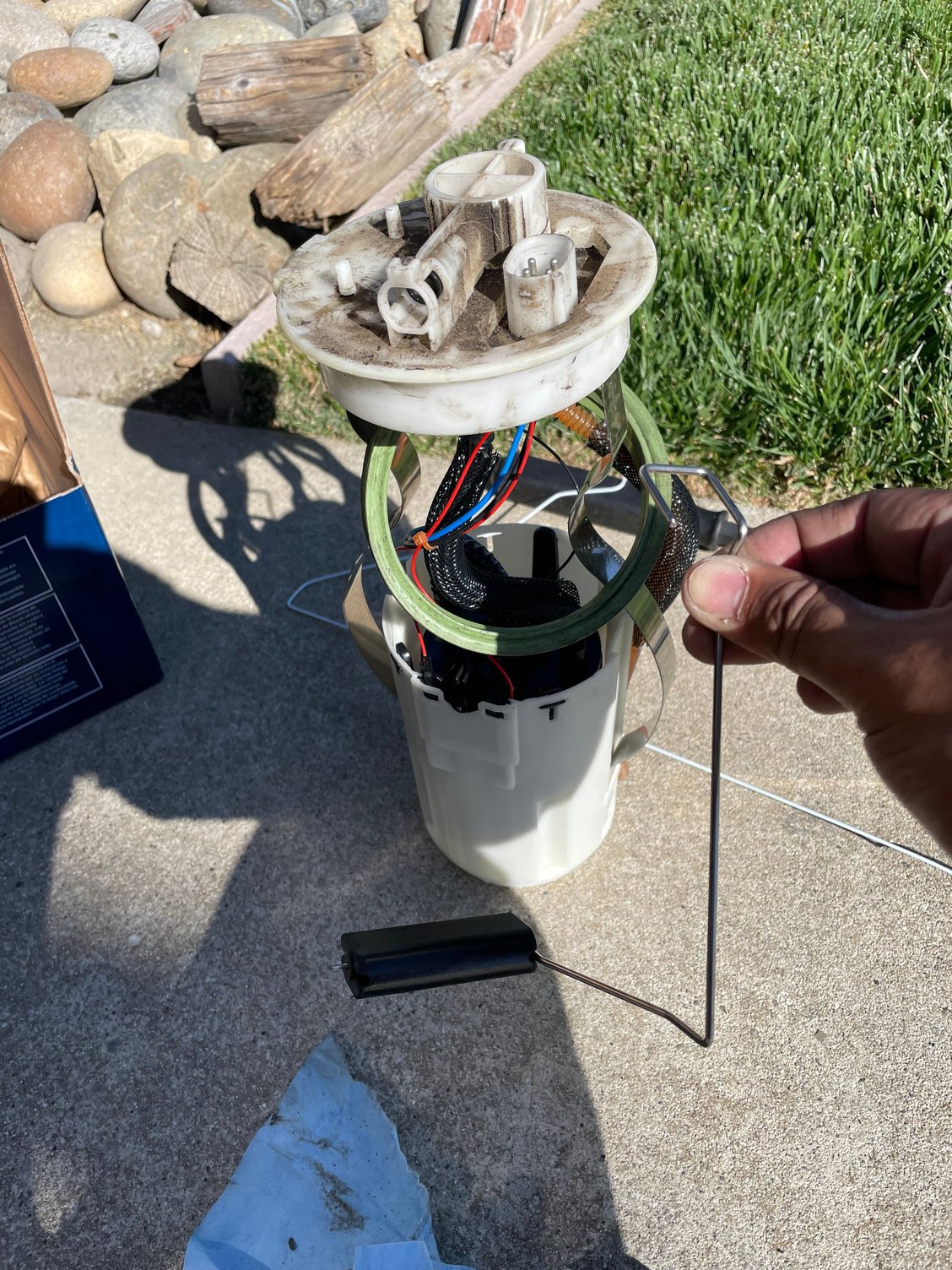

also, after the trail run my gas gauge stopped working. It was stuck at 3/4 tank and a code popped up due to fuel sender error.
to help with the d2 cooling, I picked up a flowkooler water pump, duralast fan clutch (922626) and Dorman fan (620-602). the fan blades need to be trimmed about 0.5 inch to clear the fan shroud. I also got a new Bosch fuel pump assembly to fix the fuel gauge issue.
after the cooling mods, I was seeing 194 deg F at 80 mph in 100 deg F ambient temps and 187 deg F temp at 65 mph with AC on full blast. Keep in mind my truck is regeared with 4.37, 35s, front and rear metal bumpers, rack, and armor so project $$$ pit is a bit heavy.
Money well spent.

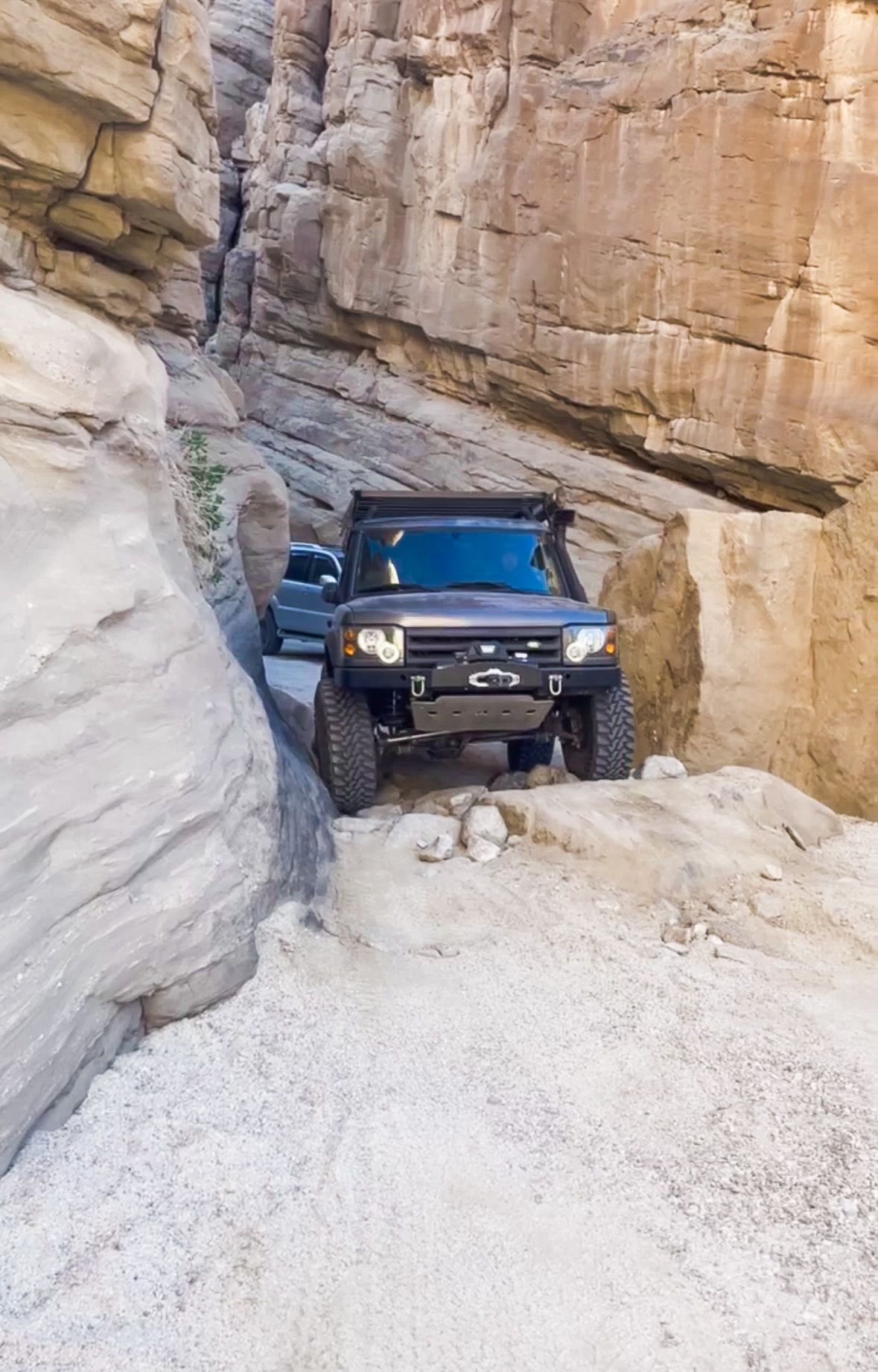

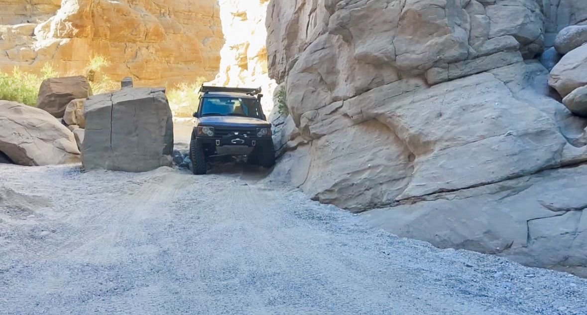

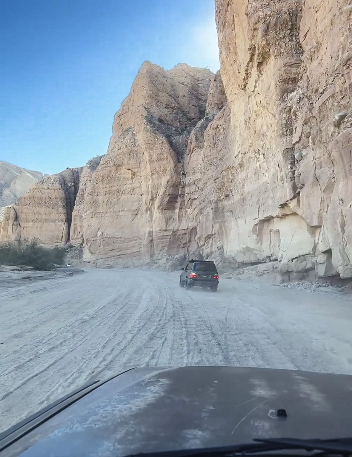

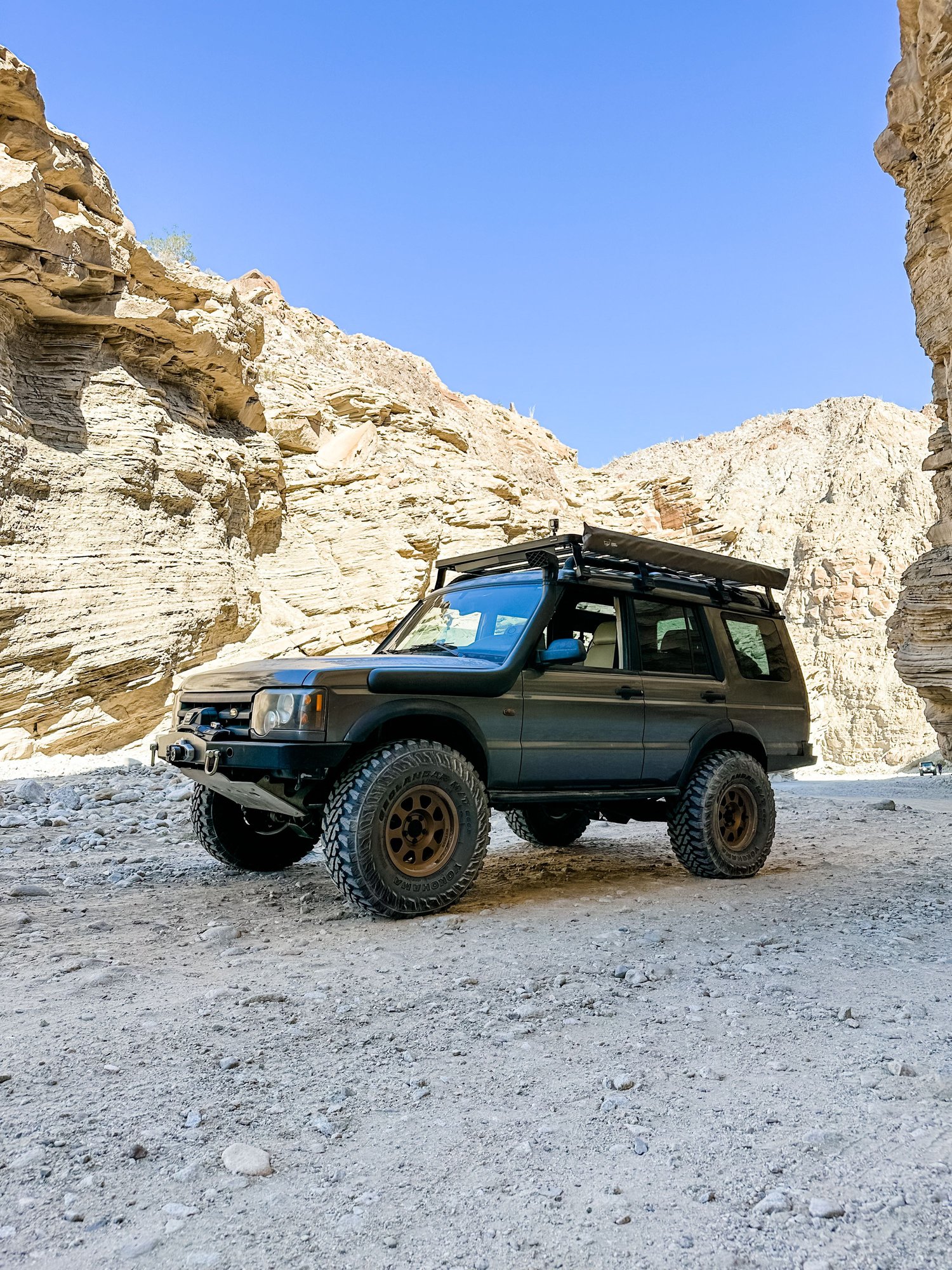

Spent some time at Anza Borrego with friends during the holidays. Nothing super technical, but was fun driving in the desert.

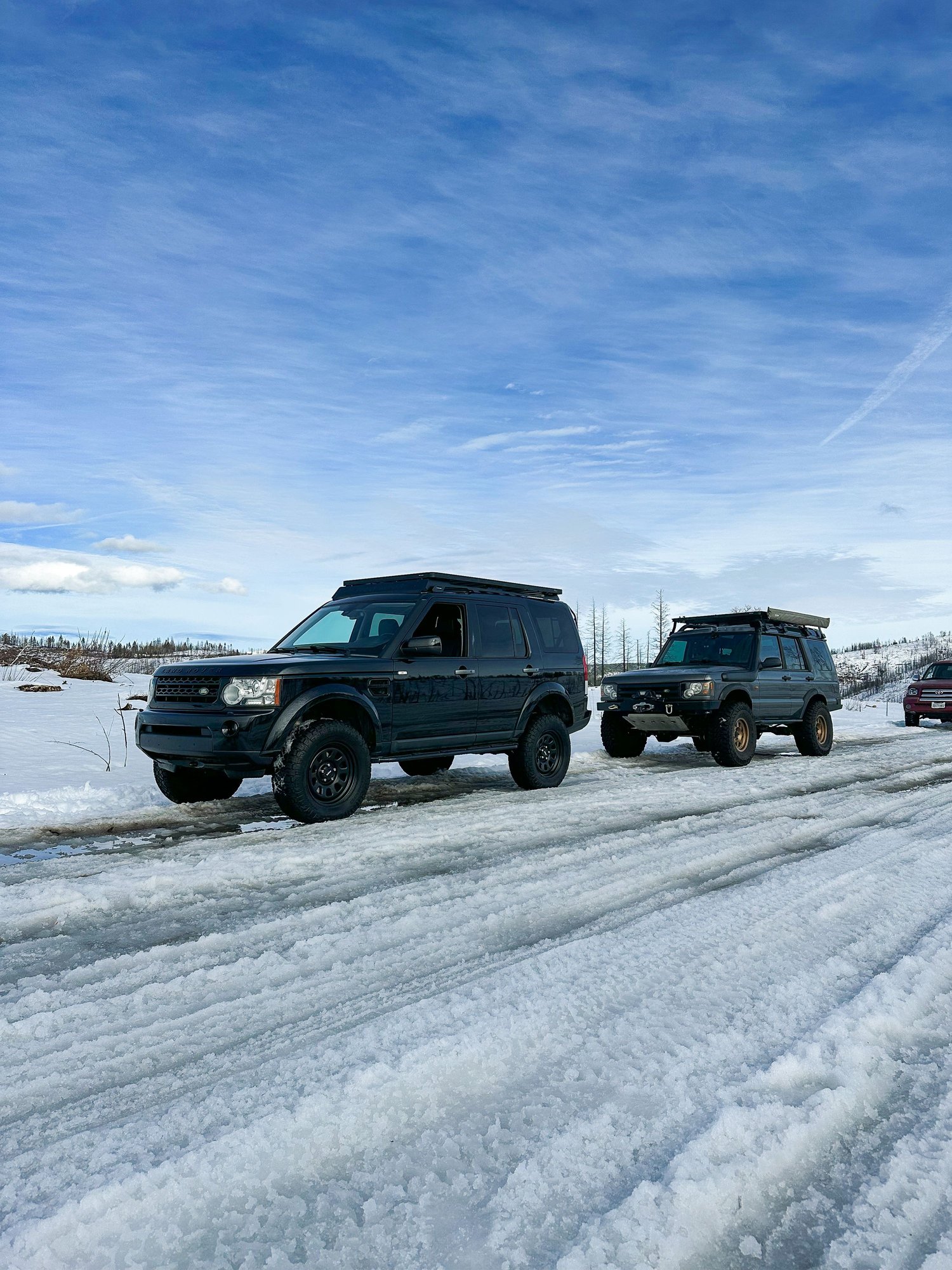

Brought the disco out to the MET this past weekend and it was going great until it wasn’t. After yanking a friend who was stuck in the snow, another friend started to flag me down to turn off the disco as fluid was spraying from the front end. I was expecting it to be coolant, but turned out to be transmission fluid.
the hydraulic hose line that feeds the transmission cooler ruptured near the metal crimp at the cooler side. I ended up cutting a spare radiator hose to size and wrapped it around the split in the hose and clamped it down with a few hose clamps I had on hand. The band aid fix got me off the trail as I was able to coast most of the way down the trail which kept the line pressure low.
The first incline I reached on the road which required throttle to make it up the road resulted in the trail fix failing and the disco stranded on the side of the road in the middle of a rain storm with wife and kids in tow lol. Luckily I had some friends with me who took the family. With family safe at my friends house, we were able to get some hoses at a nearby auto store to try to do a road size repair by cutting the oem hose after the crimp and clamping a new hose over both crimps at the hard line side and cooler side. After a few hours, we had to concede defeat and called a tow as the hoses could not get a good seal over the crimps.
the disco is at a known rover shop near the trail and I ended up having to rent a car to get back home 3 hours away. I’m having the shop repair the transmission line and also replace the ps hoses, pump and reservoir as I’m now paranoid about future failures. Hopefully the disco comes out of the shop better than ever.
some pics and vids of the disco in action before the failure.
