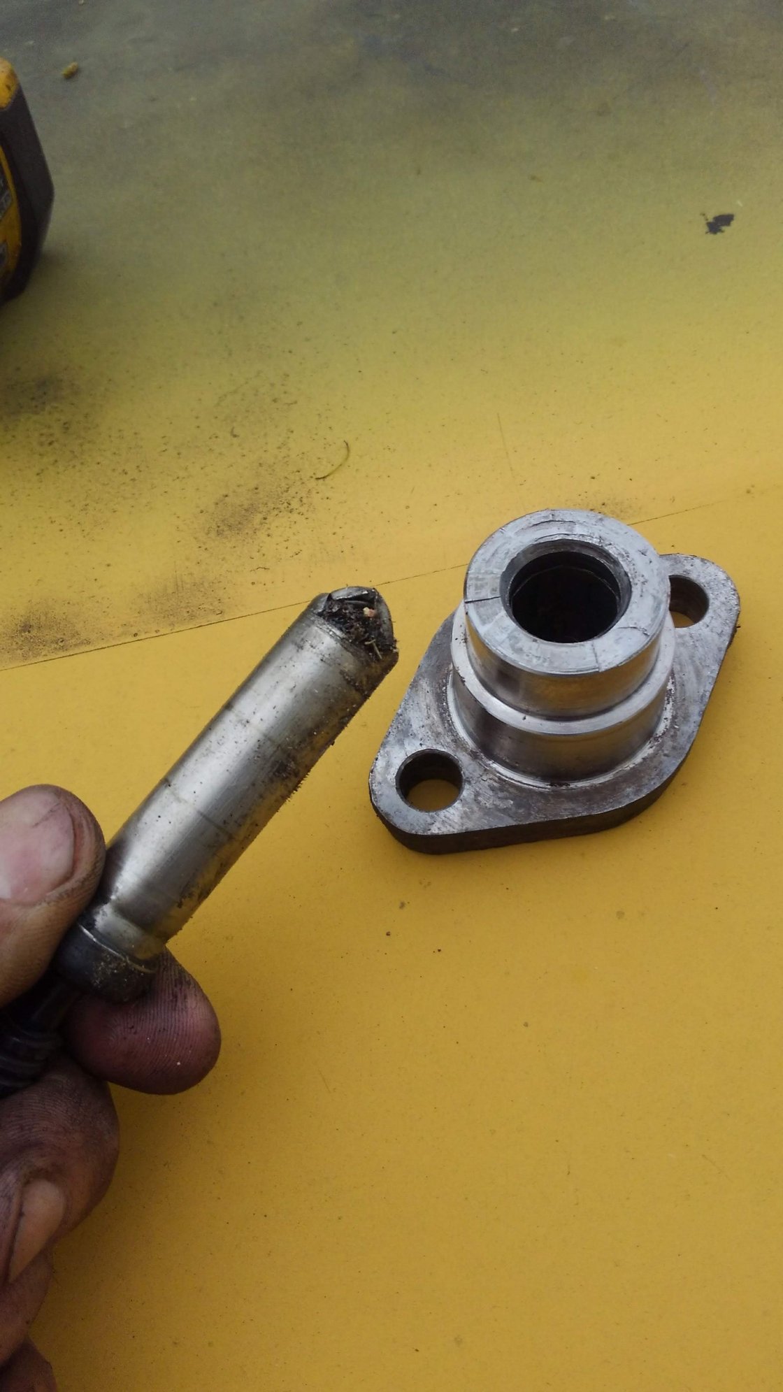

I did decide to check the swivel drag and the pass side had no resistance, popped the abs sensor and it was trashed, popped the swivel and it was damged and the bearing was non eqsistant, lucky for me i had an old swivel and knuckle assembly lying around so that got fixed and topped off the swivel grease with some 00
