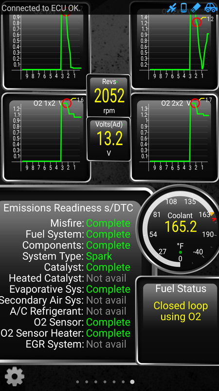

Spend $5.00 on the Torque Pro app and another $15.00 on a dang bluetooth dongle from Amazon. Check your MIL status, read and clear codes, see what your O2's are doing in real time, along with a million other things.

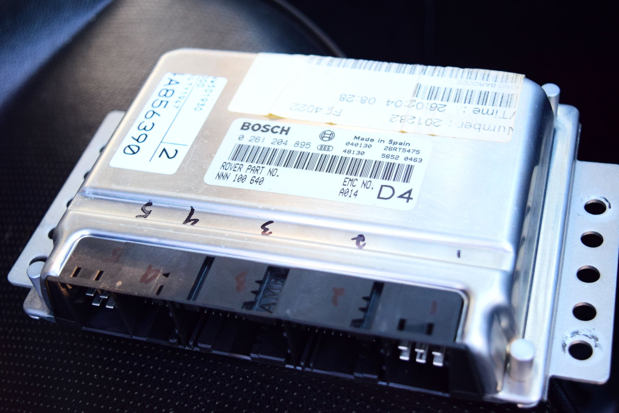

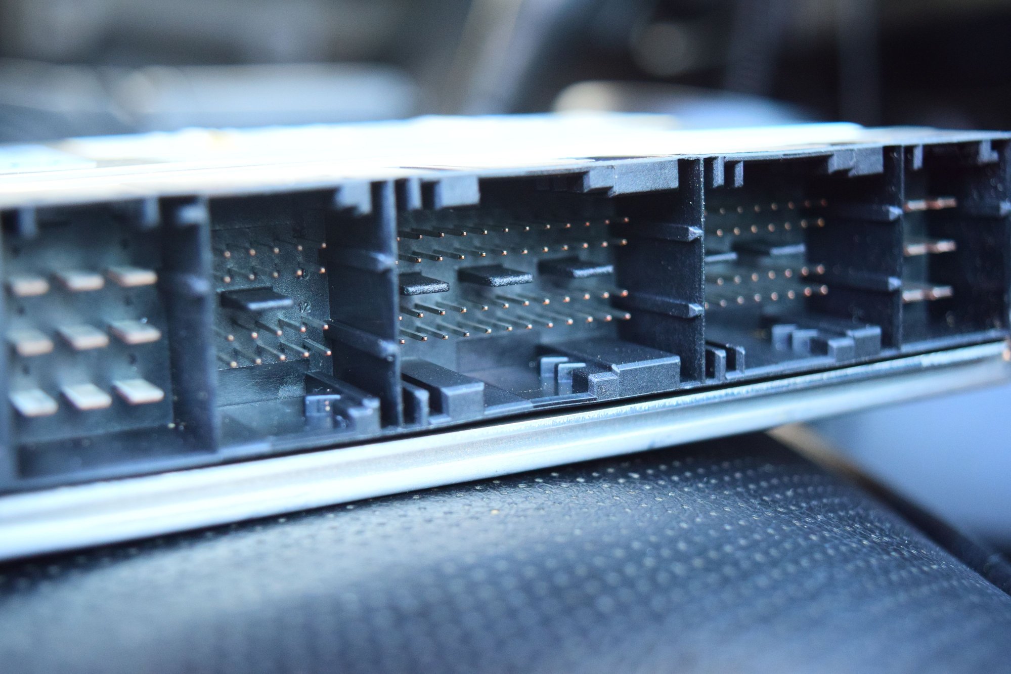

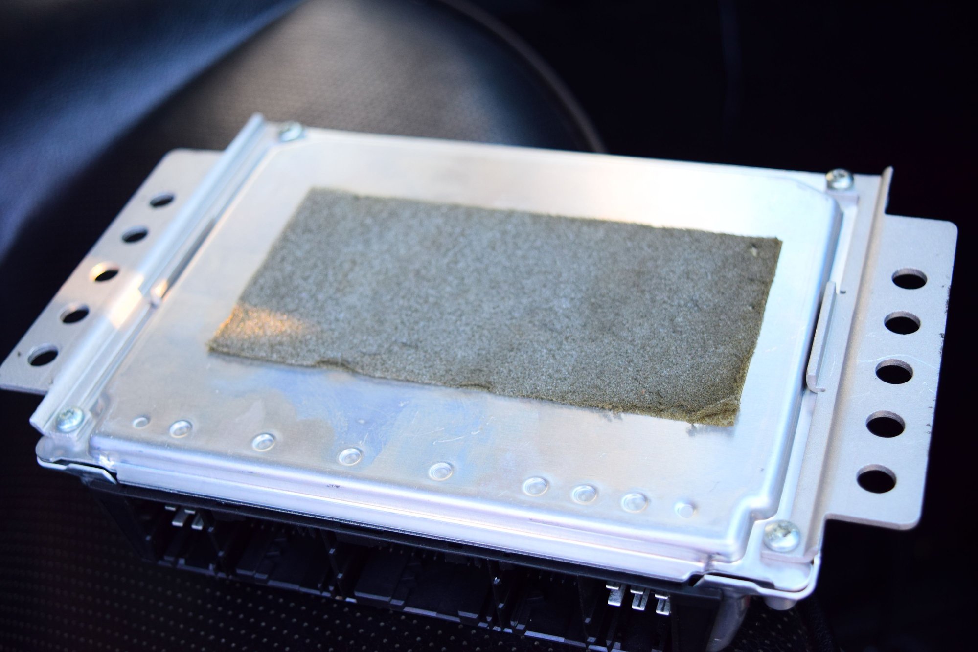

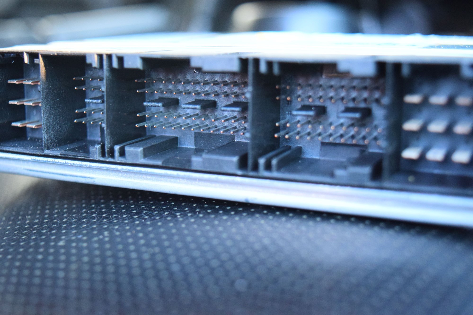

Right now Im working on removing the ecm to inspect the pins. Next I will inspect the engine bay fuse box. When the ground dries up a bit I will take a look at the 02 sensors themselves.

$20 will get you this and more....

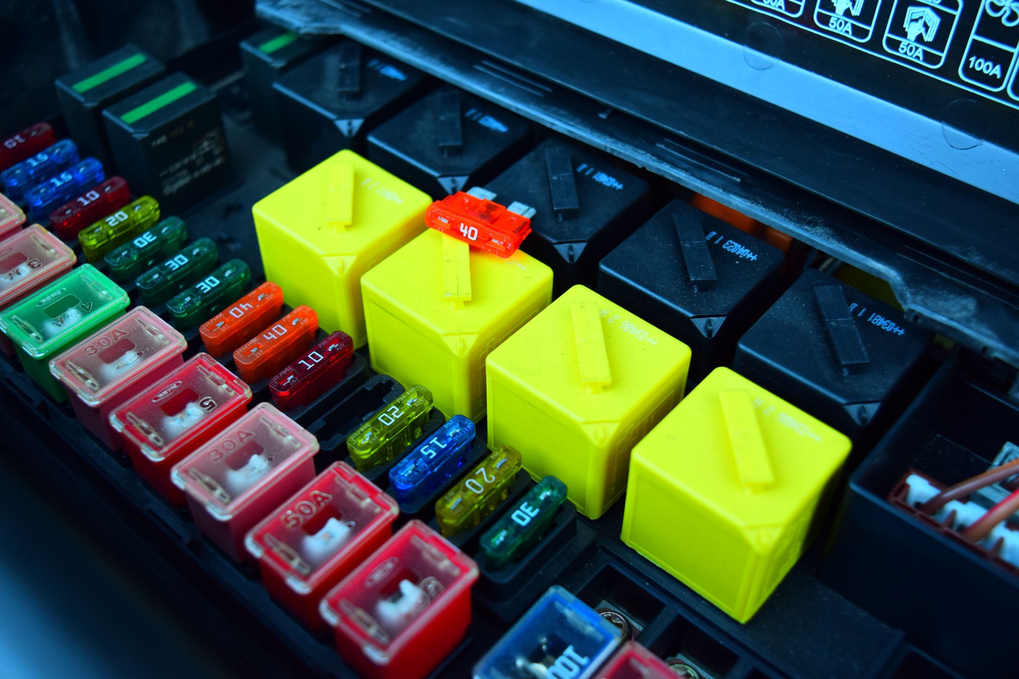

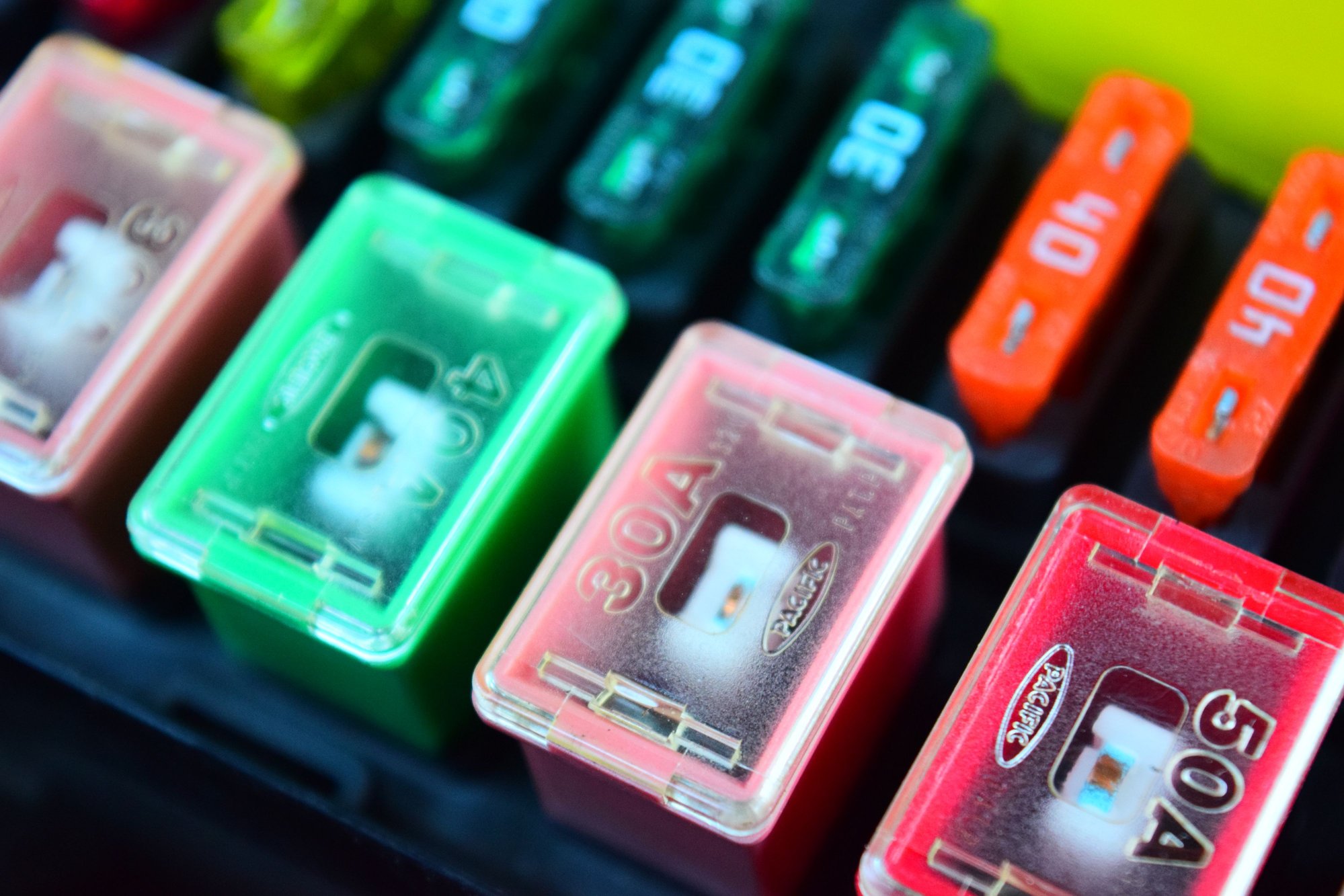

The ECM is clean so I put everything back together. I also briefly checked the engine bay fuse box to see if anything was out of the ordinary. F5 40 amp fuse was blown so I replaced it. Before I left for AK I recall one of these fuses was blown, possibly the F5. I will have to look into to more. Some of the FL series fuses have some green corrosion built up. Cleaned the MAF sensor with cleaner, cleared codes and took the truck for a short drive around the block. P0141 and P0161 codes came back as pending.
Connectors are clean and undamaged.
Again everything is clean and undamaged.
in the engine bay was blown so I replaced it. cant remember but I think that is the same fuse that keeps blowing. Will have to look into this.
Some of the FL series fuses have green corrosion on the metal. Ive never seen these fuses before so I left them alone but I will probably replace those ASAP.

Fuse 5 is the fan. I'll bet your fan motor is locked up. You'll want to fix that so you don't overheat your new engine.

Cooling fan and fan clutch are brand new along with engine.

Not talking about the fan with the clutch. I'm talking about the electric fan. Is it new too?
