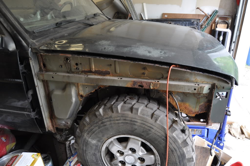

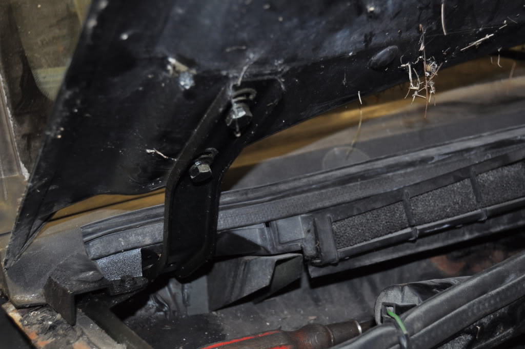

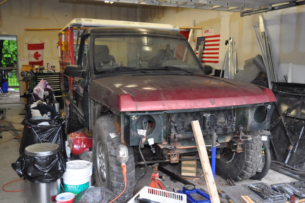

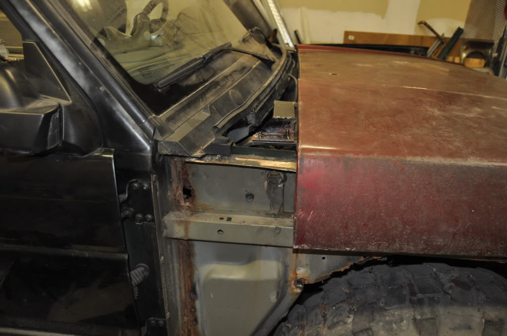

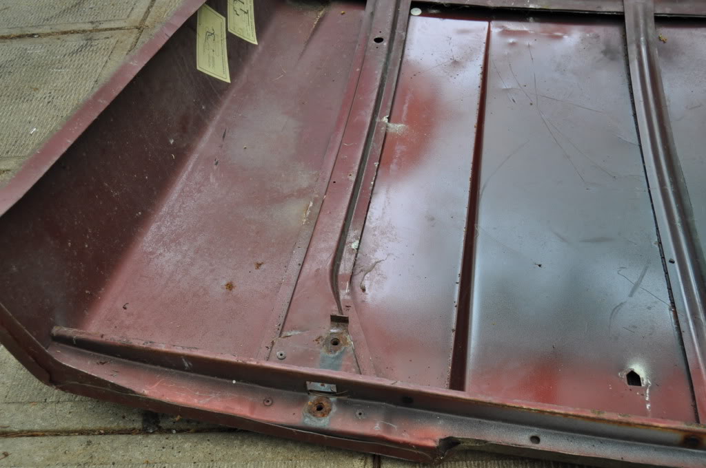

So , did you missed me ? I can see this forum attracted lot of trolls .Here are some picks of things I am occupied with .It is going to be Range Rover hood on D 1 . I know you will ask me why , because with Range Rover hood I don't need fenders That's why .
Picture one D1 hinge
Pic two Range Rover hood up side down showing place for hinge is different from D1
D1 hood without fenders ...

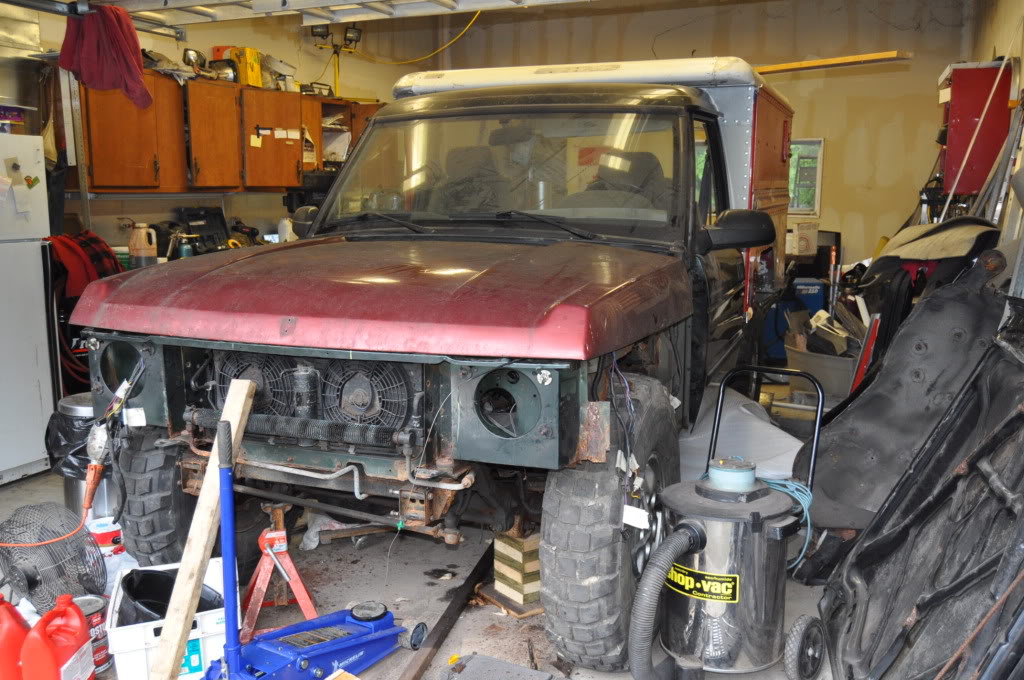

D1 hood side view...
Range Rover hood lose fit...
other side ...part of the roof is done too...

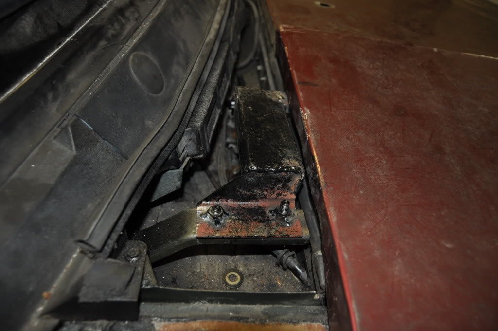

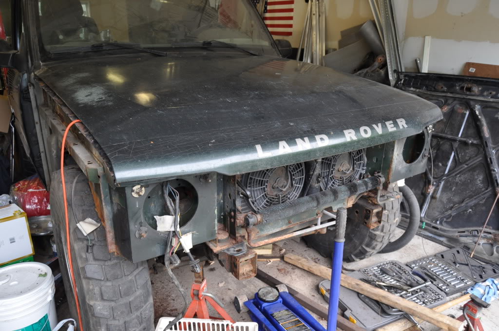

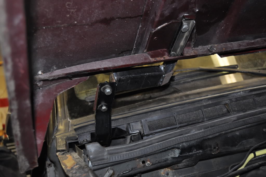

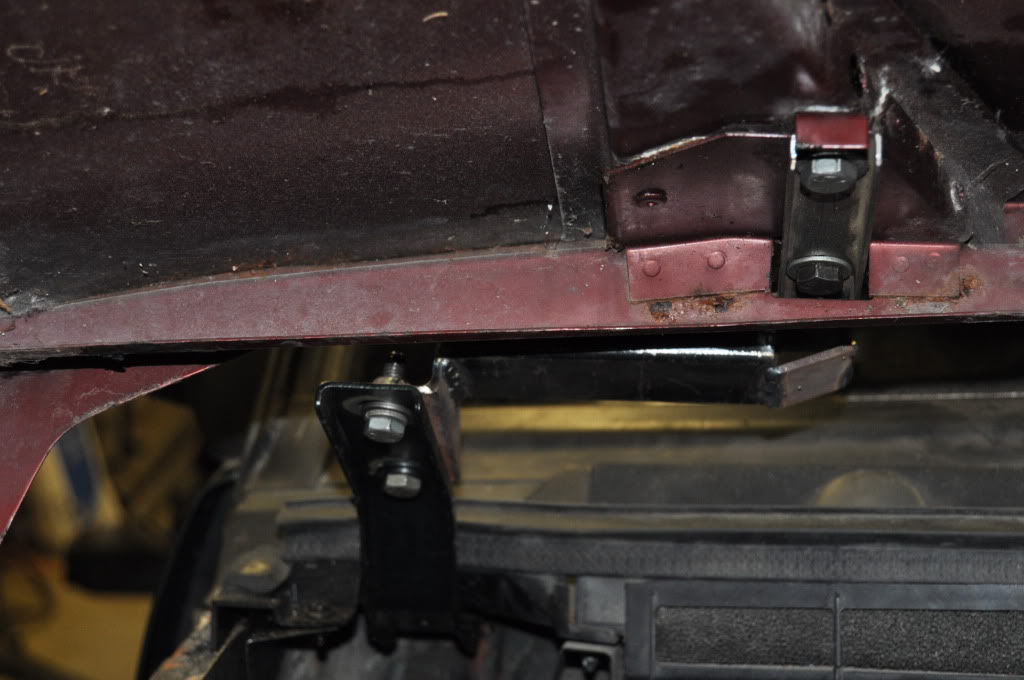

Small up to date .This is how old and new hinge looks .
Before....
and after...
