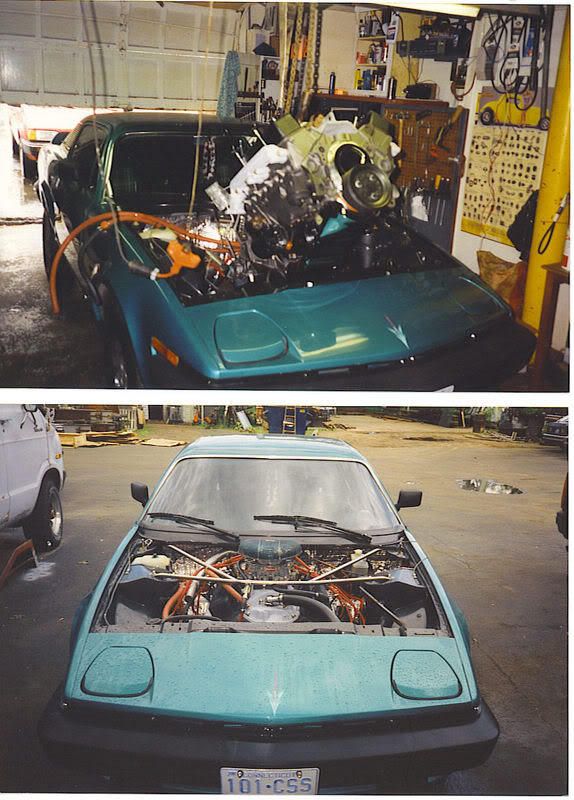

LOL......Yes, I actually have reworked factory manifolds........and it was on another Britt as well, inserting American muscle.......reworked the SBC manifolds allowing exhaust to be bent up, versus unibody reconfiguration.....

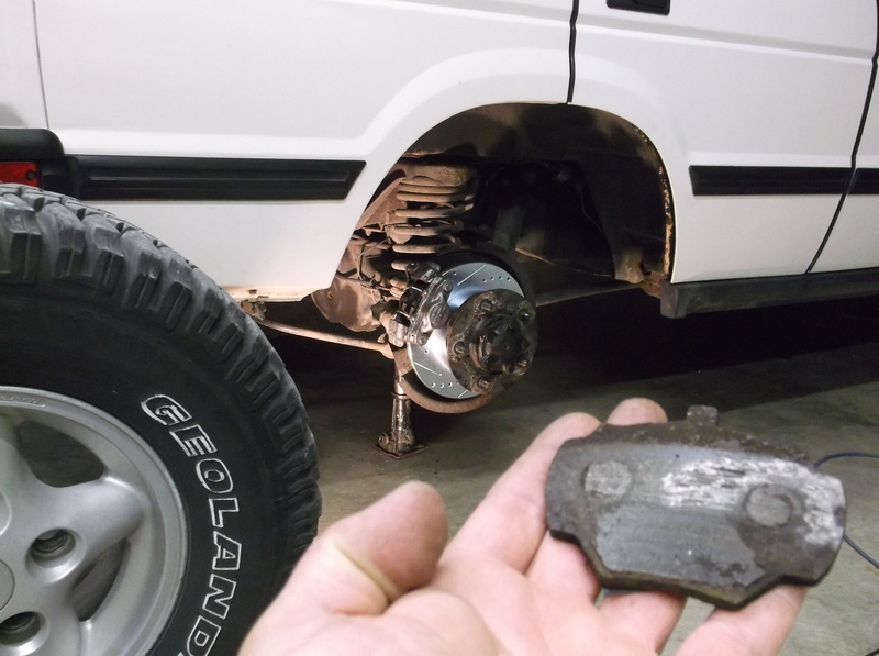

Nope, not slacking, not in the Bahama's for Thanksgiving.......just swamped, but.......
Been doing a corner a night on the brakes.......Nothing too surprising back there, figured the rears were the place to start.......new rotors & shoes, repacked the bearings.....running a new line pass. rear tomorrow, once done 90% have been replaced!
No more finger nails down the chalk board!!!!
Also picked up the tube to replace my 'Caddy-let-ick' converters with, ihscouts suggests I have a bad one........
Ordered my Hooker Aero-Flow muffler, going single out now, after a closer look, duals would be tighter than tight......
Outside of that, she's behaving for now.........

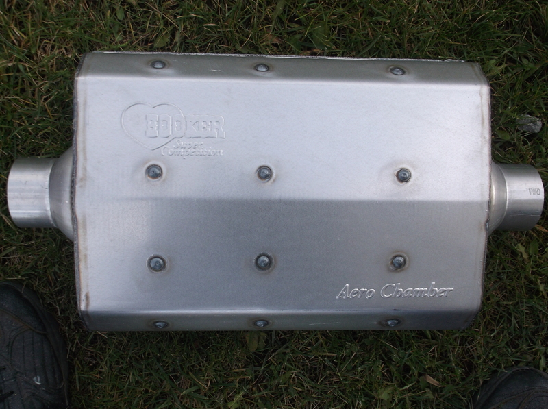

Welp...........My Hooker showed up.......
That was quick, Jeg's.....here in 2 days.........Whoops, wrong pic!
This:
Waiting on the tail pipe.......once completed I'll post a sound recording.
