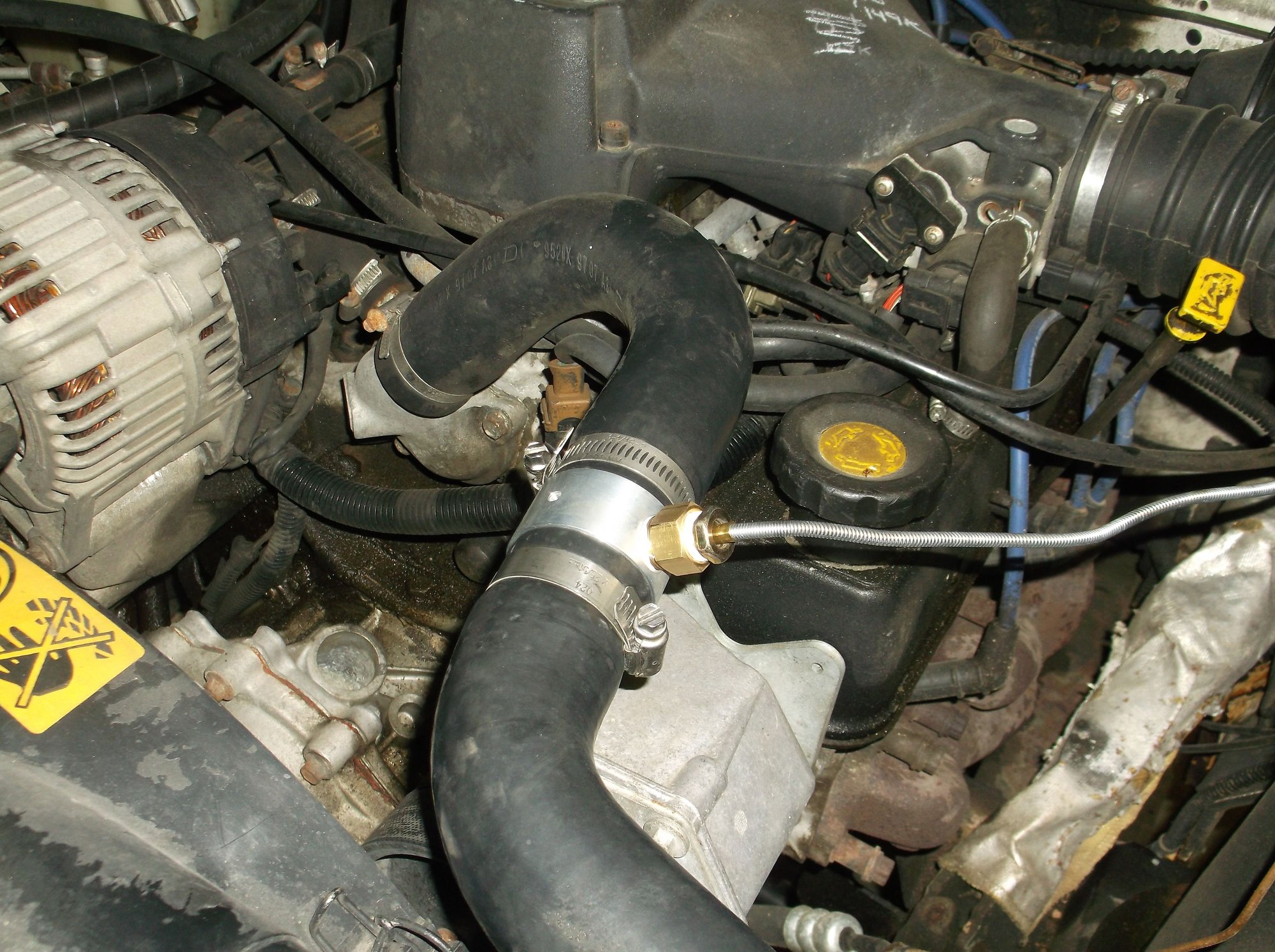

Long over due oil change complete!
Mechanical gauges on a pillar temporarily installed and functioning!
I'm going to pull them down, lower, wire the lighting and do a total respray when time permits.....but, up and running!!
Don't judge that install yet, just temporary placement/set up.

Call me analog man, I'm kool with that over 1979 computer tech.......
Here's the deal over '2' low 90's days.....
Late afternoons.......mechanical gauge read 125 degrees.......'both' days, under the hood, in direct sun.....like the cabin, expect higher temps but I wasn't expecting this......it was just sitting in the sun, that's why you don't leave your weasel under the hood......Blew my mind!
I actually LOST heat by driving by 7 degrees, factory gauge held steady thru-out this.......little above 1/2, but normal by LR standards....
8 miles out, twice in two days..........the mechanical gauge lowered by 7 degree's by new air flow.........factory gauge....FLAT....
Then..........BOOM! My lazy thermostat opened.........I need a new thermostat.........proof positive, saving the motor by analog.......stick that in your ob2 and light it twice........after all......Lucas was a pot head & dropped blotter.......
Call me bad, but the results are good over your computed results that would not catch this kind of crap off the block.....the analog gage sold me a new thermo'......none of the computer crap showed me what the analog gage showed..............One small step for man, one step misguided for those who believe in..........what they previously thought???? Dunno........
