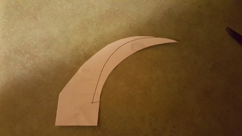

After searching....'Camel Cut'.....reading a couple of threads......disappointment, no direct info....
Fishsticks......You've done this, looked good......can you post a side pic of your rig? I'll just take it from there.....it's just non ferrous metal, what could happen?

Basically I take a piece of cardboard and draw a varying radius curved line. I cut the cardboars along that curve and end up with a sorta claw shaped piece. Then I'd offer uo the curved part to the rear wheel arch and adjust the position till it looks good and blends seamlessly.
I mark the cardboard with a sharpie where it meets the bottom and top of the metal. Then I trace the line onto the metal and cut with and angle grinder. Flip the cardboard to the other side. Using the marked spots on it put it in position, trace onto the metal, amd cut.

You'd jave something like this for a pattern to trace onto the metal.

Thanks 'Fish.....for now I just want to loose some of that lower rear rocker prior to starting the rear bumper.

The lower rear rocker is all I ever trimmed for my 265/75's. From the edge go back maybe an inch. Taper your cut up into the wheel arch radius.

My 265/70's cleared with only minor nipping at the base, the tire took care of the rest.....
My goal is to create a higher, tighter bumper that will require less metal to cover.....like up front.
