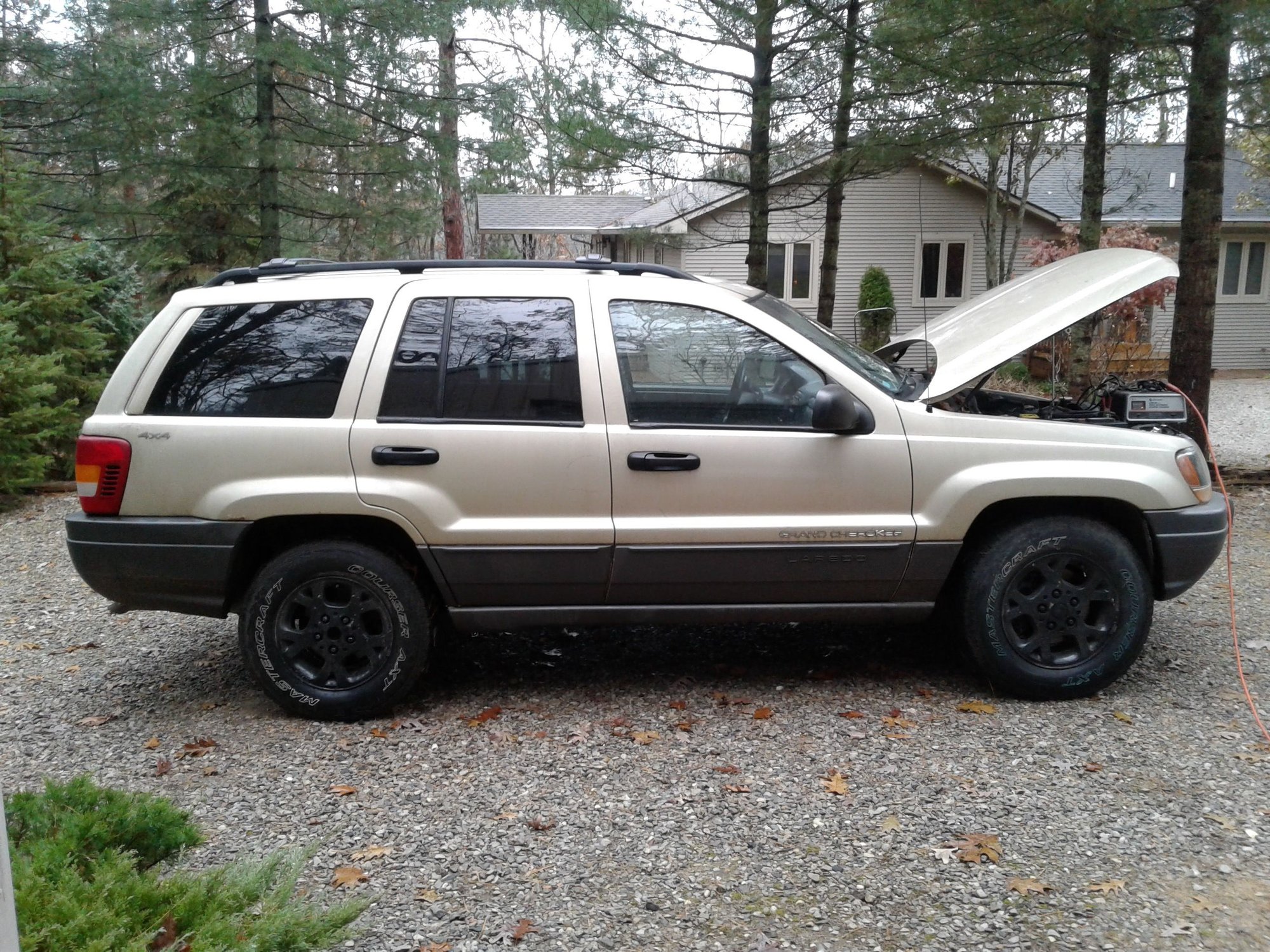

It does like to mozzy between the paint stripes. Me and RA are almost business partners, I'm up to eight tool box magnets now, probably collectable someday. Found my fuel stink reason, pump ring not even on theads and they hacked an access hole below the spare like no other. Gotta love rednecks. I'll highjack Detours thread with a pic.

Pics aren't hosted, direct off my phone to the site. 2001 Laredo, inline six, four speed with select a trac. Bought it off of friends who didn't own it long before they sunk $900 into it for overheating so it has a new intake (cracked) head gasket (head magna fluxed), pump, thermostat and radiator. When it dumped fuel on the ground when Lisa was filling it Rich said he was done with it. He offered it to me for the repair bill - cheap winter beater. I don't have the heart to tell Rich the overheats are because of the fan relay, a $30 dollar part and common with electric fan GC's. Hit the A/C button and you have a fan.
I was cleaning up the interior and removed the spare tire to check it's condition (perfect) and to check the jack and found an access had been hacked above the pump (common Jeep time saver) and the fuel pump wasn't clamped to the tank? Zero pump seal too. Lisa had complained about the fuel smell inside the thing....gee no wonder. There is a pound of dirt in the tank which has 18 gallons in it and the float connection was off which explains why fuel hit the pavement around the tank, it was full already....lol. The pickup sock is the color of dark roast coffee and I don't doubt the inline looks any better. I only wonder how the injectors made it this far.... Rich and Lisa bought it from her cousin, not a cousin I'd want to claim.

I can see it now, changed compukers......that's a WJ.
The head can be an issue for the '01's.....info and casting numbers are all over the web. That hack job is typically done by the unknowing, looking for a quick fix and takes internet advise from 17 year olds kind of Jeeper.......blacking out the base of the vehicle can also ID a young, non-knowing, looking for some sort of 10 dolla upgrade of sorts.....Jeeper type.........Just my experiance.
You can get a lot of miles out of that motor, the tran's can act up around 200K.
