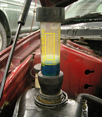

If thats you're only worry you can always test the coolant for exhaust gases before buying it.

Very common for auction buyers of English vehicles to carry one of these, about $60, does 15 tests. Changes color if exhaust gas in coolant.

thanks guys, you're right. i'll make sure i do the test before anything else. please let me know if there's anything else that you come up with.
