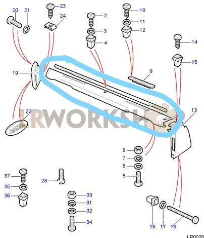

I am struggling to find out which part this is? on LRworkshop part 1 is the duct, i want the entire panel? any ideas?

RHD (LHD could possibly be different, not sure, maybe the same...no other listing besides these two)
MWC9327PMA (upto vin# 455595)
MXC6084PMA (from vin# HA455596)
Looks like one is unobtainable through LRWorkshop.
https://www.lrworkshop.com/diagrams/...er-facia_53620
Send me your email address in a PM and l'll try and send you all the parts downloads.
