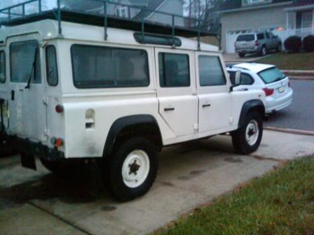

I guess Santa saw this whole thing unfold, and left this in the driveway. Ho Ho flipping Ho!
Its actually a tractor in a Defender body...lol!
