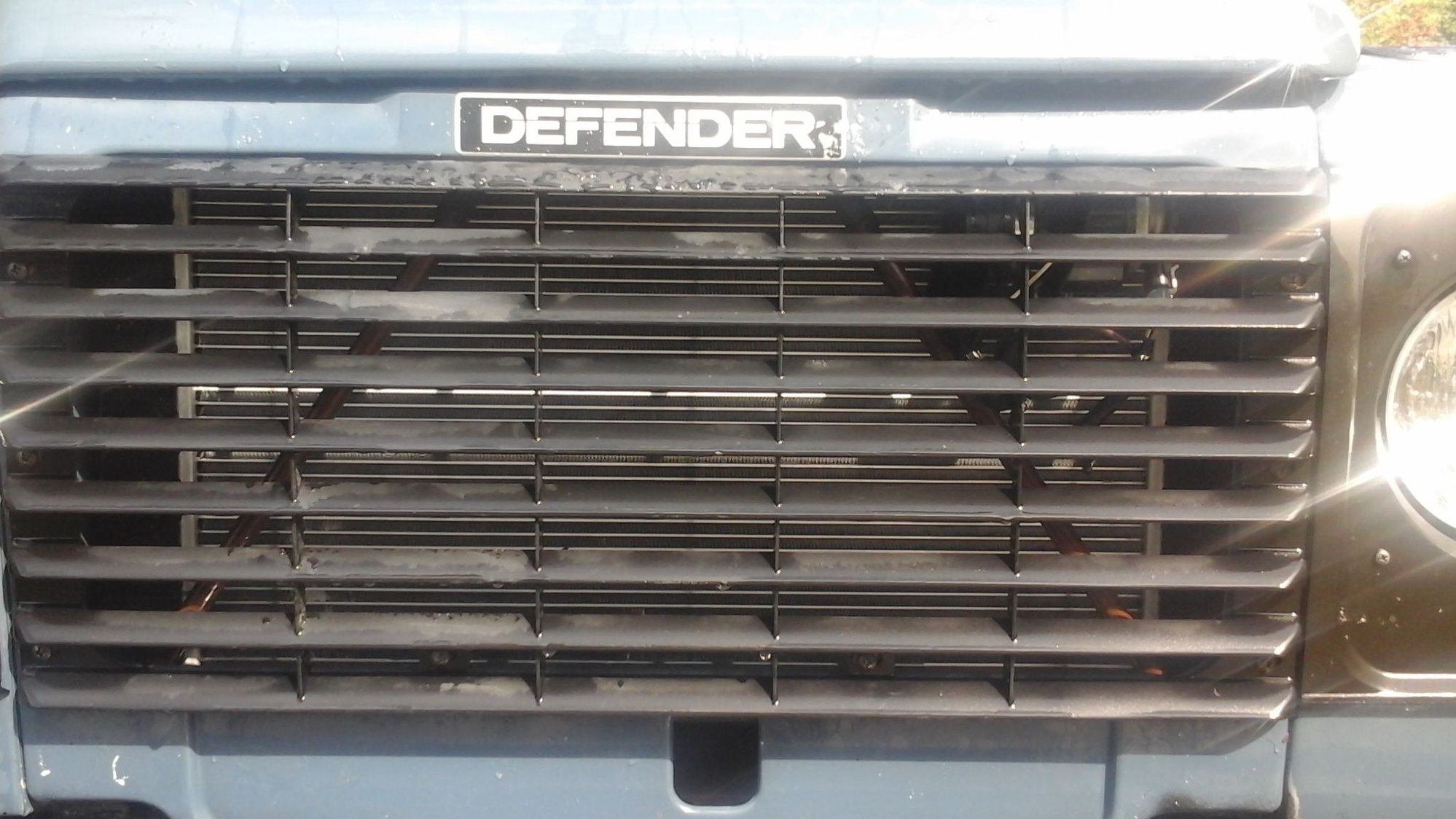

1) New radiator. I'd change ten of these and eat a pound of dog crap...before ever doing another Dll. So easy, everything made sense (engineering wise) and no issues. Perfect fit, thank you Rovers North.
2) Some fender armor. Easy install, thank you Lucky 8.

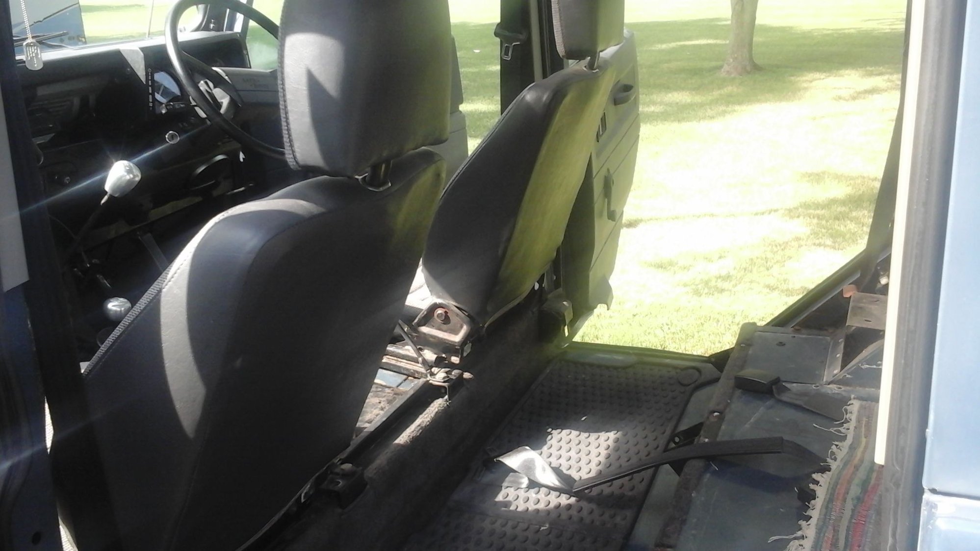

3) Removed rear seats. Will start fabing up a sleeping compartment soon.

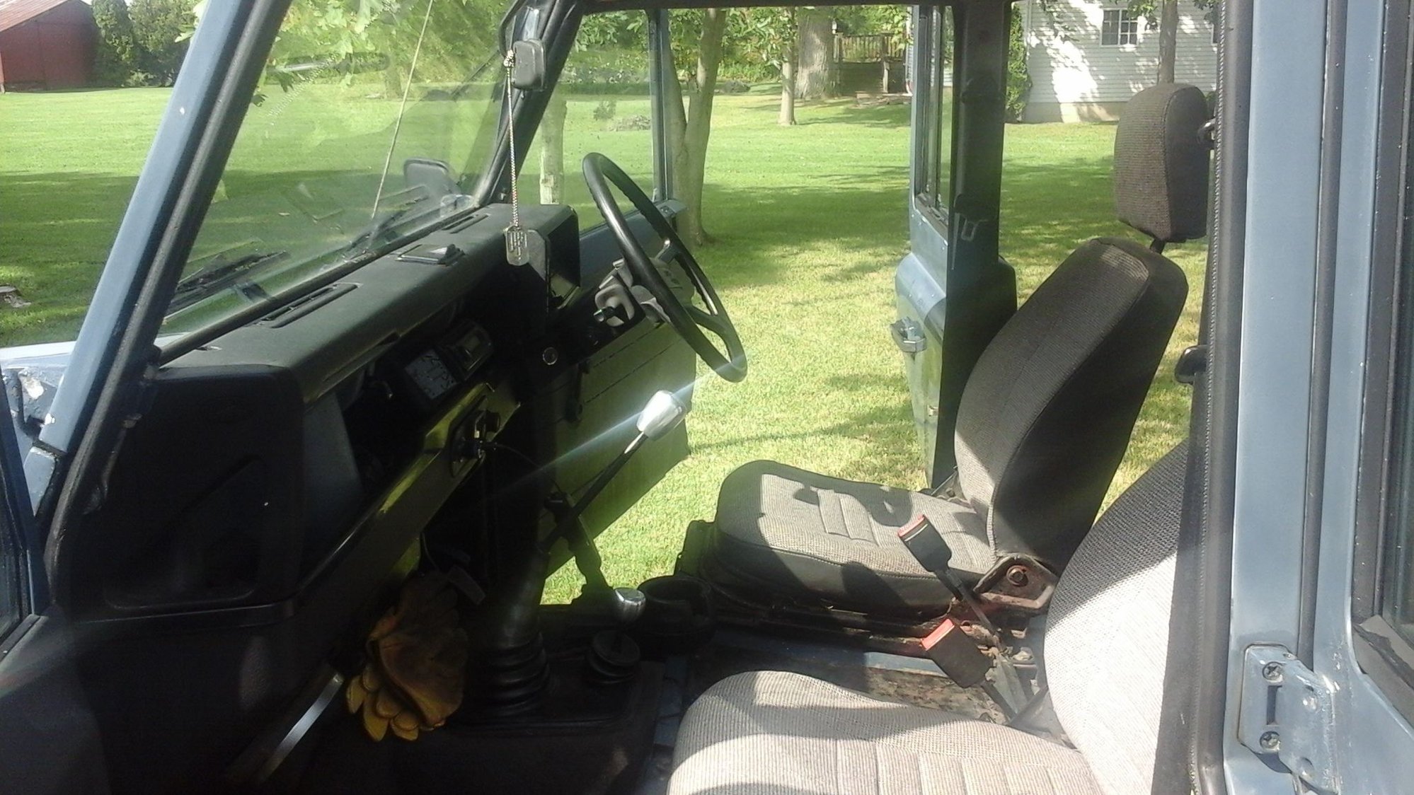

5) Removed center seat and added a Dll cup holder (drivers side). Will be removing both front seats, smell like a wet dog...so...some different seats are in order. Plus, some arm rests would be nice. Some black Dll seats would be nice.

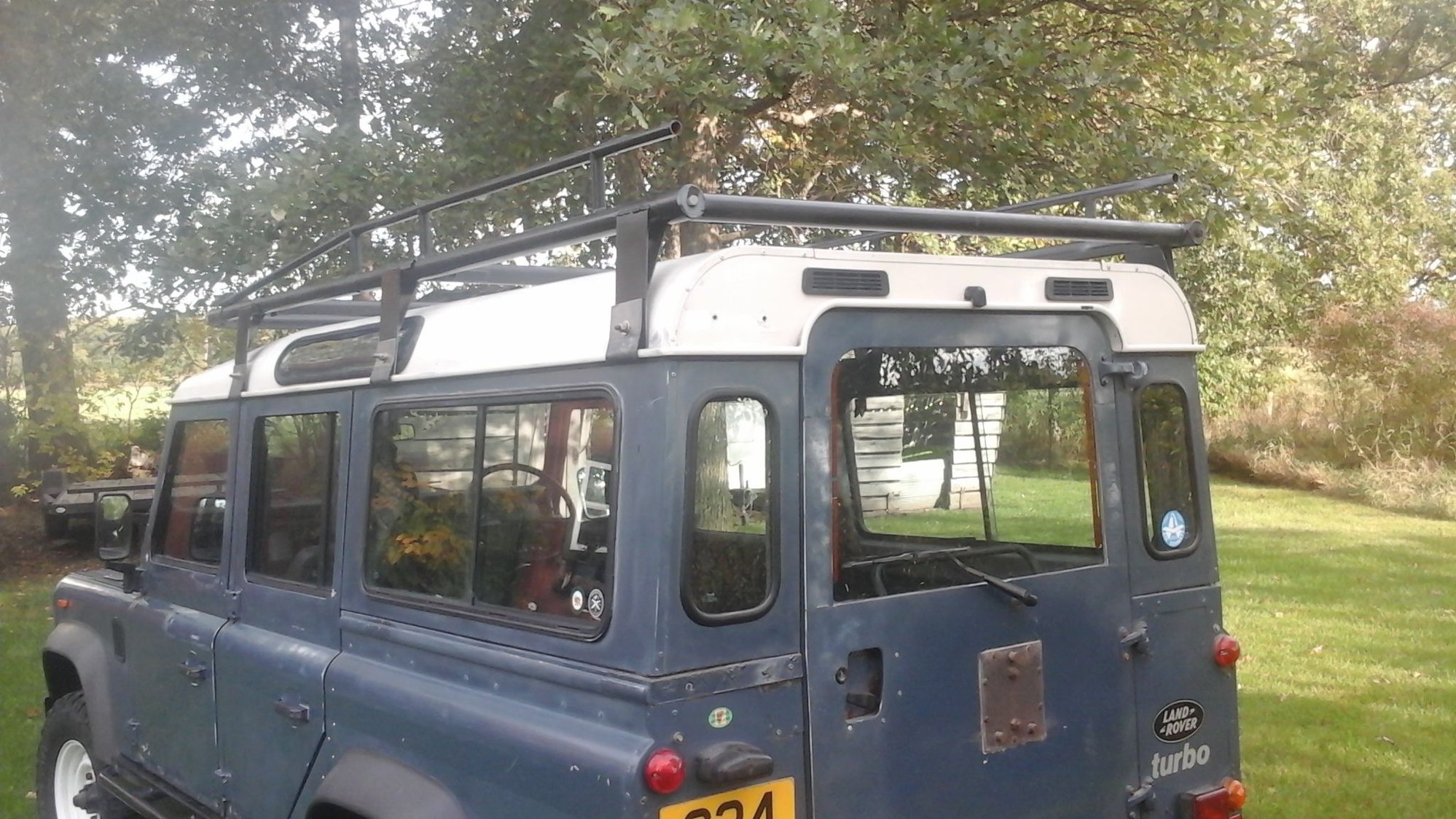

Started working on my rack. Lots more to be done but, at least it's on the roof now.
Ordered a snorkel froom Lucky 8, should be here in a day or so. Was fabing up one, then checked online to see what one costs...fabed one got s*it canned...lol. Sometimes, it just ain't worth the effort and time.
Thinking about adding spring spacers to the front, the downward slant is getting to me...plus...when l add the new bumper/brushguard...it will most likely get worse.
Brian.

It will drop probably.5 inch with the bumper and guard. Full inch when you add a winch
