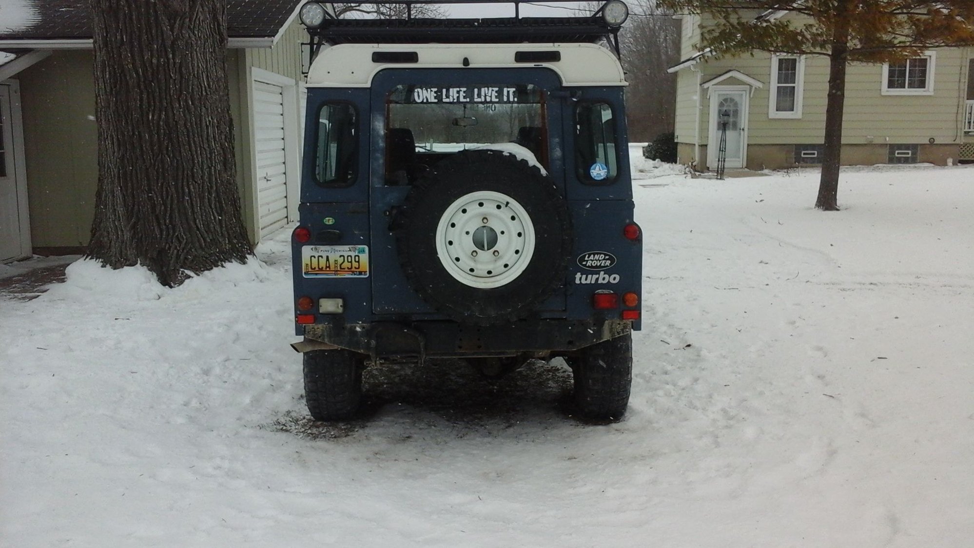

Posts: 4,867
Likes: 1,411
From: Michigan
The old girl looks so sad, while waiting for repairs. It's weird...as rough as it rides and as noisy, cold and uncomfortable it is inside...l miss her. Driving the Silverado is so, so not me anymore.
