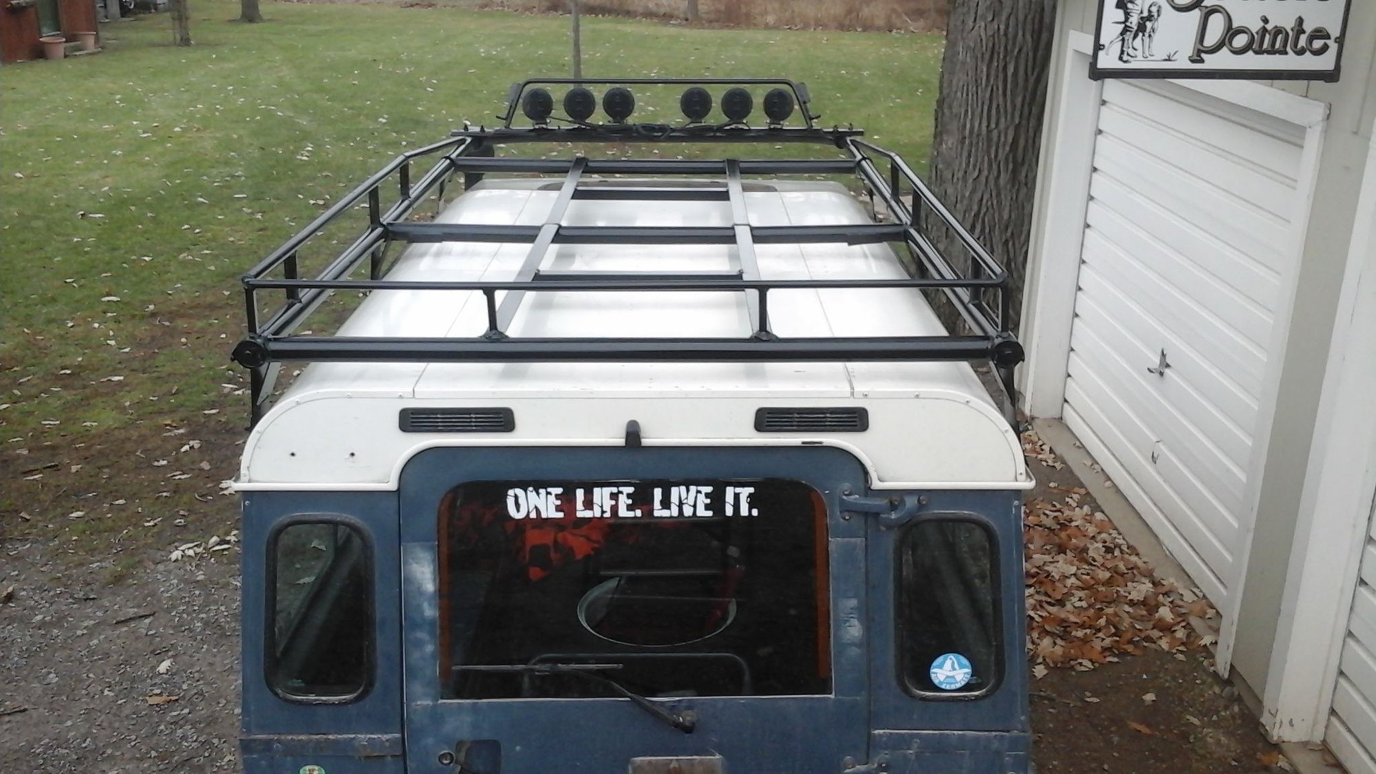

Worked on the rack structure, welded in a few more braces, ready for plastic chicken coup flooring panels.
Brian.

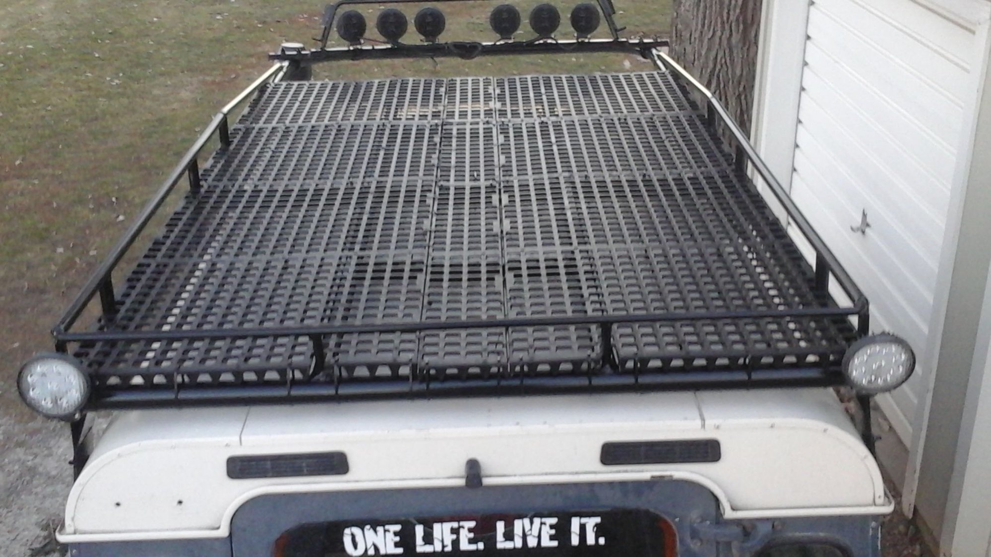

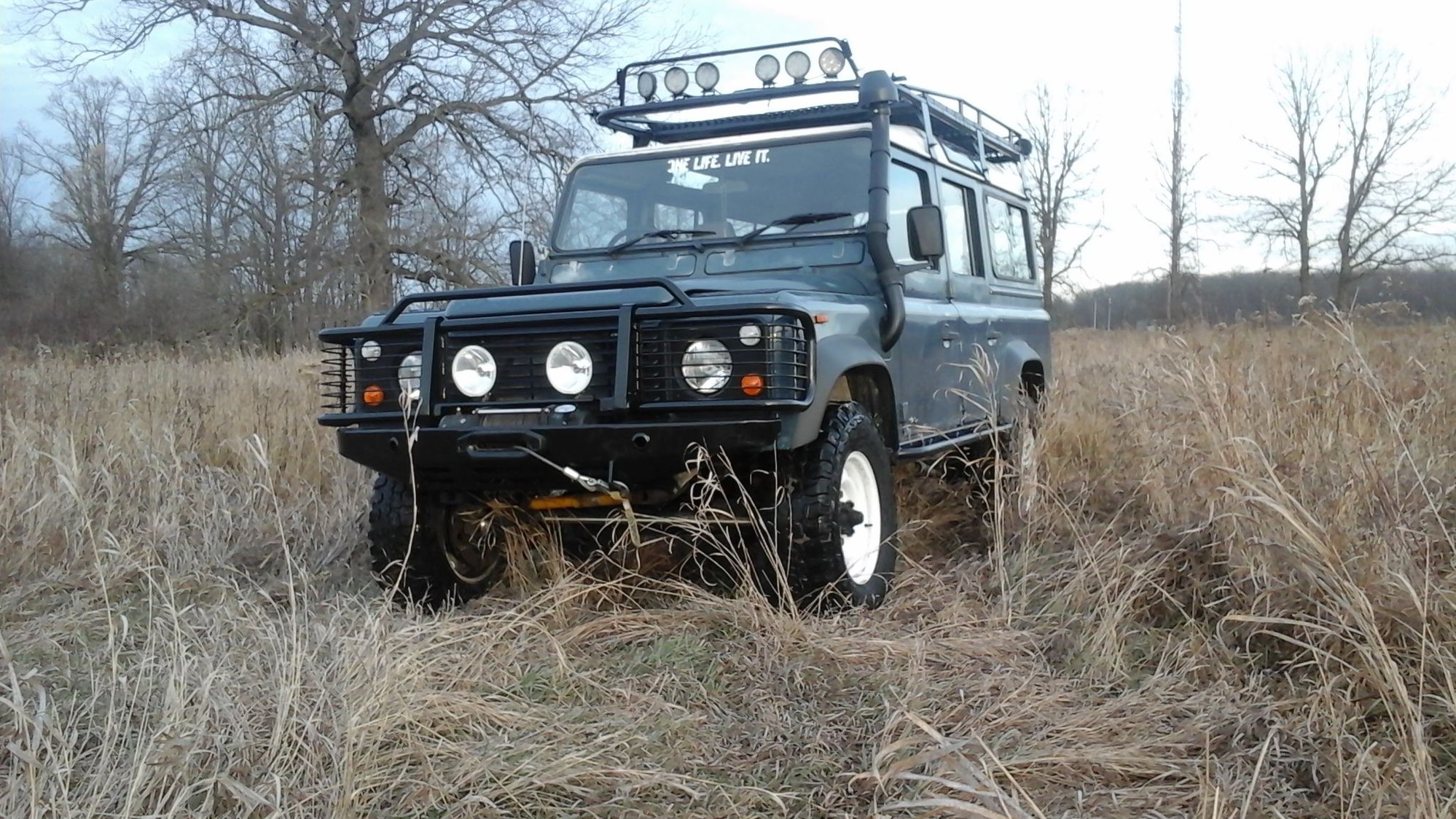

​​​​Added rack panels, bumper, brush guard, winch and lights. Lights and winch need wiring up.
Brian.
