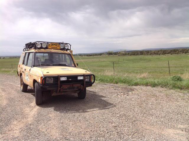

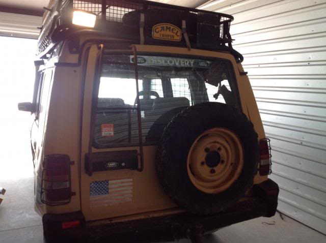

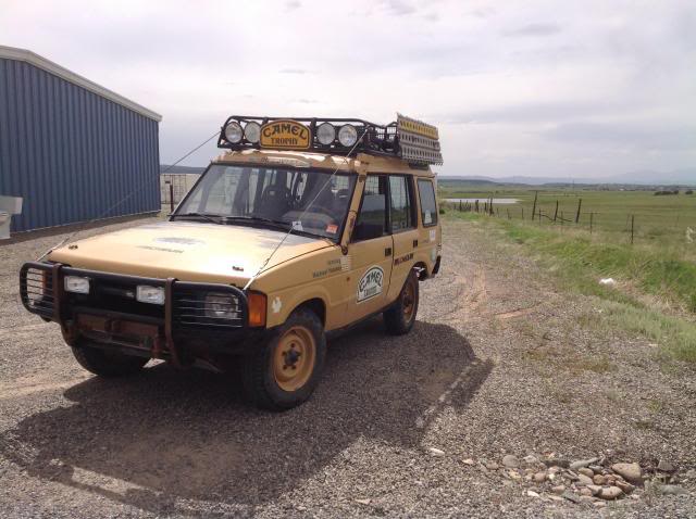

So, after a long battle today(basically.... wiring, wiring, wiring, plaques, and 2 h3 bulbs being dead) it is done! It looks more like a camel vehicle now! Please note the roof rack is bent a little, so the plaque is actually not slightly crooked.

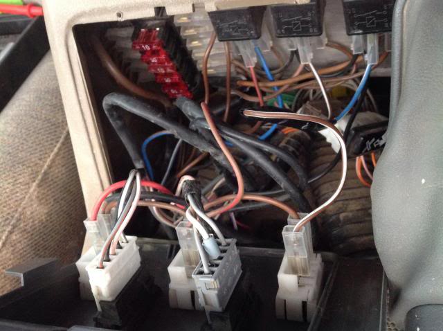

Basically, there are two power wires that go to the roof rack lights(hella 1000's). One wire splits 2 ways for each driving light, and the other wire splits 2 ways for each fog. One set of lights were working and the other were not. After some investigation, I found my way to the fault. It was in a nest of custom wiring and factory harnesses. Basically, someone had modified it at some point in time after the race. Each set of lights have a relay and someone rigged up the switch only to one relay, instead of two. A splice here and there. Bam. Lights.

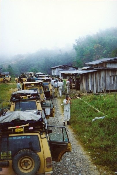

So a camel trophy owners club member sent me these photos. Thought I would share them! Verified my export plates to the camel trophy owners info about my disco!
Michael Hussey and Tim Hensley
