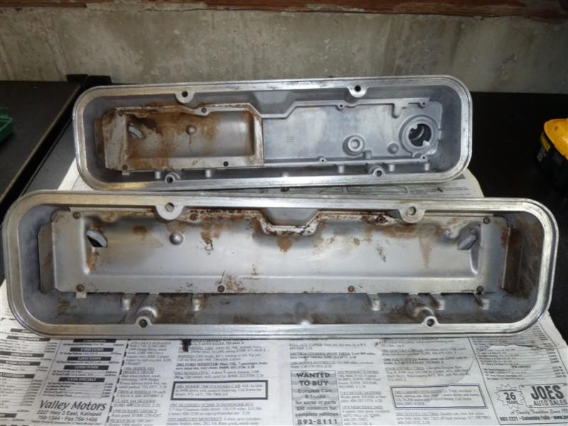

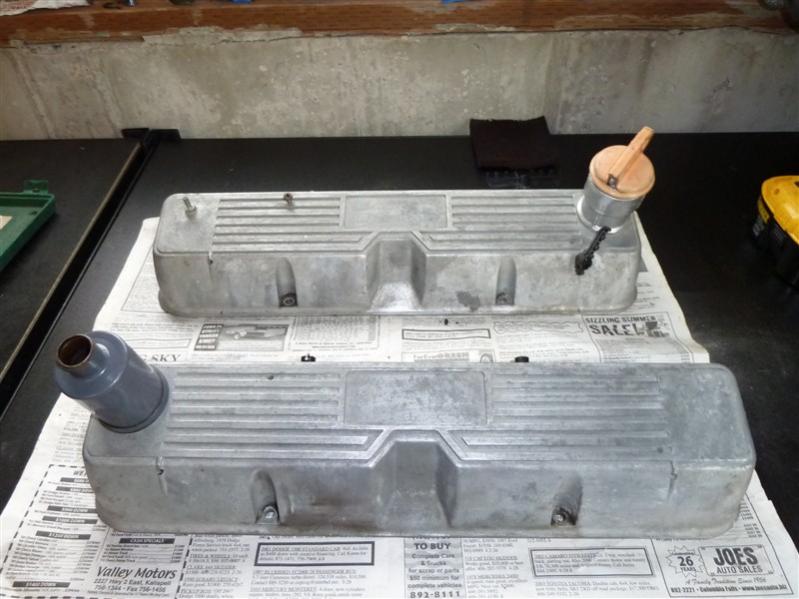

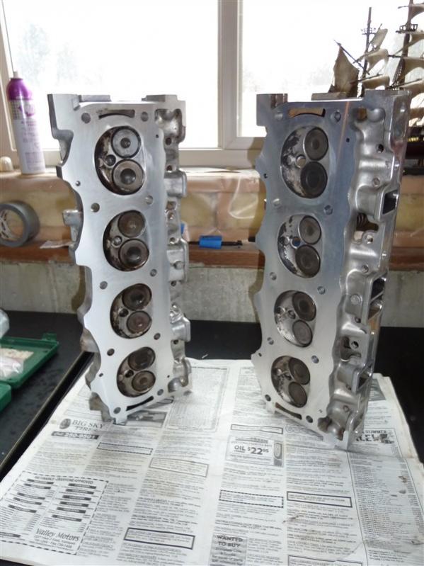

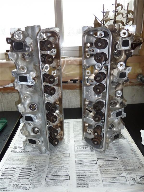

Old Nov 19, 2011 | 11:33 AM
  #59
hh65flyer's Avatar
Joined: Oct 2011
Posts: 326
From: Whitefsh, MT
Default New photos...
As promised, a few new photos for you to look over...

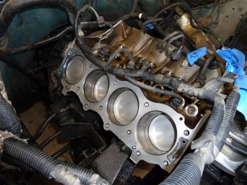

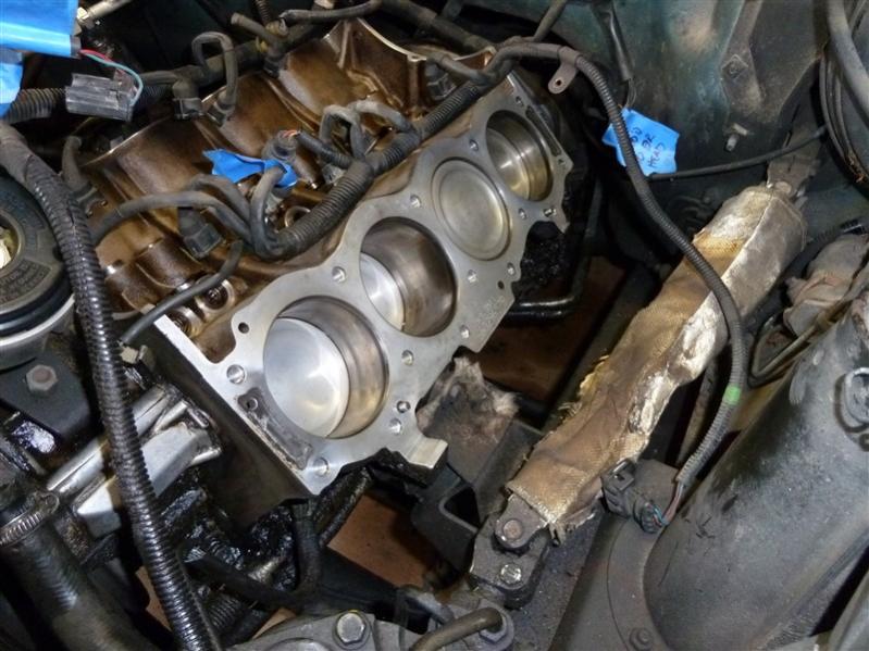

Old Nov 19, 2011 | 11:35 AM
  #60
hh65flyer's Avatar
Joined: Oct 2011
Posts: 326
From: Whitefsh, MT
I think this is where it all goes...hope I remember where everything belongs!
