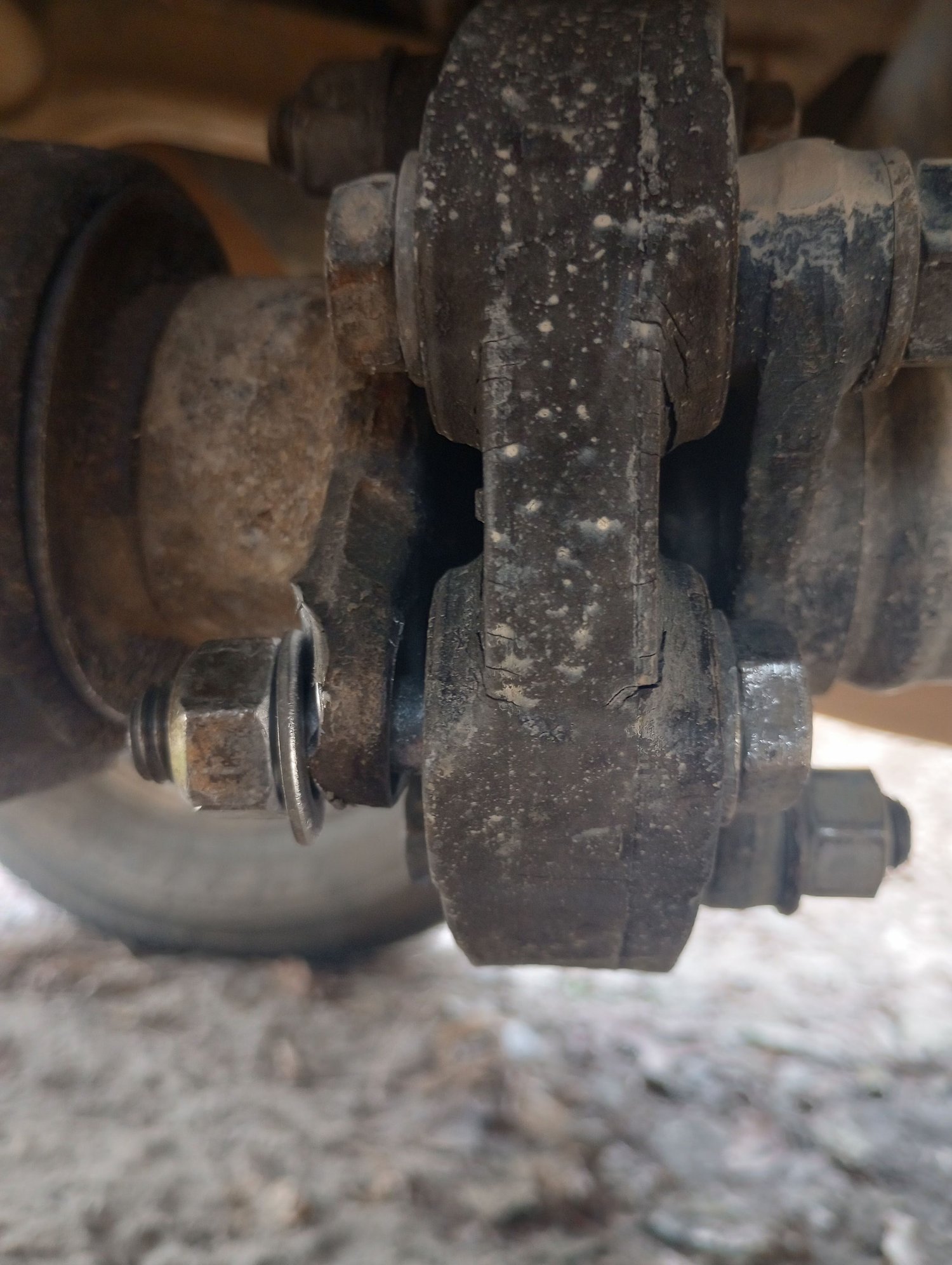

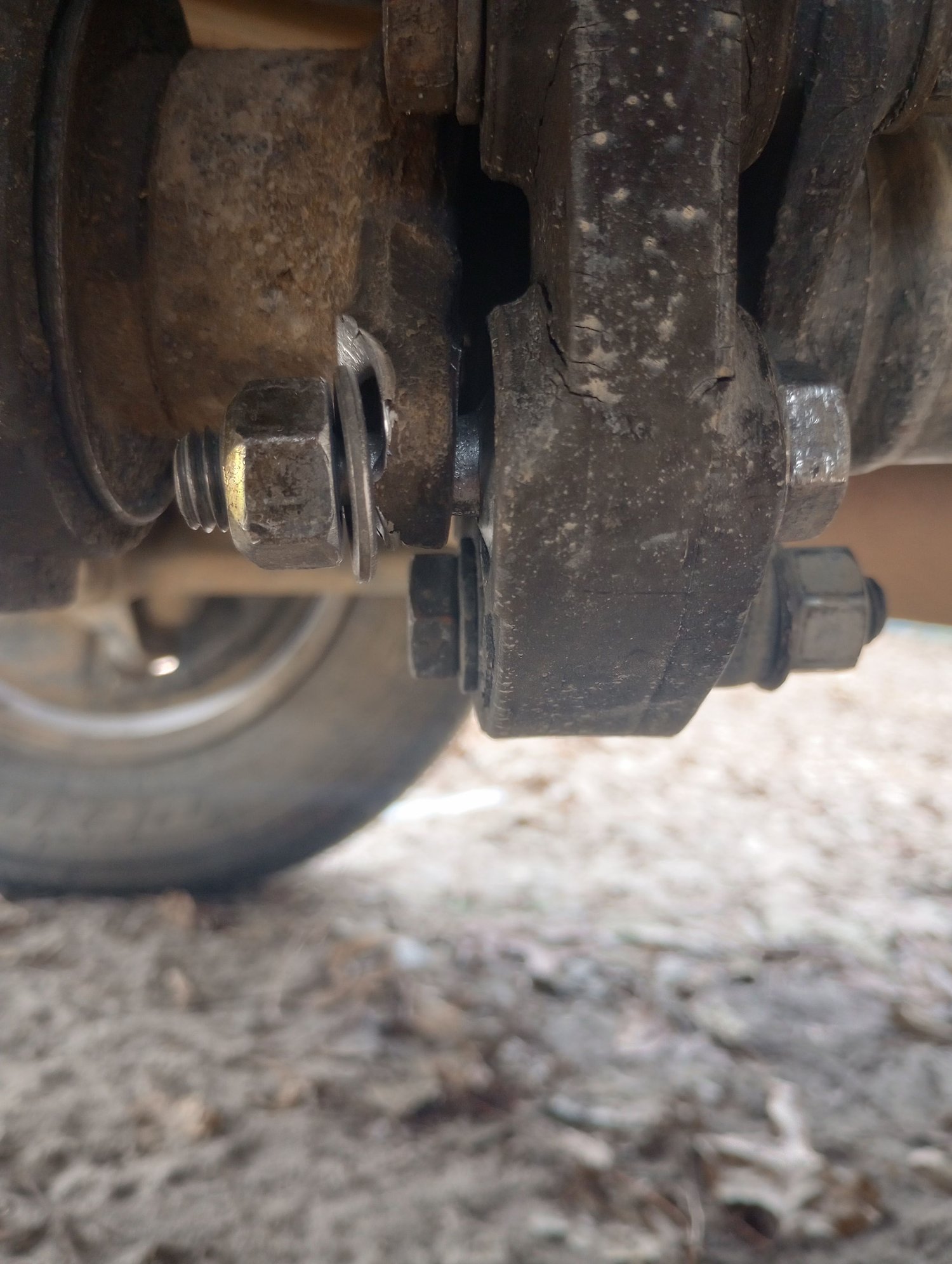

97 land Rover discovery driveshaft help I'm ony second driveshaft part and it's doing the same thing as my last driveshaft part and it's the flange differential part that keeps messing up and I don't know what to do with it and how to fix this problem please someone help me
Wtf
Doesn't make any sense why it keeps messing up

How could the flange be that worn and the washer look new. Makes no sense
