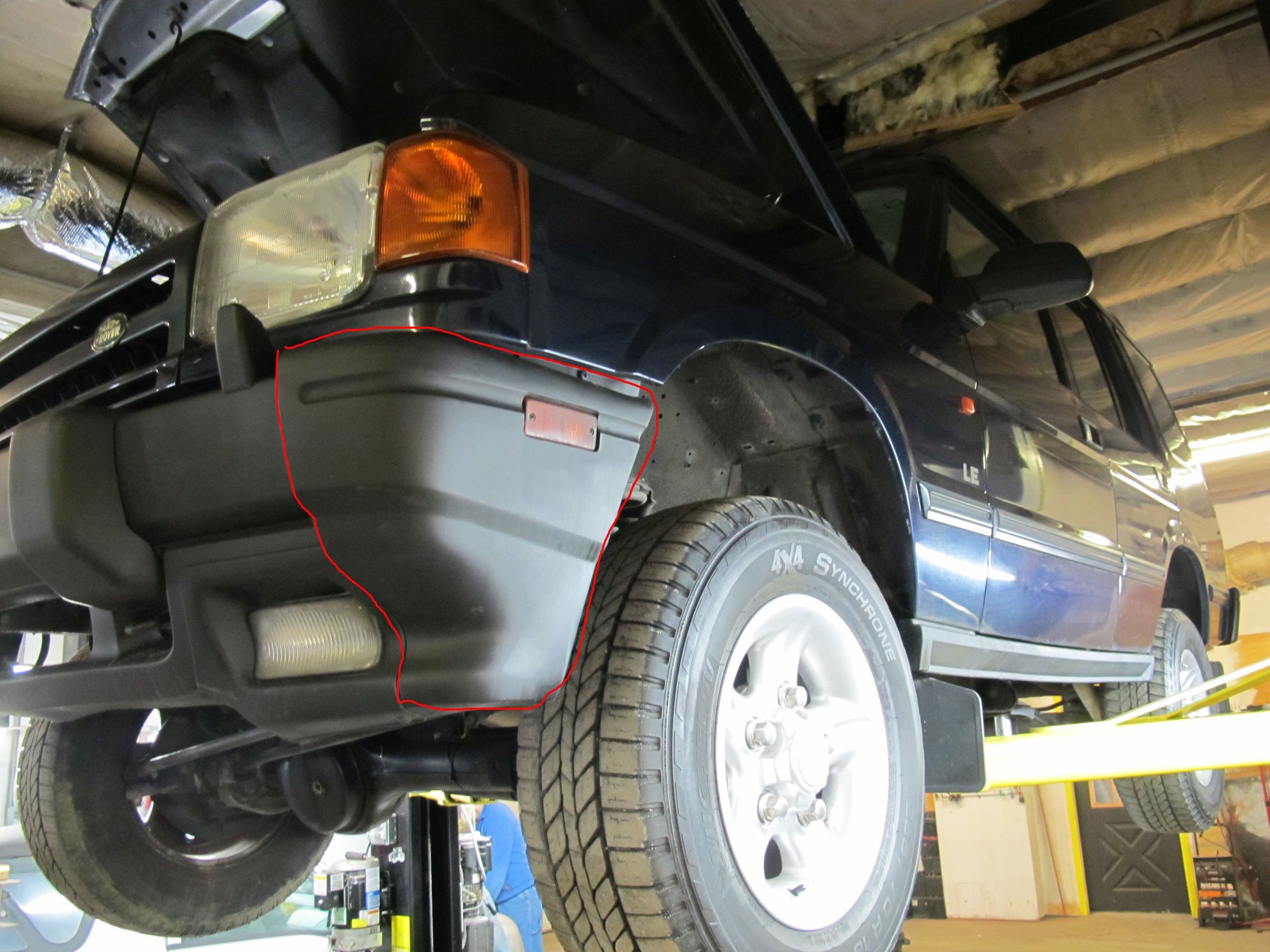

Can't tell you how helpful this is. In terms of adding the lower section of the bumper too, how would I go about finding that part name? Is this the correct part? Give me a few weeks and I'll be much less of a newb haha
https://www.roverparts.com/body-chas...ms/AWR1479PMD/
This is the end cap. There are two, one on each side. If you remove the lower spoiler you have to cut the end cap because it will hang down. When I removed my lower spoiler, I cut the end caps to be even across the front of the truck. It is an old Camel Trophy look that I like.
This is the lower spoiler. It is one piece and can have fog lights or not. If you are wanting to add this to yours, I suggest getting one without the lights since it will require a wiring harness and the actual fog lights.

Legend!! thanks so much for the pics and links
