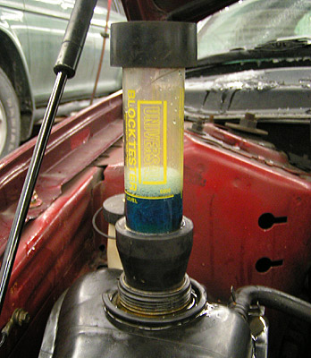

You loss of coolant over a short period, and overheating, indicates a serious problem.
1. The noise under the dash is bubbles in the coolant. Could be air, could be exhaust gas from a leaky head gasket. There is a chemical test (around $60) that you can buy that will atach to the coolant container and change color if exhaust gas, which is almost always head gaskets.

Attached Thumbnails 1997 Land Rover Discovery water boiling in reservoir/leaking, gurglingpassenger dash-block_test_fluid.jpg   1997 Land Rover Discovery water boiling in reservoir/leaking, gurglingpassenger dash-p1120320.jpg   1997 Land Rover Discovery water boiling in reservoir/leaking, gurglingpassenger dash-danger-line.jpg
