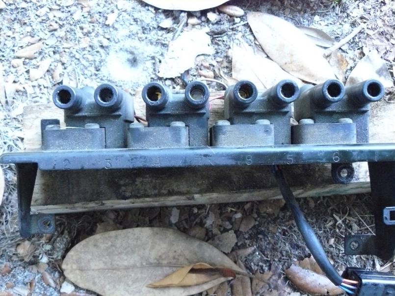

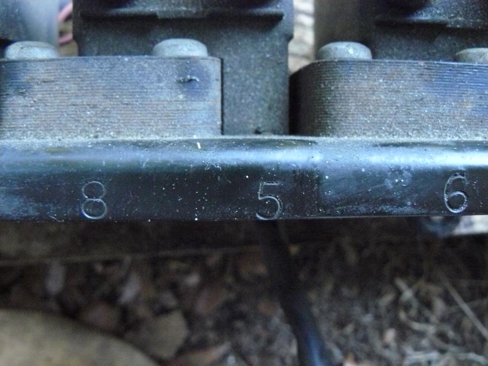

The proper cylinder numbers the wires go to is stamped into the coil pack bracket.
Old Jun 16, 2013 | 08:39 AM
Posts: 16,322
From: Savannah Georgia
If you can see them under the sludge and mud. Some white or yellow tire "crayon" can be rubbed in there, to fill the stamped letters if you like.
Attached Thumbnails 1999 disco 1 ignition wires-p1130079.jpg   1999 disco 1 ignition wires-p1130080.jpg
