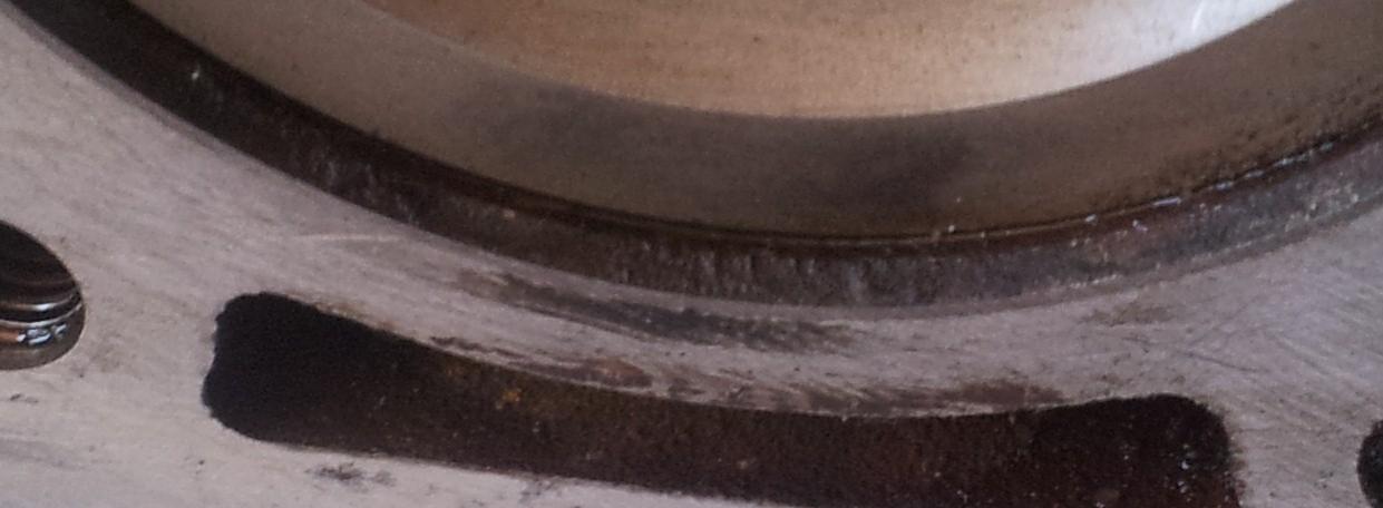

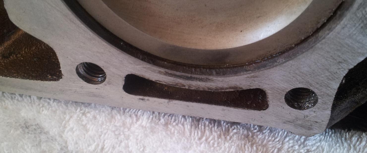

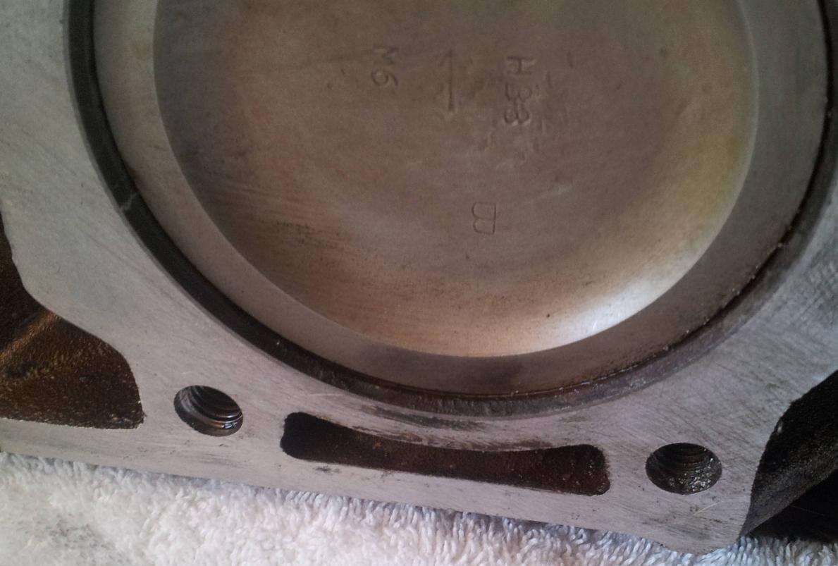

I have a chance to pick up a 4.6 motor from a D2 to upgrade my D1 4.0.
The guy is offer the heads and the short block(with pistons, rods, crank, bearings, etc.) for $375. Im worried that the block and pistons are damaged.

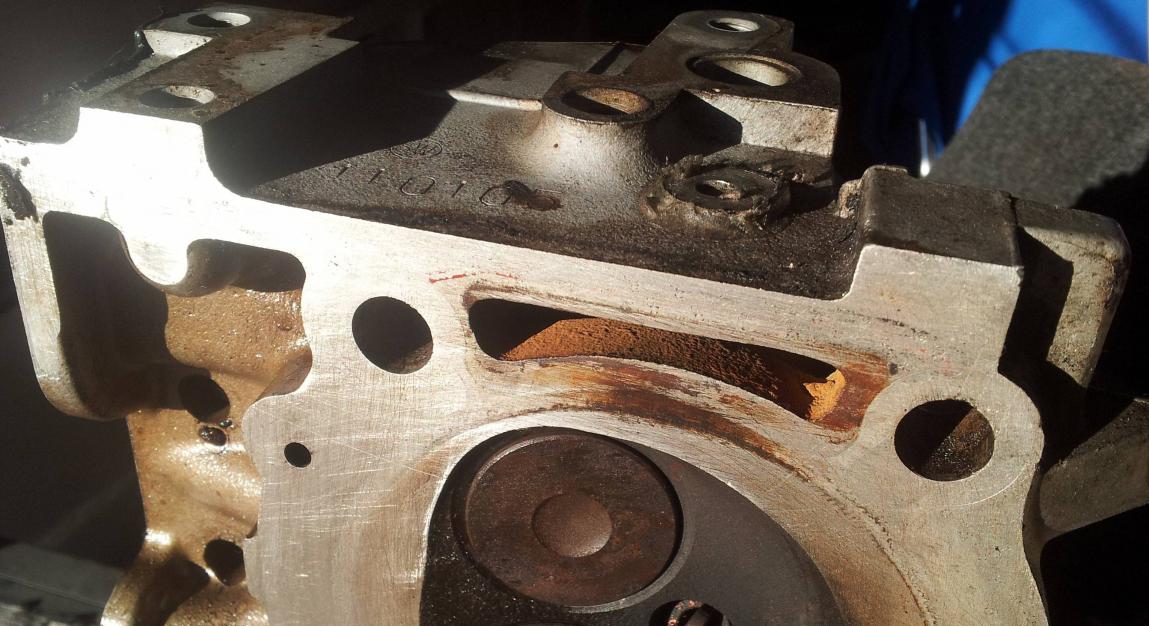

He sent me the attached photos, any one have any thoughts? Should I be worried about the discolored area? He says its not a problem and shows the picture of the head with the spot of discoloration that matches the spot on the block.
Should I buy it?
Thanks

Later rover v8 blocks suck.
I'd buy it and put the crank, rods, pistons, etc in your 4.0 block.

the price is right, my question would be why did he go to the bother of pulling it apart and cleaning it up and did not use it.

That's what I'm worried about. He said he got a good deal on a complete motor and ended up keeping the extra bits for back ups as it was cheaper not to replace the gaskets, head bolts, etc.

Does anyone see any problems in the photo? Should that dis colored mark worry me?

do what jafir said. the 4.6 blocks are time bombs.
