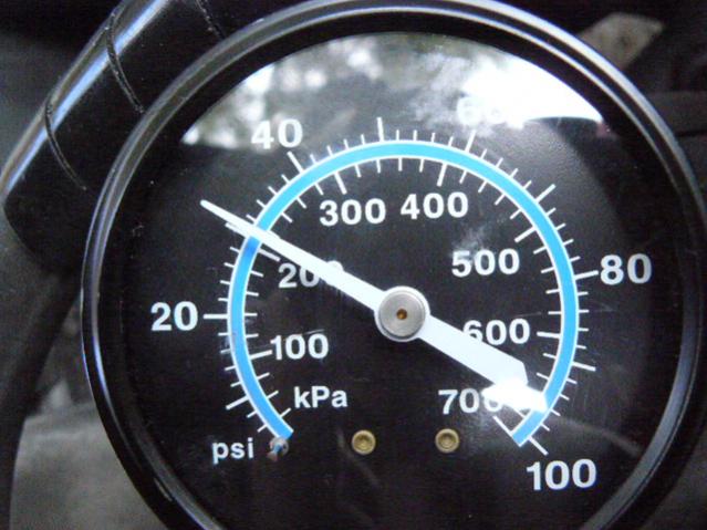

I think you nailed it with the twitching needle readings. Just for fun I did mine,:
Stone cold - overnight - "0" PSI
Turn key to make dash lights come on - fuel pump starts - PSI to 38 solid.
A few seconds later, multifunction relay goes clunk and pressure starts to drop, pump was shut down because of no crank.
Crank truck, cold idle around 1K, PSI 30 and steady, no fluctuation.
Let truck warm, shut down, pressure to 28 PSI.
Come back in 10 minutes, pressure at 30 PSI (fuel expansion)
Crank truck, again at 30, rev engine to 3000, pressure drops to maybe 26 PSI
The twitching needle could indicate one pump winding bad, so it stutters, and the effective volume will be less of course. At some point during the long overnight rest the pressure drops away on mine. This could be old age on mine, lack of service by the present and previous owners (I'm number 6 in a line of fools who fell for this rolling lump of coal teapot). I did replace fuel filter about 6 months ago.
Another thought - since the ECU deals with hot restart by increasing the pulse width to the injectors, to move the bubbles out of the system, you could see that on an oscilliscope connected to an injector wiring. A stone cold start you would see one pulse width, at "hot restart" it should be different. At least with the factory ECU program. What does your chip vendor say about how they handle hot restart in their program? The stumble certainly sounds like bubbles in the fuel.

The twitching needle could indicate one pump winding bad, so it stutters, and the effective volume will be less of course. At some point during the long overnight rest the pressure drops away on mine. (I'm number 6 in a line of fools who fell for this rolling lump of coal teapot)
With your readings you do not hold pressure overnight, I question this.
On your idle of 30 psi then rev to 3,000 with only 26 psi makes me wonder if your engine fuel demand is higher than the fuel pump volume output?
When I quick rev from idle the fuel pressure increases from 30 to 40 psi, this a fueling demand for heavy engine loading from the ECU to add more pressure.
With the vacuum line to regulator removed 39 psi rail pressure increase vs 30-31 psi.
I can see a new fuel pump in the future, plus an adjustable regulator as the 30 psi I read is already below the 33.99 to 38 psi minimum spec limits.
Why chance installing a replacement fixed regulator that might also read lower than spec limits? Covering my butt as $127 is the best regulator price found so far.
Fuel pumps I find $54, $64 to $89 plus different brands of manufacture.
I'll post a few photos once I have time and help, I promise.
