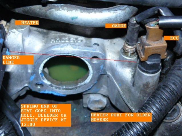

Rotella and upgrade to a 180F thermostat. Flush and replace coolant. If rad is 10F cooler bottom vs top, look for an indy shop that can rod out the radiator. Rad is copper/brass, $700 or so. Aluminum with plastic tank model is $235. Rod out may only be $75. Don't trust the heat gauge.

My temp guage gets anywhere over half way and I freak. Haven't seen half way on the guage since a rodding and 180* stat. Runs a cool 179-192 depending on external temp and speed
