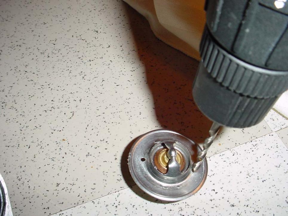

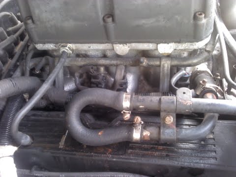

Result of correct belt route is that fan will suck paper towel to grille, rather than blow it away. Would think over temp electric fans would come on before 230. Sounds like coolant bleeding is needed also. When checking that radiator, read the top fins, then the bottom fins, hoping the two readings will be within 10F of each other. If radiator is clogged, the bottom rows block off first, and not as much coolant goes thru there. New thermostat could help. Try a 180F one with a hole (see pix) or jiggle device at the 12:00 position to pass some of this steam past it. You can also drive with no thermostat for testing, my D1 did maybe 150F with no stat. You can bypass the heater core like this picture, from a member in San Juan.
