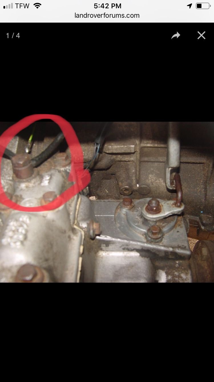

Where can I find the TC switch to check the switch? I removed the solenoid earlier. Is it the in front of the four bolt plate I removed for solenoid?

No, it's the one you have circled with a fake crayola......
